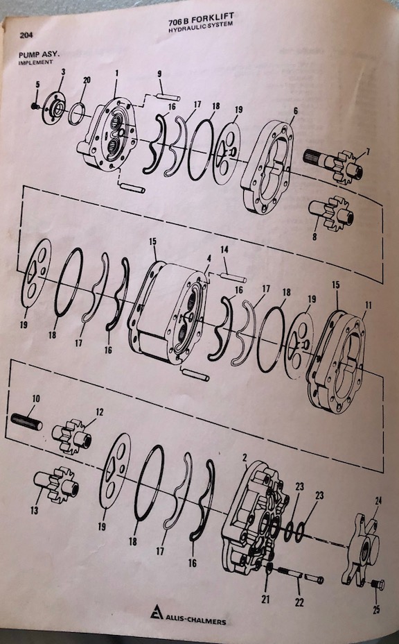

Hey everyone, does anyone make the seal kits and or pump parts for the 700 series machines still? Is their a replacement pump available? we had some water get into the system and it froze and busted one on the stage housings. any help would be great.

 Is this what your 700’s hydraulic pump looks like? Photo shows the hydraulic pump attached to a perkins diesel.

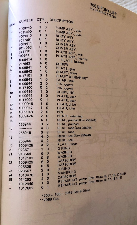

These other two photos show the June 1977 Allis-Chalmers parts book pages for the hydraulic pump per the 700, 706, 706B for both gasoline & diesel models. If your hydraulic pump assy is still original, then it should be part number 1009240. Refer to the footnote listed at the bottom of parts number page, you'll follow the single * column per 700.
