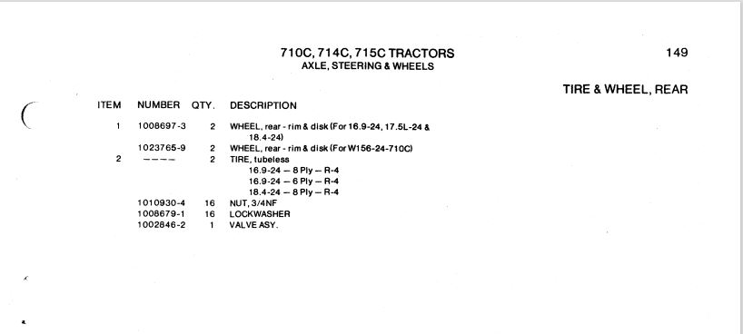

Several sizes could be correct.  Here is the page from the parts book showing the options.

18,4 x24 on my 715B - tubeless - put new Armstrong tires on mine but dang things have weather checked - tubeless valve stems started leaking also around seals - need to put tubes in them now
When I tried mounting the new tires could not get them to bead , had to take them back to dealer I bought them from and it took strap around tire along with 3 Chita air blast tanks working at same time as trying to fill them to get bead to pop up to hold air .

Ok I think I'll go with 18.4x24 thanks guys.
