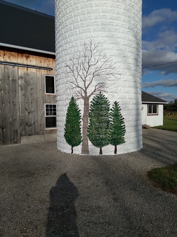

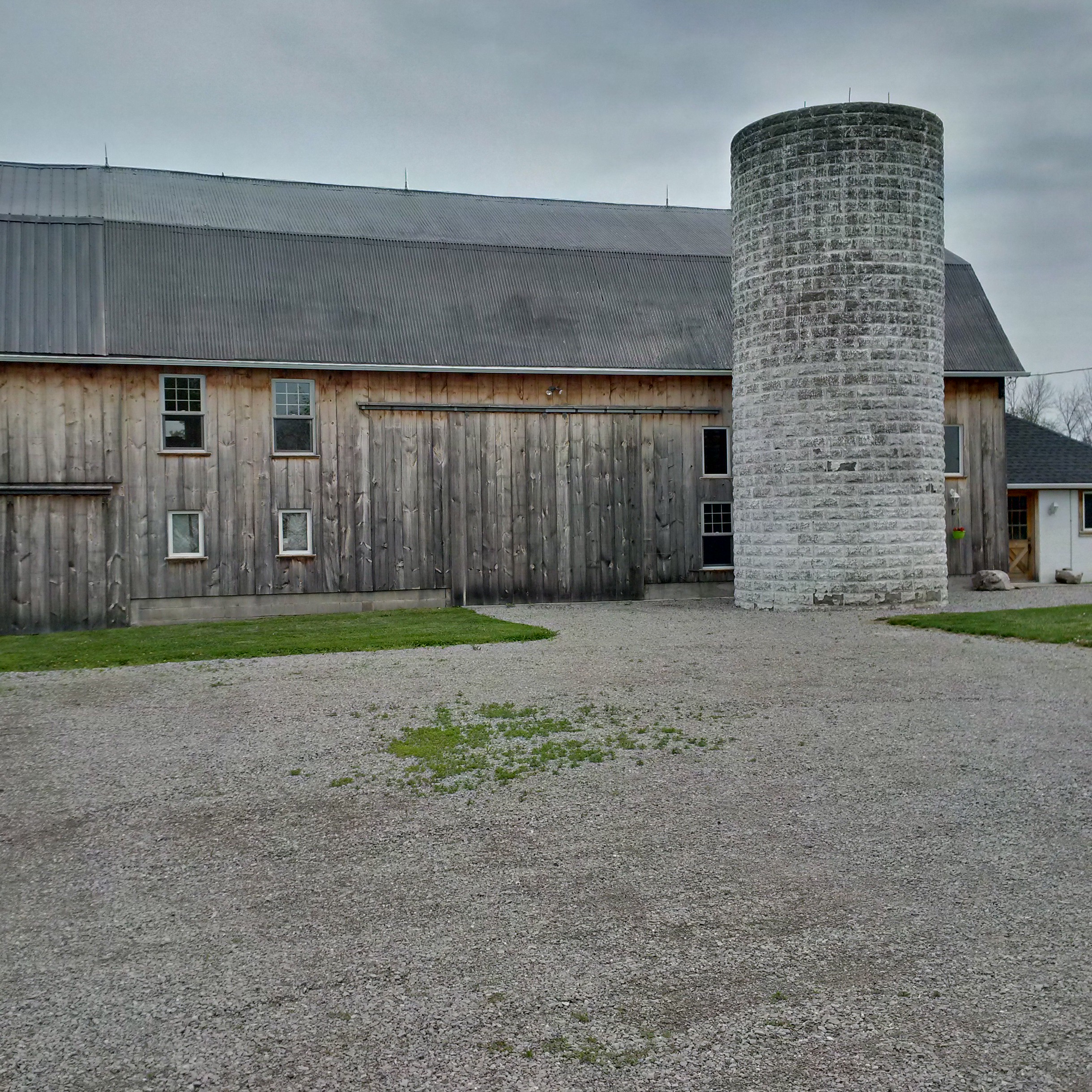

Hi All. I thought I would post a couple of photos of the 'reno' job I recently completed on my silo. My place was origionally part of a larger working farm. Most of the land was divided and sold in the past, and I have the origional farmstead and 25 acres that I operate as a hobby farm. The silo is pretty neat but needed some work.
It was origionally built in the early 1950s by a man named Harold who owned the place at that time. It is built out of hand formed concrete blocks. Harold's son Alan is a friend of mine and according to him, Harold bought a form, and over two years, hand mixed concrete and made blocks throughout the winters. During the summers, he built the silo.

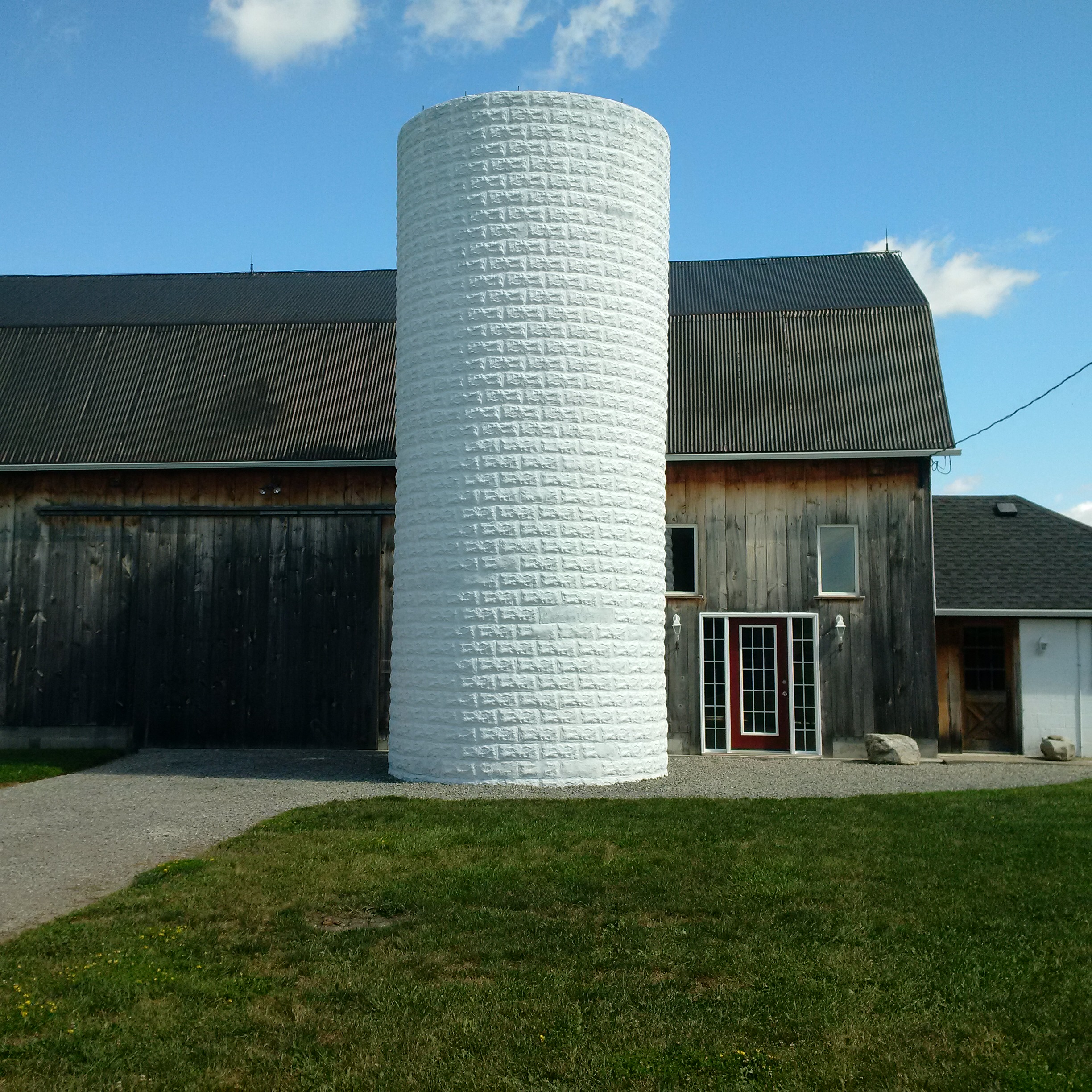

It is about 13 feet in diameter and is about 28 feet tall.  There are 42 courses of 22 8"X8"X20" blocks, all hand mixed and hand poured. In total, there are 924 blocks.
Some of the mortar was falling out and the surface of some of the blocks was flaking away. I patched up all of the concrete with mortar and with parging compound, spray painted it with one coat of primer and one coat of exterior latex paint. My daughter did the artwork.
I am not aftaid of a bit of work, but I cannot imagine that anyone would ever tackle a job like that today. It is about 70 years old now, and I hope it stands for 70 more.

Thanks for sharing and restoring that silo. Nice barn too. Noticed that the blocks are textured on the outside. I suppose hidden somewhere in the blocks are some steel bands to hold the outward pressure of the sileage. Do you know if there is any interlocking feature about the blocks or are the sides all flat? As said above, I wonder how many young folds today would start and finish a project like that. Compliments to the artist too.

Looks great. A lot of work there in the original build and the restoration. Wonder if there is any reinforcement there? Kind of hard to do with block.

Regarding the blocks, I believe the form used must have been something that was commercially available at the time. Probably steel or aluminum I expect. There are grooves formed in the blocks so they kind of interlock. They are also curved to follow the radius of the silo and textured on the outside. When I repaired some mortar joints, I could see some heavy steel wire in places. Between the wire and the interlocking feature in the design of the blocks, that has been enough to resist the pressure.
Regarding the height, it is 28 feet and I did the restoration and painting from ladders. There is only about three feet between the silo and the barn, so I couldn't really get around it with scaffold. I have quite a bit of experience with heights and ladders, but of course, you always have to be careful. Gravity never takes a day off. I used a 32 foot aluminum extension ladder for the top. I also have a 40 footer that I have used on the barn.
My daughter is the artist. I can barely draw a straight line. I have seen pictures of some beautiful silo art. I doubt if we can ever match some of them, but we may add more in the future. I have a small tree farm and we have cut your own tree sales at Christmas. We got a lot of compliments this year from customers who liked the silo and the artwork. We don't use it for anything really, except for a conversation piece.
