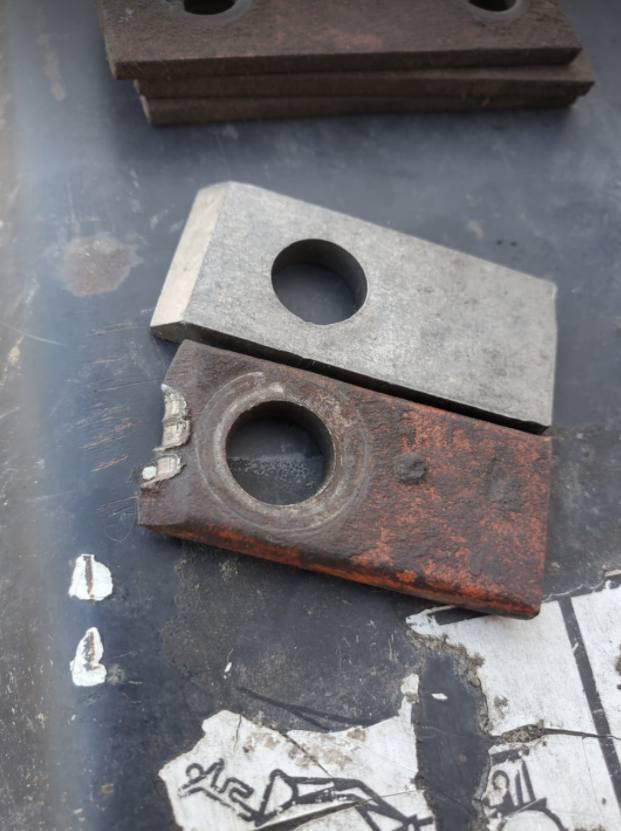

So I recently ordered some parts in to fix my fuel gauge (fuel sending unit) and parking brake. I also ordered some sediment bowl filters and gaskets. Both sediment bowls had a fair bit of sludge - one about 1/2" and the other a full inch. Gaskets were shot by the time I got them out, although there weren't any leaks previously.
The parts finally came in today! So I went on out to the beastie and got everything swapped out. I now have a functional parking brake and fuel gauge! I also found a couple of worn wires for my lights yesterday, so those are 100% fixed.
Overall I am very pleased with how the day went! Everything was successful and no big issues arose. I had to change how my fuel sending unit connected, as the electrical connection was not the same.. But a couple minutes snipping and crimping wires fixed that!
3x Parking Brake Ratchet (70235328)
1x Parking Brake Pawl (70235329)
