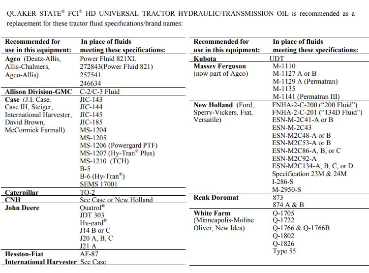

wasnt the story that the original 303 was based on Whale Oil  ???   And 303 does not really meet much of any "hydraulic oil specs".... it is just "oil"...
Points: 88468
Post Options Post Options   Thanks (0) Thanks(0)   Quote steve(ill) Quote  Post ReplyReply Direct Link To This Post Posted: 23 Jan 2021 at 9:56pm
The truth about 303 oil
In the 1960’s, John Deere created the 303 oil that was used as an effective, high quality tractor hydraulic fluid for anti-wear on some heavy duty equipment. However, in the 1970’s the popular John Deere product was regulated and banned due a key ingredient being sperm whale oil. Because the whales are an endangered species and the sperm whale oil was outlawed, John Deere reformulated their oils and eliminated 303.
Some distributors and retailers are allegedly using the 303 marketing when some of the oils may be damaging to vehicles and allegedly don’t meet manufacturing standards.
again, the MORAL TO THE STORY, is READ THE SPEC ON back of THE JUG !
