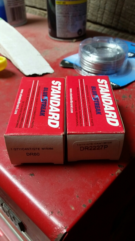

For cap,rotor,points,and condensor I  recommend echlin from napa or standard blue streak.Anything else seems to be a waste of time and money.For plugs autolite 295 or NOS AC 45s.Echlin #s cap rr145 , rotor rr301, points cs763, condensor rr174  This assuming your WD has a distributor ign system.I would stay away from the sparex tune up kits napa sells as they are china junk.  Blue streak #s
