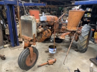

Post Options Post Options   Thanks (0) Thanks(0)   Quote Richardmo Quote  Post ReplyReply Direct Link To This Post Posted: 20 Dec 2020 at 8:34am
Steiner has the material to replace the mesh inside.
I use gas on the air breather for this Allis C.
Only issue it will take some of the paint off if not careful.
Edited by Richardmo - 20 Dec 2020 at 8:34am
