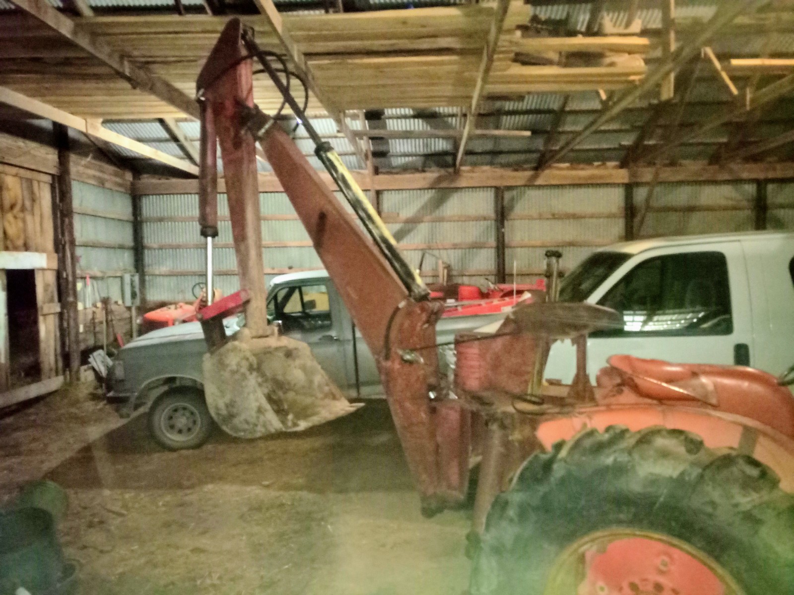

My 1958 D14 industrial has the shuttle on the right-hand side.   Does anyone know if I can move it to the left-hand side and if so how to do that?  I have only ever seen them on the left-hand side.

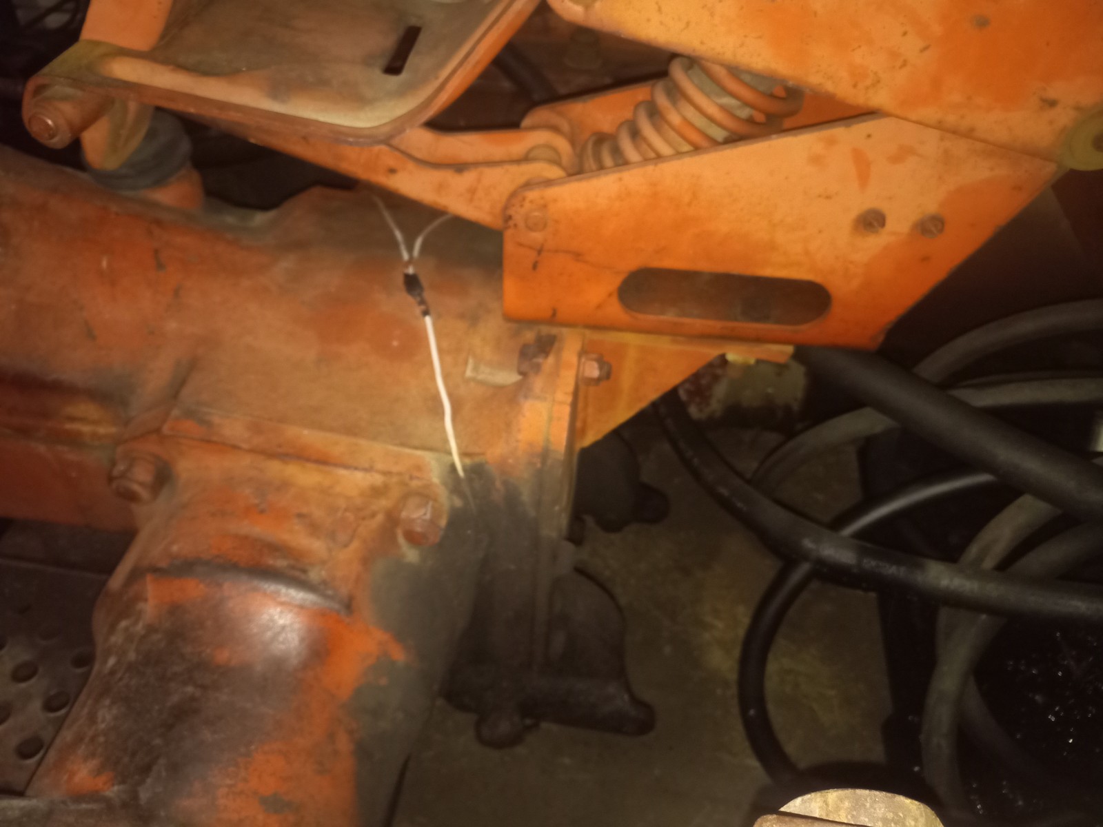

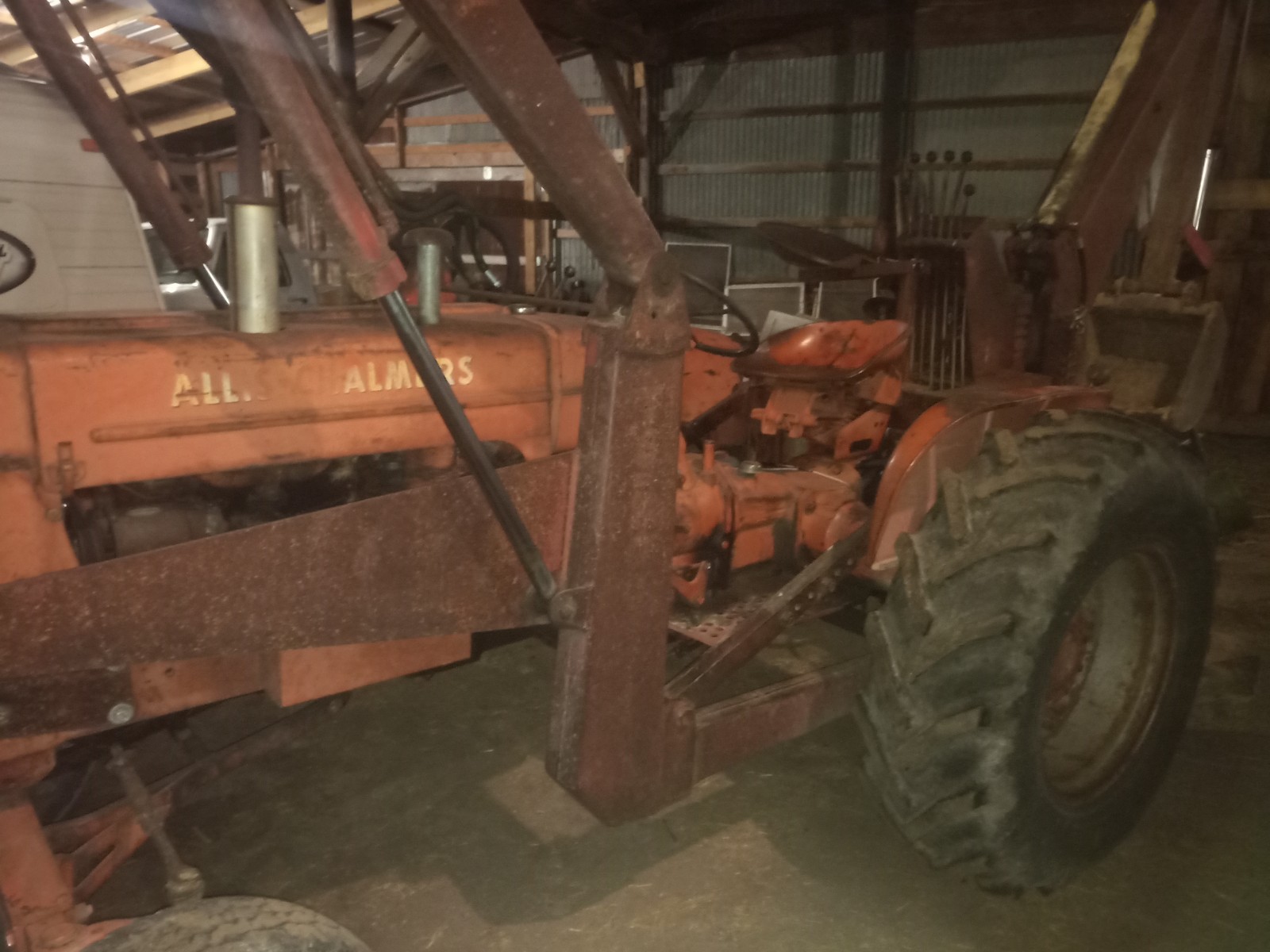

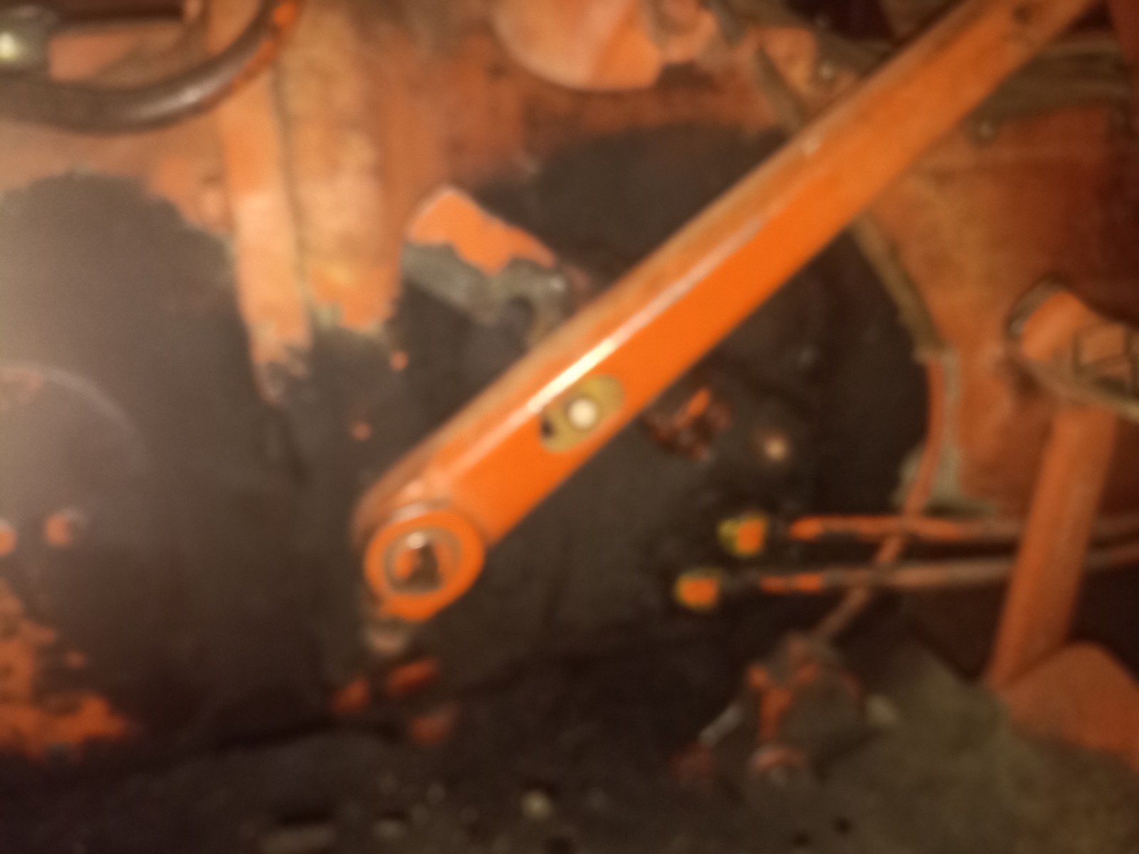

Thank you for your reply.  Yes, I'm sure it is a shuttle, not a high-low lever/power director, and it operates as it should.  It's definitely an Industrial D14 (SN# D14 17785) because there is no PTO or internal hydraulics, and it has the reinforced heavy-duty front end.  See attached pictures.

The shuttle is on the right, it is the same handle that the rest of my AC's have for power directory on the right.

I might be wrong, but I think someone might have stuffed a shuttle into a regular PD housing. IIRR, all you have to do is to flip the shaft over to change lever locations. If I'm wrong, someone will be along to correct me...Wink
