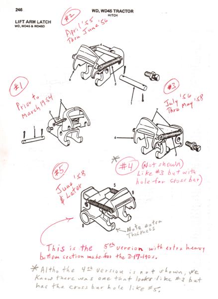

Any instructions out there to replace the springs, rivets, bolts, etc on the Snap Coupler latches?
Bought the kit for the sons D19 latches and we used the bolts but I need to attach springs to my CA latches and not sure if I’m supposed to cut off the washers, attach the spring ends then put on washers and hammer the rivets out to keep the washers on or purchase a latch repair kit and guess what parts to use out of it?
A related question is anyone have the picture of the different Snap Coupler latches through the years and what they fit?
Don in Thompson IA

Found the picture but I do not remember the writing on it.

I did some repairs on my latches - WD45. They are like #1 in the diagrams above. I replaced the springs and washers and saved everything else. Did just a bit of grinding and the forced off the washers. Then cleaned up the pin ends just enough to fit the new washers. Filed a bit and peened a bit with small hammer. Once I got the washers to fit I installed new springs, installed the new washers and repeened. Worked great. Fairly time consuming but result was good. By the way the diagrams are great. Mine is 1954 model and matches the diagram. I know they are original latches.

Great chart to have!
What version was used between April 1954 and March 1955?

I think that #1 carried thru till the second one came out. My WD45 is mid year 1954 and it has the #1 version. My serial is 175421 so pretty much middle of serial numbers for that year. Just guessing tho.

So my snap coupler must've been added to my '53 WD much later, as this looks like the "June 1958 and later" 5th variant latches?

Some one probably just went to dealer and purchased new latches. Old ones maybe worn or damaged.

Dad bought set late 60s from dealer for newly acquired sc plow. Are what was current for D19. Unless there was nos laying around you got the latest version.
