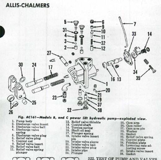

On my 1955 Allis B's hydraulic pump there are three hex bolts on the top of the pump. There is oil seeping out of one or more of them. I am not sure if trying to tightening them will do any damage or throw off any adjustment. I did not want to open a can of worms, by messing with something that I am not 100% clear about.

The 2 near the where the pump mounts are 9/16" X 18 thd, and seal with the copper gasket.  These are over the discharge valves.  The 3rd near the control is 1/4" npt it is over the relief valve.  Use a wrap of teflon tape on these threads careful to not get any over the end of plug.  Do not over tighten the pipe plug.  No problem to remove any of these with the engine off and lift down.  Tim

The two with BOLT HEADS ( item 5) have a copper washer under them item 31) .. As TIM said.... You can get new washers at NAPA... or you can heat them up with a propane torch, let them cool and they should be soft to use again... the other one is a pipe plug-- thread tape.
