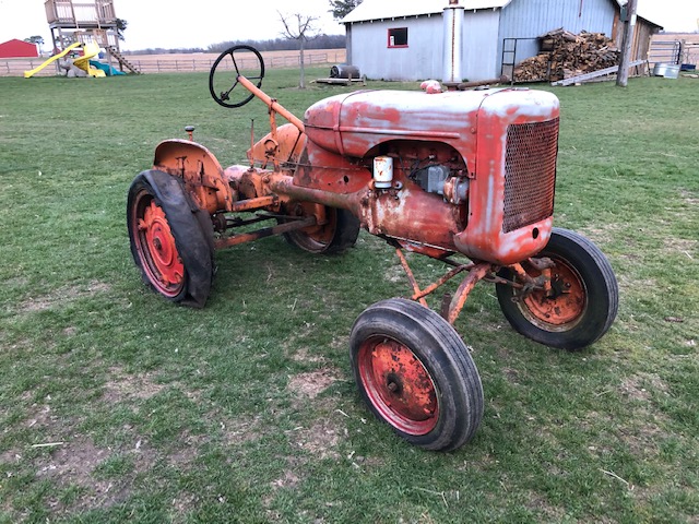

If you are needing the front rim locks for the cast hubs on a 38' B I have spares. I have three 1938 B's, and parted out two already as well.
The 38' cast hub B is a 1 year only design and I have not found any other model with the same parts.

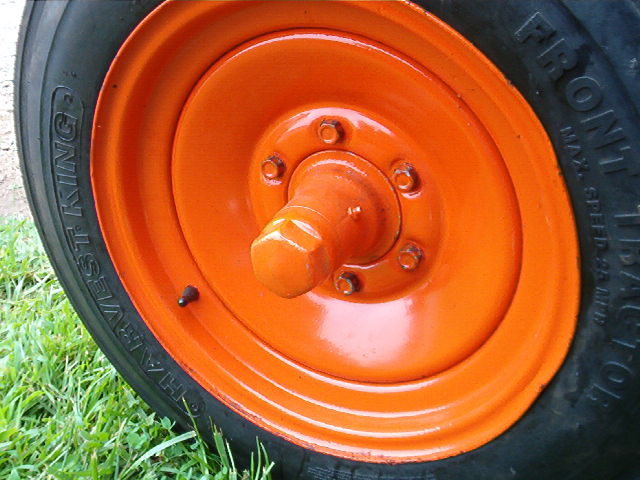

above is the 1938 wedge rim... below is the 6 bolt 1937 Wauk rim

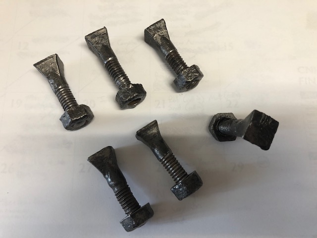

Thank you for posting this picture. On another website someone had a bunch of new old stock bolts and nuts. No numbers or anything on them. They came in a bunch of stuff from a sale. No one knew what they were for. Now I can't find the post.
