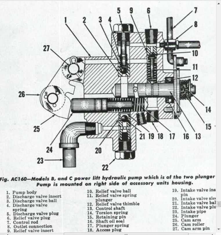

Are parts available for B hydraulic pump, needing discharge valves 70213522?

Tim, i have had good luck polishing down the outside of the spool ( valve) and touching up the inside seat with a drill bit... or setting the ball bearing inside and smacking it with a hammer to form / makeup the seat.... I have got new balls at the hardware store.. Never had to replace the spool ( valve)....... is yours damaged beyond use ?

steve(ill), I replaced the balls with new from hardware store and have used a piece of brass rod and hammer to hit ball but, still leaks.  I made a stand to test pump and when I pump 1 piston the other one moves out, leading me to think the discharge valves are leaking.. Tim

I have used a drill bit and VERY GENTLY lap the surface where the ball sets... But you may be past that point.

steve, Is the valve seat hardened?  Was thinking of epoxy a ball on end of wood dowel and lap seat using some valve grinding compound.   Hmmmm, might cut off threads on bolt and counter bore to fit ball and locktight ball in bolt, and use it to lap seat.....Thanks, Tim

the seat must not be SUPER hard since the book tells you to SMACK the ball and dent the seat to fit it...i think your plan for lapping is a good one.
