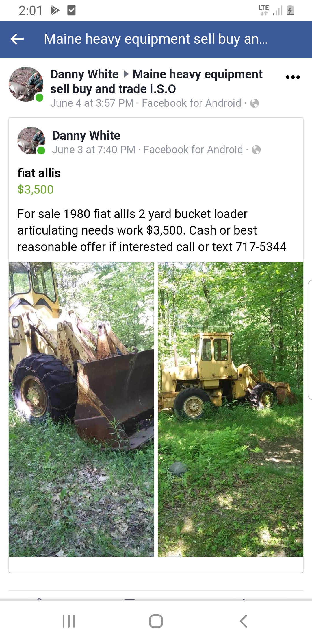

Post Options Post Options   Thanks (0) Thanks(0)   Quote ac89 Quote  Post ReplyReply Direct Link To This Post Posted: 29 Aug 2020 at 9:43pm
Here she is. Guy wants 3500 for it. Thoughts? Pictures aren't great but it looks like it's in decent shape.

I never believe "ran when parked" stories. i'd hit him low if you can't hear it run.
also i'd be weary of going to get it running...price goes up then...unless you make an explicit deal with him...like if you get it running, it's still xxxx dollars, and you're still willing to buy it no matter what.
you may luck out, or you may have a boat anchor
Points: 36689
Post Options Post Options   Thanks (0) Thanks(0)   Quote DMiller Quote  Post ReplyReply Direct Link To This Post Posted: 30 Aug 2020 at 6:40am
As a Salvage or scrapper that is worth MAYBE a Grand, would offer no more as so many things can be wrong from sitting.  Brakes, Clutch, or power sift, hydraulics.  Bucket looks worse for wear, the owner added chains for slick tires(NOT Cheap if can find replacements) and as noted fuel system is down.

Just guessing but appears a Early 545 series Allis not FA.  Roosa Master/Stanadyne pump on a Farm Tractor base series engine in it.
