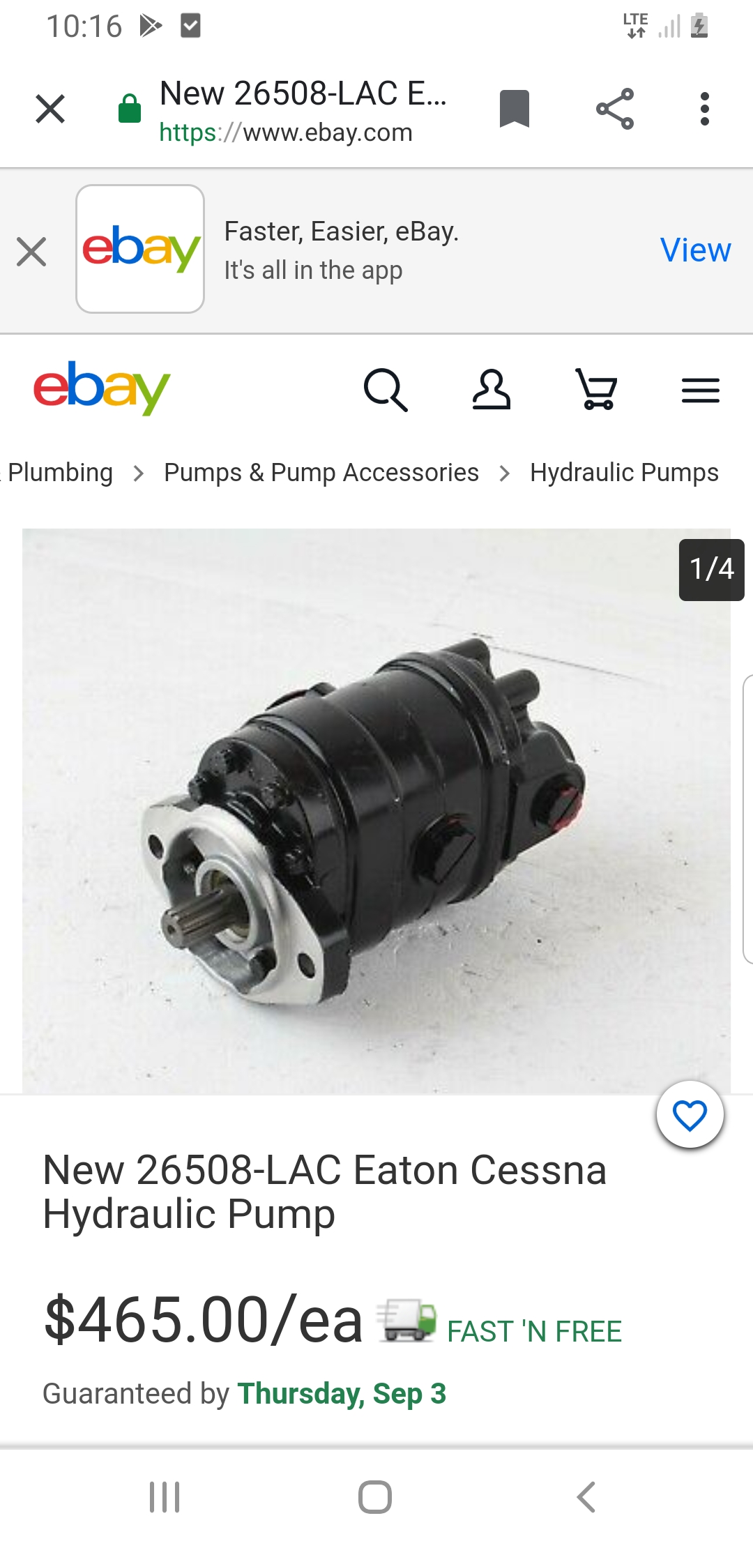

I found a pump online that is identical on the outside of mine. But it doesn't tell me the specs.
Points: 36766
Post Options Post Options   Thanks (0) Thanks(0)   Quote DMiller Quote  Post ReplyReply Direct Link To This Post Posted: 31 Aug 2020 at 3:09pm
Almost looks like the trans pump for my 7G
Can go to Eaton Cessna and look up by pump number for specs.
