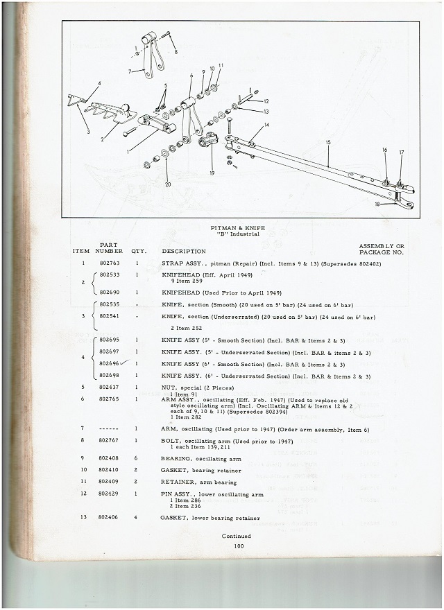

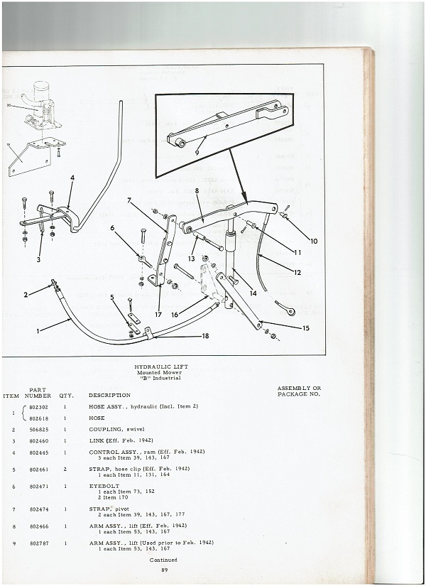

There is a version of the B/C mower for the B Industrial tractor. This had a 2 piece pitman that would allow for much more up and down travel.

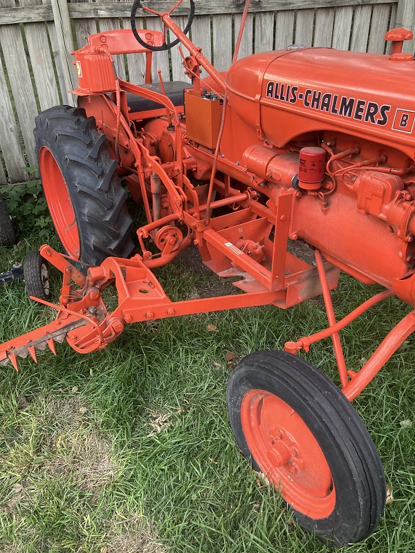

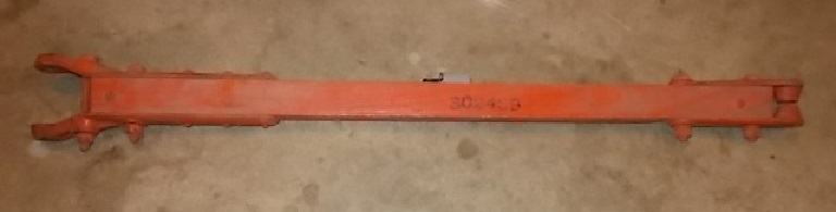

OK, William sent me 5 photos of his sickle and i will post below. I have never seen this setup. It appears to be the "standard" B sickle frame on the tractor, with a different "PIVOT UNIT" at the bottom that allows SOME vertical travel... William, it appears in the photos that you have MOST of the parts you need... what i dont see is the WOODEN STICK that connects your steel pitman arm to the bell crank under the motor ??? Is that what you need, the WOOD pitman and its steel ends ?
Look at PAULS parts book drawing a few posts UP..
Edited by steve(ill) - 13 Jul 2020 at 5:59pm

William, you phone or camera is set on HIGH RESOLUTION.. The photos you are taking are 4000 x 3000 pixel size and take up about 2.5 MB each... To post on this site you want to open your picture on your computer in "paintbrush" or similar and shrink it to 800 x 600 pixel and it will take up about 100 KB in size .......... then the site will let you download.
Points: 5162
Post Options Post Options   Thanks (0) Thanks(0)   Quote PaulB Quote  Post ReplyReply Direct Link To This Post Posted: 13 Jul 2020 at 8:19pm
I've never actually seen an IB mower. However all the pictures do seem to match up with the parts book. I had hoped to find one someday to swap the head onto my #5 mower.
  I do have a NOS IB mower pitman assembly  802439.
 I also have a NOS 802803 IB mower swathboard. The IB swathboard is shorter that the regular mower swathboard.

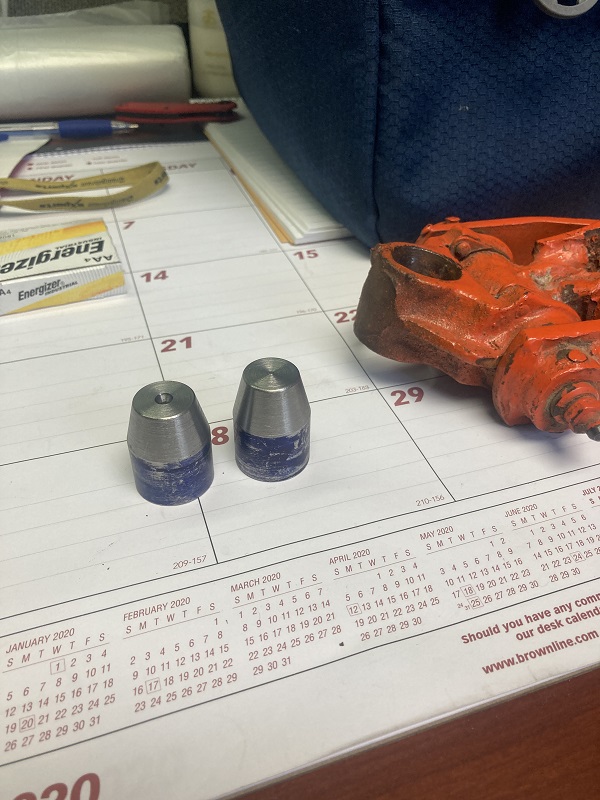

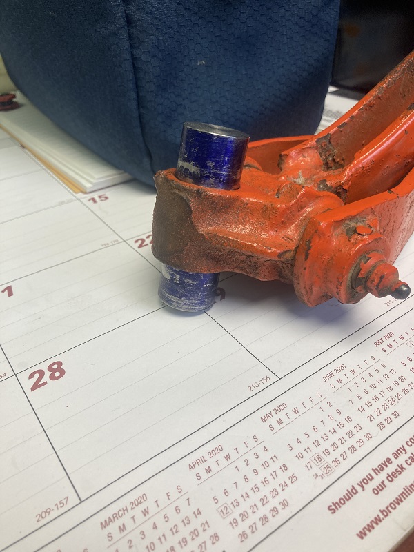

I am missing parts #14 and #15 according to the schematic. I went out and looked and I may be missing the swathboard as well.

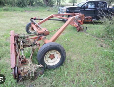

The IB mower that i once saw was mounted to the C channel frame, not under the belly.  That mower ( not Allis) was capable of vertical cutting..
Allis-Chalmers IB with sickle-bar mower.

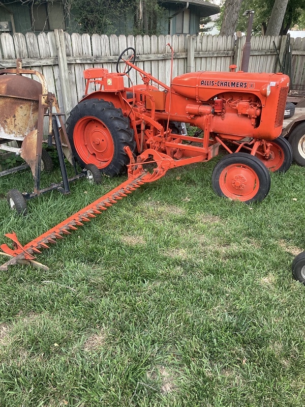

Thanks for the help from everyone.  Quick Update: I have been unable to find the parts I needed so I have begun to make them.  Thought it would interest some.

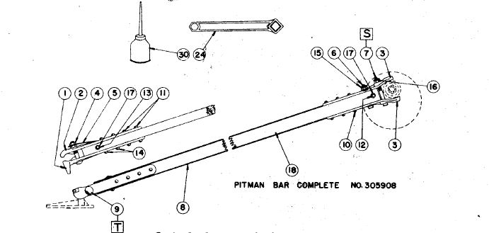

do you have the name  for # 24  the wrench ?   I have on and have seens  lots  neverknew what they went to  .
