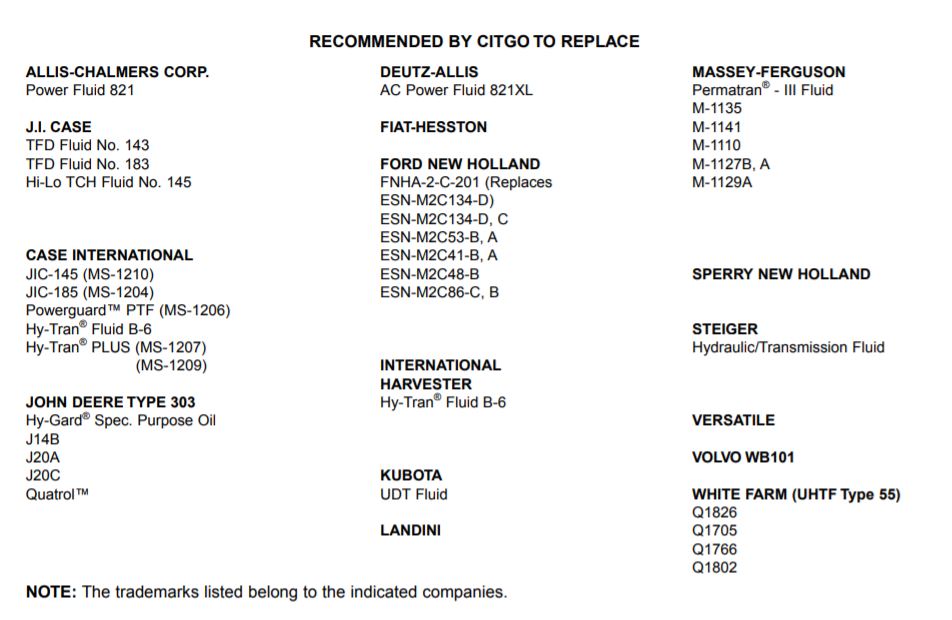

Post Options Post Options   Thanks (1) Thanks(1)   Quote steve(ill) Quote  Post ReplyReply Direct Link To This Post Posted: 04 Jun 2020 at 8:59pm
As an example , here is MYSTIC oil by CITGO.... this is their "SPEC SHEET"...

Post Options Post Options   Thanks (0) Thanks(0)   Quote NoslenroK Quote  Post ReplyReply Direct Link To This Post Posted: 04 Jun 2020 at 9:08pm
Steve, thank you immensely. I wanted to know what spec. of oil I needed, but really a particular brand. Thank you so very much!
