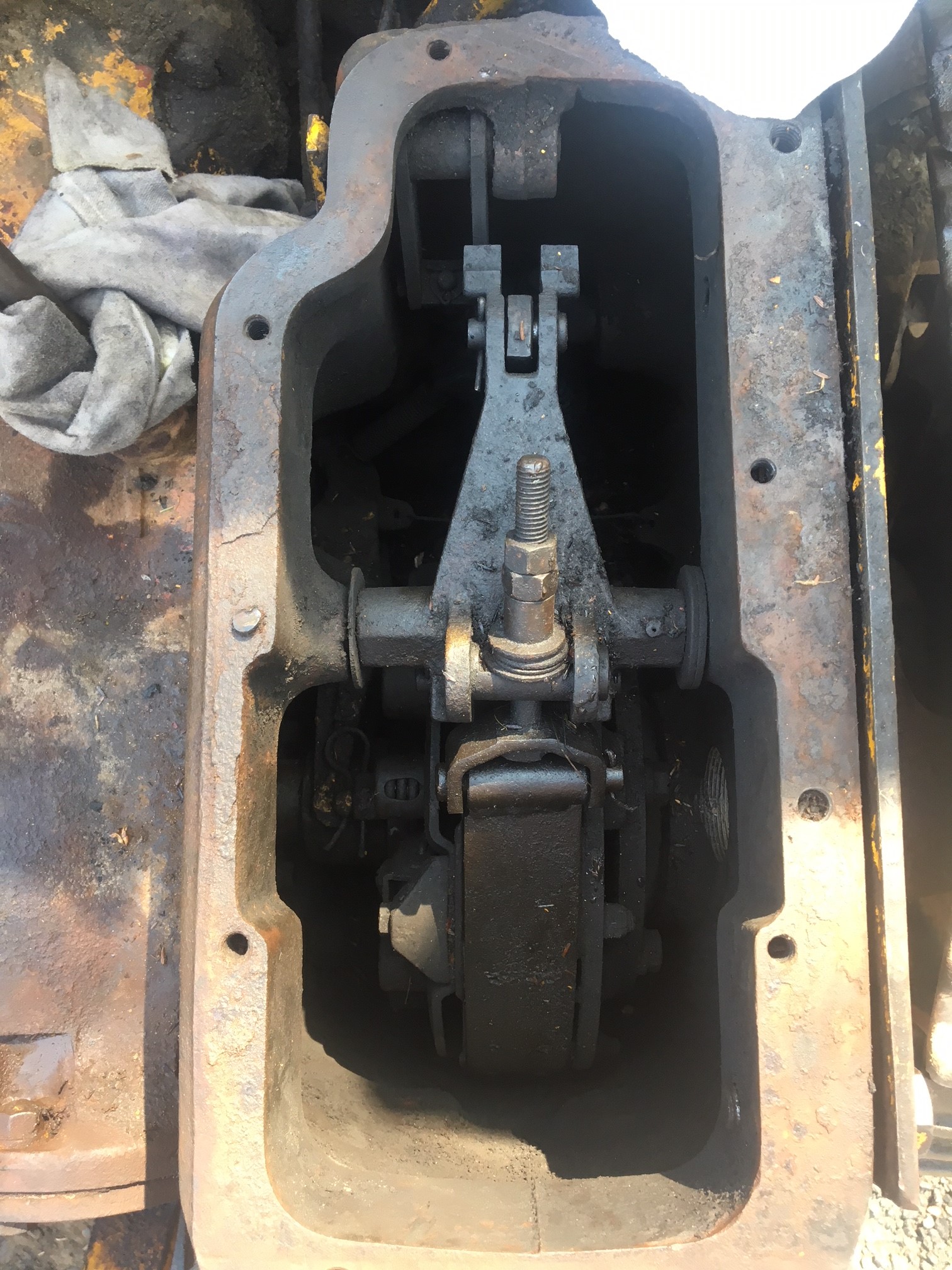

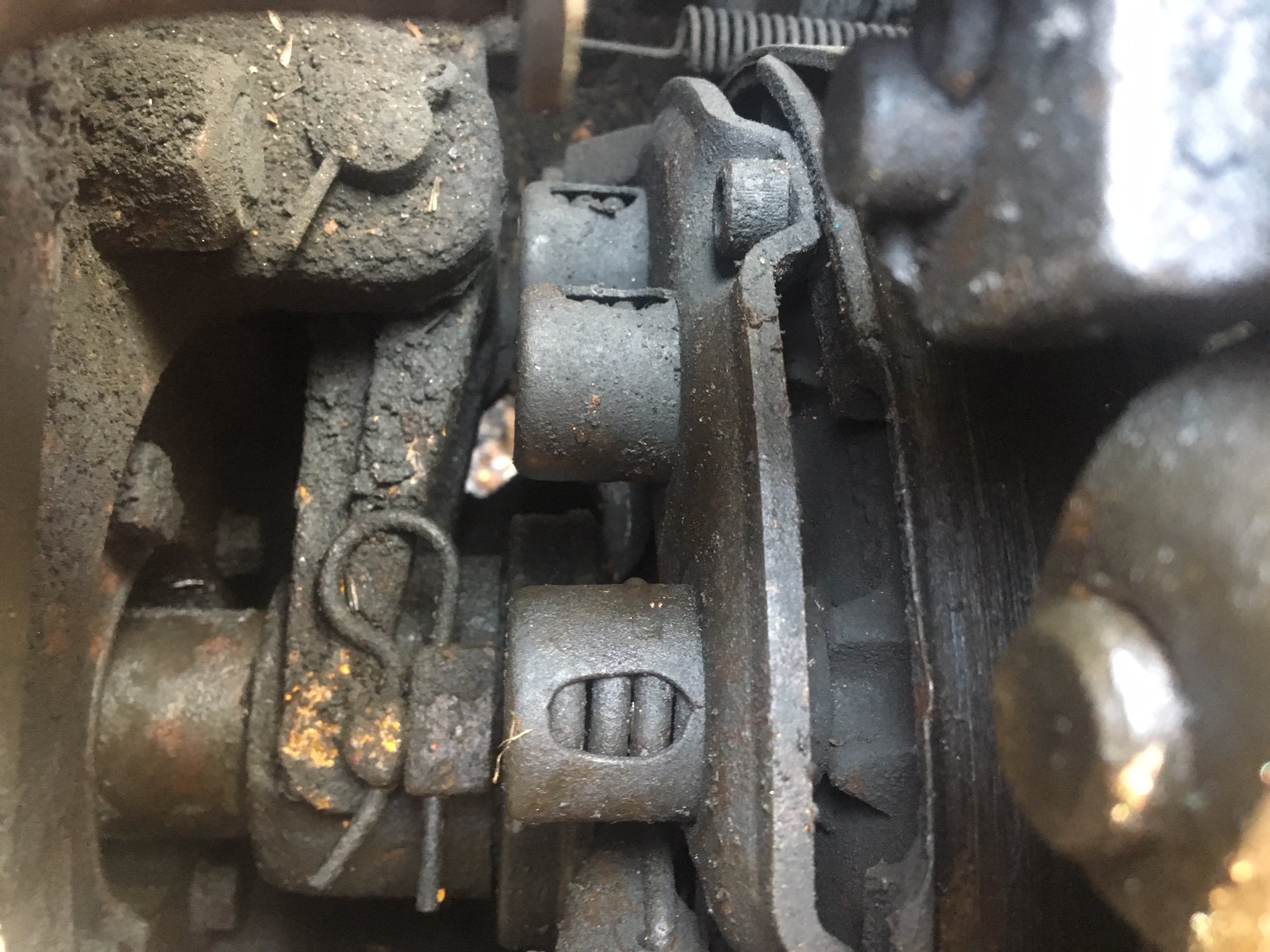

I have come to the conclusion that it is a clutch problem. I removed the Tanks assembly and now have proper access to the clutch compartments. The flange attached to the drum spins the track, so I know its not a final drive. However the spline covered shaft doesn't spin on the right side when the drum spins. So my guess is that the shaft is stripped. Will this cause any problems with removal? Also, how do I access the shaft? Must I remove the fork first? any idea how?

For Background, I have a manual for the HD4 and 655. I have read every post I can find on this website on the topic of steering clutch removal. What I'm hung up on is how to gain access to the shaft with the split-pin-ring-thing. When looking down, i can see barely an inch of the shaft and I can't even touch it. the space is so small. How do I create more space to access the shaft to remove the pin and then slide it towards the transmission?

there is a small band around that shaft with a small pin on the end of it. you will need to make a hook to put under the clip to pull up to disconnect the pin from the shaft. you cant remove it just lift up the end with the pin. you should be able to barely just see the clip. that pin goes into an indention on the shaft. there are 3 indentions. I think mine was in the 2nd indention. good luck

Thank you! I'm starting in on it this morning. I have the machine up on blocks with the tanks off. Is it possible to remove the fork/yoke? or at least disconnect it so it slides towards the transmission? I am concerned about the limited access.

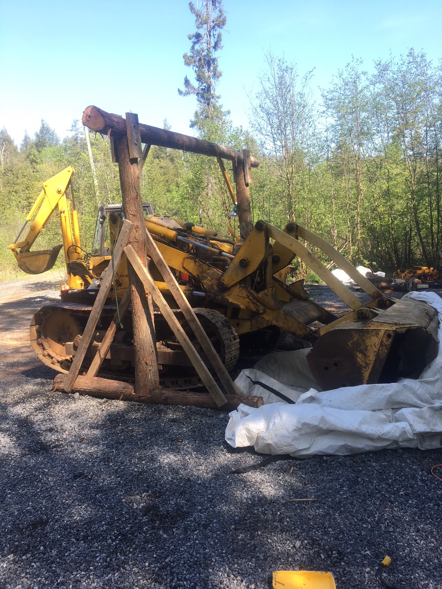

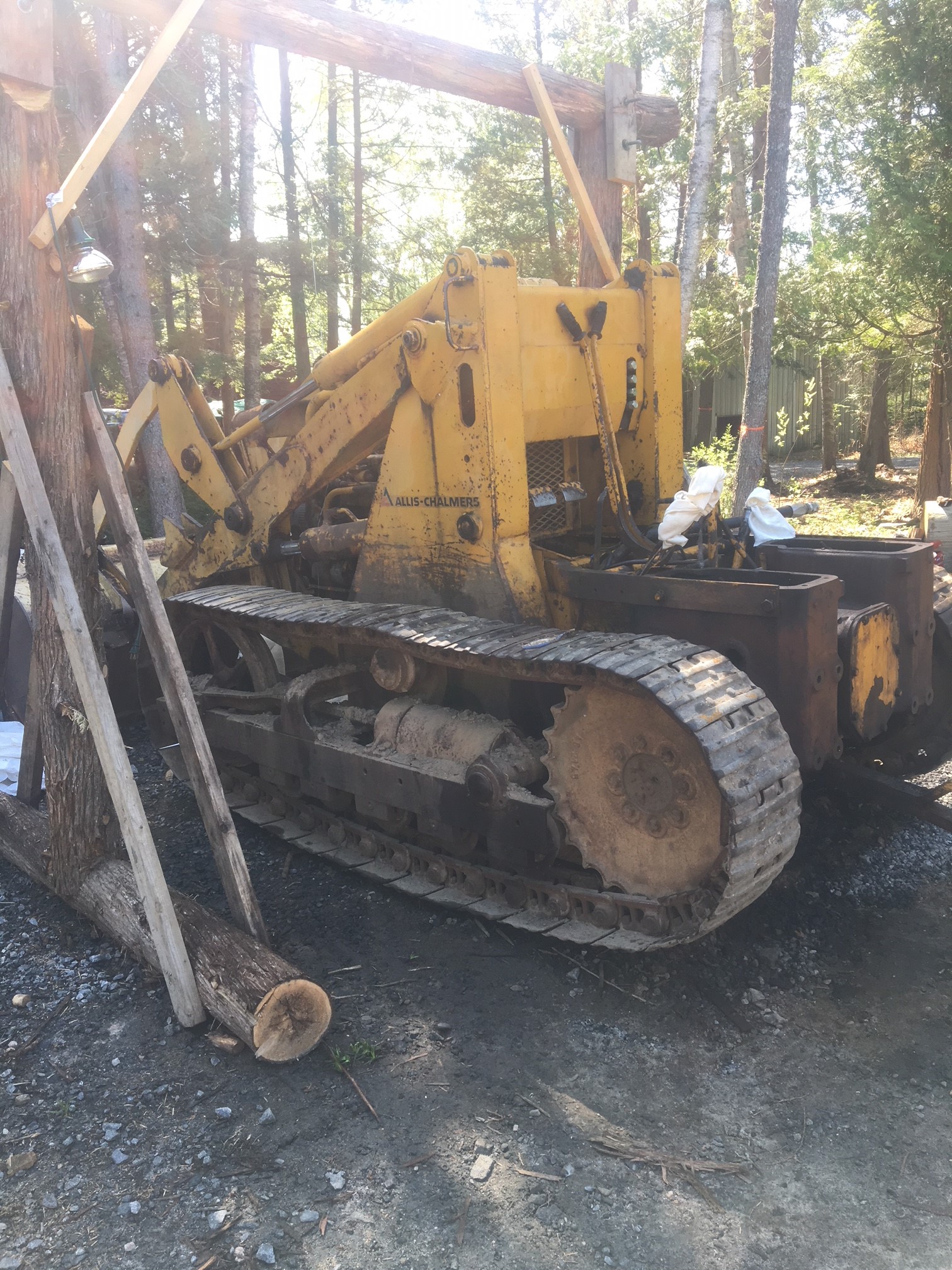

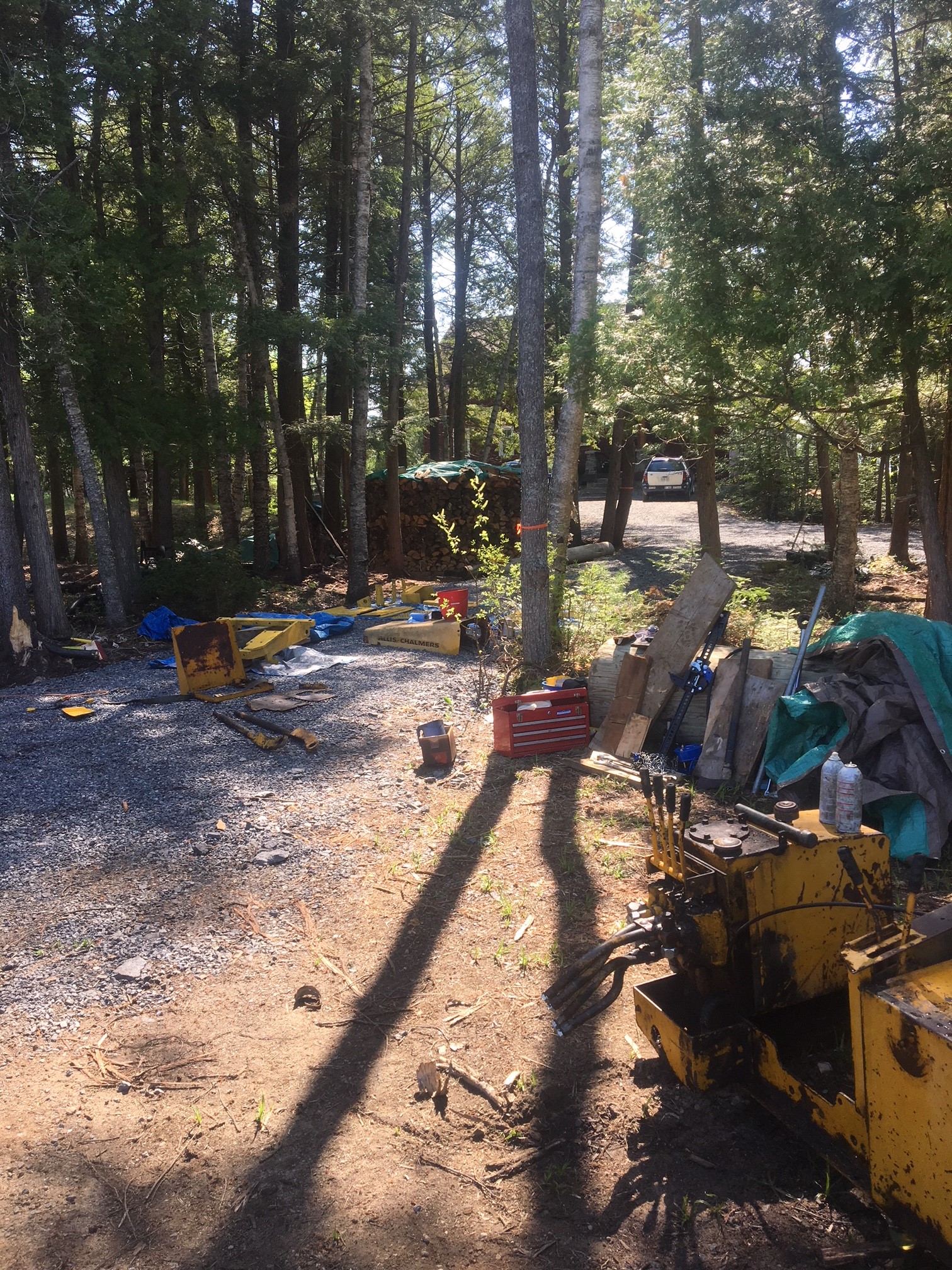

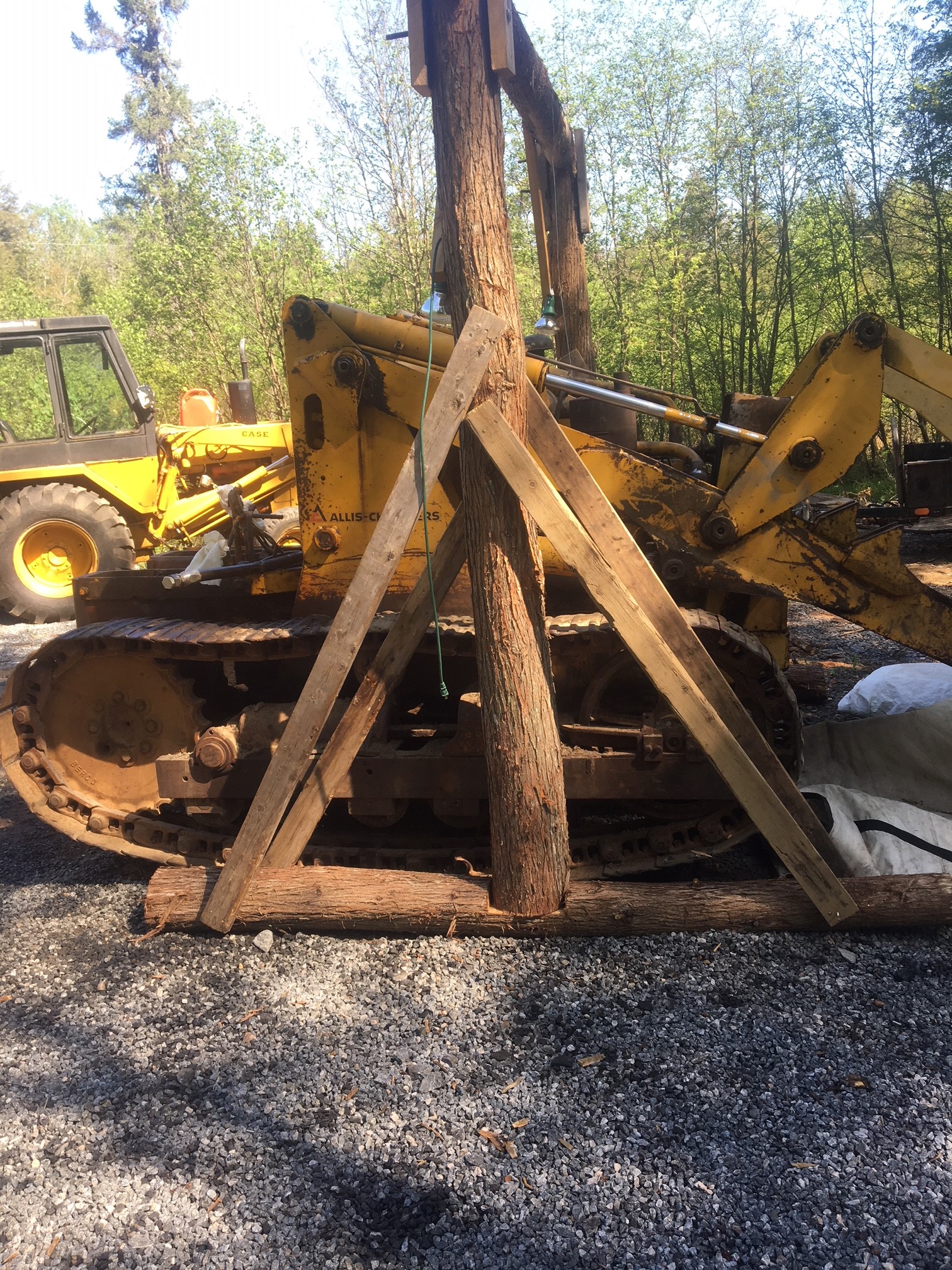

Here are a few photos of my project. Any help with how to make space to find the pin on the Spline shaft would be appreciated.

don't think you can remove the yoke till you get the clutch out. pull the brake band straight out and the clutch will come with it once you get the shaft back. you only will have just a little clearance so it has to come straight up. probably should replace the throw out bearing and the seal on the shaft that comes through the tranny housing. if your clutch plate is not pitted then use emery cloth to clean it. I think Idaho gear sells the clutches and brake bands. take your time. get it good and clean. I sand blasted my parts I took out the premièred them with grey primer to stop any rust. its a difficult job for one guy so do it right the first time so maybe it will never need it one again.

It's was a pain to pull the clutches on my 653 because everything was froze up from sitting. To make it easier to get to the "band clip with a pin" out, I took out the stilt pin. I think that's what the service manual calls it. This allowed me to pull the throw out bearing as far from the clutch as possible. Based on advice from here, I bought a long, thin, cheap flat screw driver. Bent the end so I had a 1" 90 degree bent to work under the clip and pull it out. After that, disconnect the brake linkage, slide the axle in, take out 6 bolts and the clutch can be pulled out.

sometimes the clip pin is locked into the indention on the splined shaft that is closest to the ring gear area. that only lets the main end of the splined shaft connecting and driving the shaft . I say take the fork keeper and verticle pin out and move it toward the front of the housing as far as possible. that will give you better room to lift the clip at the clutch hub . use your finger to feel for the clip end and you will feel a raised pin on the flat/smooth part of the ring. once you lift it up it should be out of the way to allow a long screw driver or rod to slide the axle out of the clutch. try to determine which of the three indentions the pin was in,, very important. once the six 3/8 bolts are removed from the back side of the clutch you will be able to lift the clutches out using the brake band.
