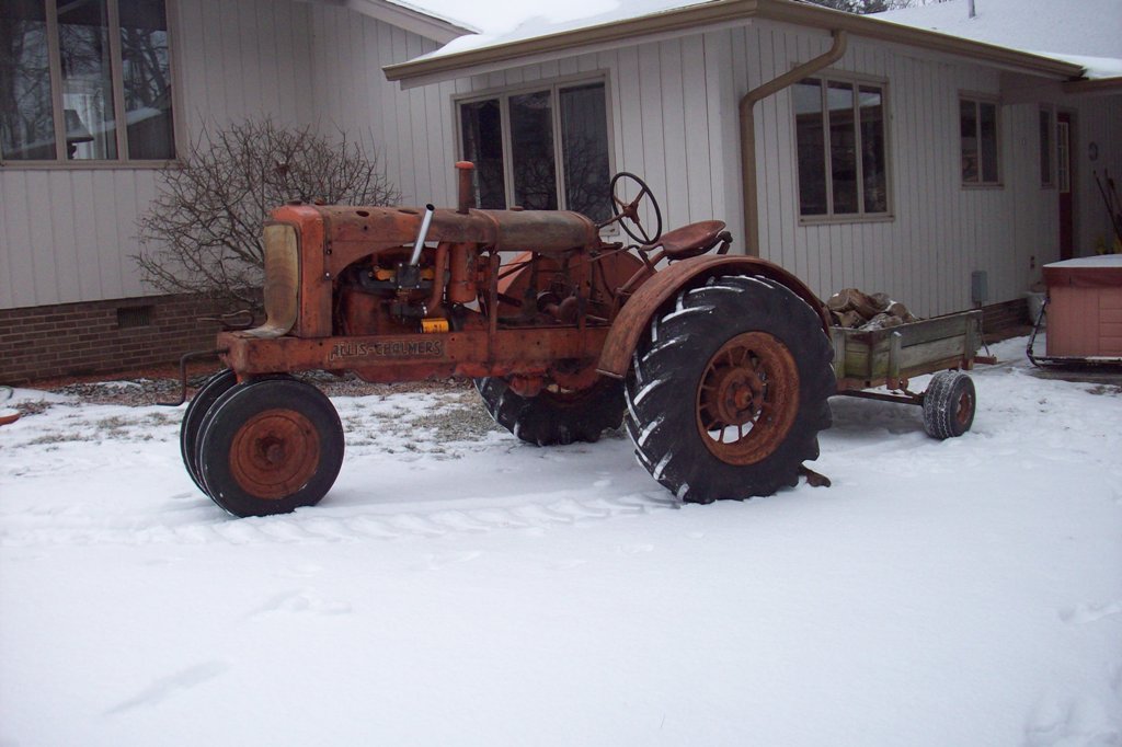

Many winters ago we had a real cold day in January and none of my battery tractors would start. The old WC started with crank no problem. I used it to move firewood that morning while the other tractors were on charge.
