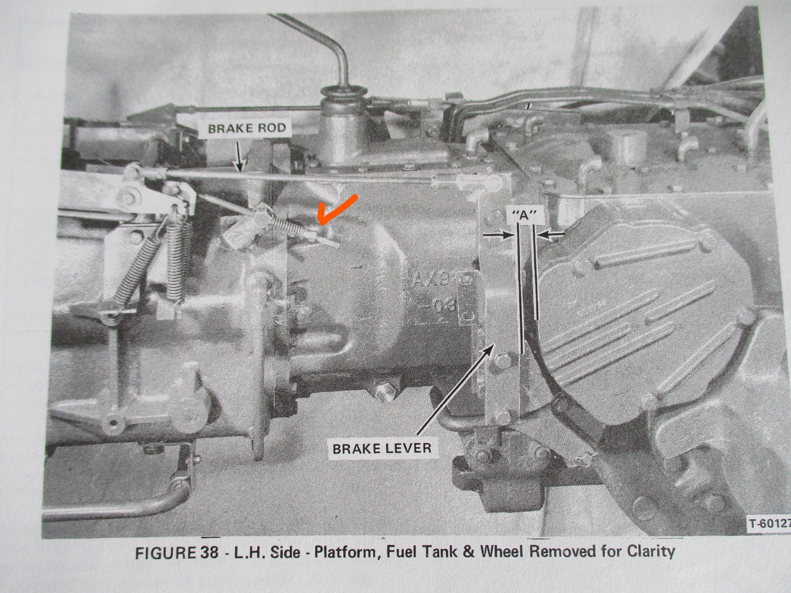

I have the hardest time going from park to say third. I may have to push clutch in 3 or more times before it will go in. In the picture, is this the lever to adjust it. I can't seem to find that adjustment in the manual.

All the maroon belly 7000 tractors did use a dry clutch, but they also have a transmission brake and an adjustment rod like what is shown in that picture. I don't remember the compressed length of the spring,but that is where you adjust it. I have had to replace the brake puck on some tractors.

Lynn, I was told maybe it has been set to tight not allowing it roll to a stop, for engagement. So I will back the nuts off a little and try it.

I finally had a chance today to work on the shifting issue. I did loosen the trans brake a bit, 1/8". So long story short. I have never driven a tractor w/ a clutch brake. And have found the right way to operate it now. I did adjust the trans brake back to where I found it.
