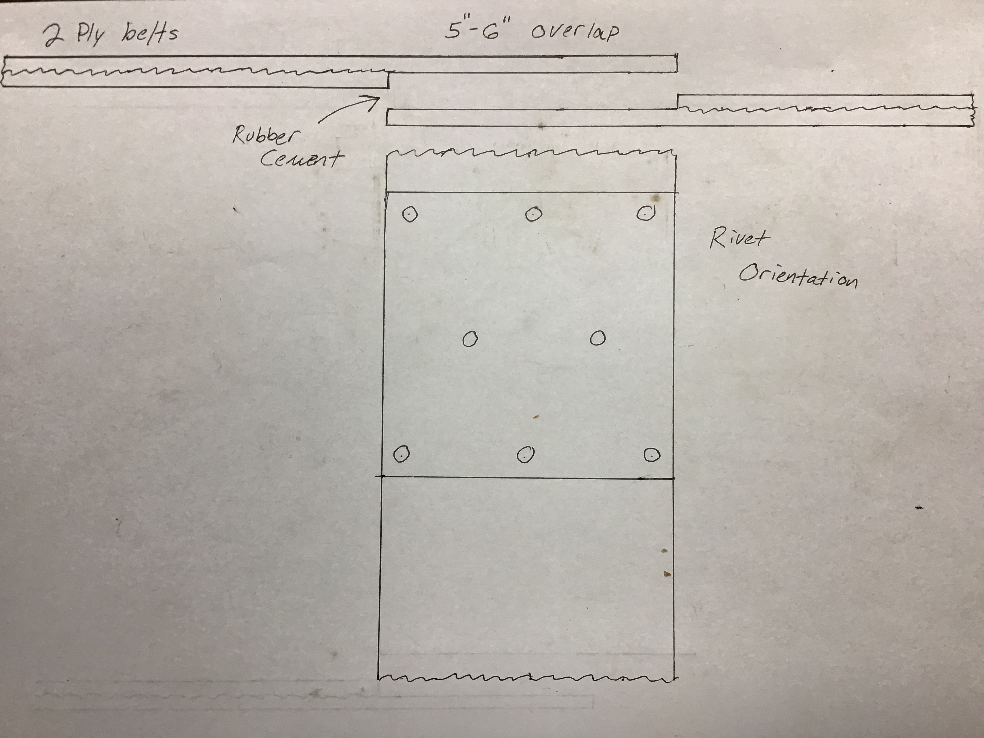

Anyone try this before? I had this idea last week (not sure if someone else thought about this but didn’t find it previously)
From what I found out through the forum, the Roto-Baler belts were 2 ply. That being said, what if you took and shaved off one ply on each end, opposite side respectively, and glued them together with a heavy duty rubber cement and riveted them lightly. Some belt lacing systems use rivets instead of the clipper type system, so I would think rivets would be ok. Attached is a rough drawing. I am thinking about trying this on my next baler, since I just put new clipper belts on my current baler. Any thoughts?

Hopefully this photo is smaller.

Interesting idea. Would this be less expensive than buying continuous belts - or are those no longer available? Or some other advantage?

Problem with using a splice, other than the clipper type, on a  AC rotobaler, is that the rollers are real narrow, and using a splice, that is long, subjects such a splice to a lot of stress, while the clipper type splice, simply bends with the stress. The longer splices such as the alligator, etc are only recommended for machines with a minimum roller diameter of 6".
That being said, try it on one belt, and see how long it lasts!Wink
I don’t believe that the continuous belting is available any more, not unless you buy NOS.
I would think that a glued overlapping splice, like drawn out, with a similar rivet orientation would be more conforming to the small rollers than any type of mechanical splicing.
I still have enough belting left over to make one more belt. I might give it a try and throw it on my baler before we bale the wheat.

Chemical and vulcanizing belt splicing is a common thing in industry now. No rivets used, but there is a bit more to it than your plan. I won't say your plan won't work. I would suggest you talk with a company that does belt splicing they might give you some pointers or suggest an adhesive. They can make splices that are hard to spot in conveyor belts.

You may be able to find some place that will make a wide belt, then have it cut it into 6 narrow ones, That's how the "endless" belts were made to begin with.   It is very critical that all the belts are EXACTLY the same length or they won't run true.  Most any place would want a number of belt to be made, so it all gets to how many set you could sell.

This guy probably has endless belts.
http://www.balerbelts.com/main.html
I’ll take a look into that!
