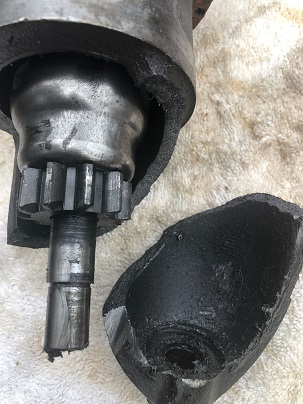

Converted my WD45 to 12 volt system with a solenoid switch to deliver current to the starter motor. That happened a couple years ago. Tractor has had light use since then. At the time, the original 6 volt starter motor was modified to replace the button contact with a post and to incorporate some sort of "shock absorber" to deal with the higher voltage.
Today the starter motor wasn't engaging the ring gear. Here's what I found:
You can see a spot where the casting has been chewed away by the ring gear teeth, so this may have been broken a while.
Any thoughts on whether it's better to replace the nose, or should I replace the starter motor with a 12 unit?
Thanks for your help!
Dave

I would check timing. Starter spring is usually what 12v breaks.       MACK

 That does not look good! Thanks for the warning. Old iron, spinning faster. Yea I could see how this could happen! Looks like you need a new starter. I would just find a good used 6 volt and put that in. Also maybe spin the engine by hand and examine the entire ring gear.
I would agree that if there are marks from the ring gear that it may have been broken for a while and the nose piece was just dangling in there. Sounds not too good.

Had the starter bee properly rebuilt with 12 volt field coils, it would not hit the ring gear so hard when the starter engages. That extra whump also is hard on the nose casting.

Appreciate the input, guys. Also showed the photo to my brother-in-law who's a retired Cat mechanic. He agreed with Mack - thought that it was caused by the engine kicking back - timing issue. He felt that the break in the casting looked really fresh. Paul, I think it'd take a lot of stress out of its life if I replace the field coils! Update to come.

    Its called doing what Paul said .I will not send a customers tractor out of my shop that dose not have correct field coils in it when changed over to 12 volt .Beside a old starter that has been already wore out with a low voltage 6 battery and throwing 12 volt at it is asking for trouble.

I've always preached here, that if you're running a 12V conversion, its always best to do the Starter motor and change it over to 12V's also. When you send 12V current through 6V field coils, it makes the Starter motor violent. The results are usually cracked nose cones, bent or broken drives, or prematurely worn out ring gears.
Looking at that drive on your Starter motor in particular Dave, that looks like the engine kicked back at one time or another and whacked the drive. I would bet a paycheck that the mainshaft is probably bent. Doesn't take much. I've removed bent mainshafts and the Starter motors were still working. Inspect the nose cone and make sure the nose cone isn't cracked, or has a hairline crack in it.

Interesting, Steve. I noticed that the starter would wobble a bit in its mount when cranking the engine....perhaps because the shaft was bent when it got whacked by the kickback?
I ran across a starter drive called a "barrel drive" - based on the pictures I found, that's the drive that's in my motor. They were mentioned as a good idea if using a 6v starter in a 12v system. Anyone know about them?

They do have a shock absorber in them. It's the spring on starter drive.
Them old 6v starters will last a long time at 12v. Might as well run them until they are junk, may never have to be replaced.
Have saw more noses broke on 6v than 12v, all because of kick back from advanced timing.        MACK

If it had (past tense) a little wiggle waggle to it, its bent and is done wiggle waggin'! Probably had a little bit of an issue previously, and the second time around did it in. Barrel drive units are what I use in my 6 & 12V rebuilt's along with a rewound armature. Depends on the model Starter and internal design basically. I see Mack is one of those "let r' rip" kinda guys.  LOL!! "Run it till its junk"....  LOL!!

Chucked up the armature in my drill press. You can call it "Wobbling Willy"!! I think it's toast.
