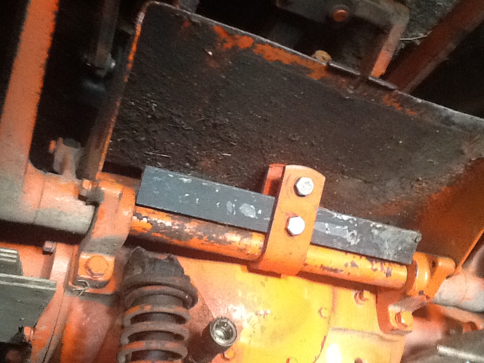

Mine has 2 straps similar to this which hold a flat bar to keep it from moving sideways and there are a couple ears on the center of the flat bar where you pin the 3rd link. It's yellow. It was farm store bought by a neighbor many years ago.

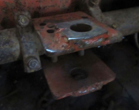

    This is one I made years ago, split pipe around rock shaft and bolts to the pto bearing hanger. Just need ½” longer bolts and you have to notch the plate

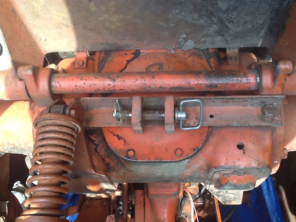

Here's what I came up with.
Took the two top rockshaft bolts out. Unbolted the seat shock mount and put the bolt back in.
A quick dip in the scrap bin, a little wire feed and some drilling, and  some paint and a pin.
Relocated the seat shock mount. Looks pretty sharp. I did have to put a washer behind the angle iron to get it away from the differential cover.
Thanks for all the good ideas!

Post Options Post Options   Thanks (0) Thanks(0)   Quote jaybmiller Quote  Post ReplyReply Direct Link To This Post Posted: 05 May 2020 at 5:24am
That's a nice 'clean'  install !
At first I saw the rope as the 'top link attachment'...Big smile
Great thing is it can be 'undone' and put back to OEM specs before the 'correct cops' arrive !!!
Have to ask why the angled cut on the left horizontal section ?
Just curious...
jay

Post Options Post Options   Thanks (0) Thanks(0)   Quote littlemarv Quote  Post ReplyReply Direct Link To This Post Posted: 05 May 2020 at 5:49am
One less thing to bash my ankle on when getting on and off. The rope is for pulling the hitch pin so you can unhook without getting off and on again. I'm 5' 19" tall so once I get on the WD and get my legs in there and adjusted so one leg is 8" shorter than the other, I try to stay there. Thinking of extending the seat back 6". And installing a seat bushing kit to make it a little more comfortable.

Post Options Post Options   Thanks (0) Thanks(0)   Quote jaybmiller Quote  Post ReplyReply Direct Link To This Post Posted: 05 May 2020 at 5:54am
Hay I like the rope for pin trick !! I'm always dropping the R-pin onto the ground. NOW I have to find some old school rope to secure the pin onto the tractor.

Very nice job Marv. When I get to doing mine I will do it like that. Only problem I see is right side of that bracket should have end cut at 45 just like the left. πŸ˜€
What size is the angle - 2 in?

Post Options Post Options   Thanks (0) Thanks(0)   Quote littlemarv Quote  Post ReplyReply Direct Link To This Post Posted: 05 May 2020 at 9:41am
It's 1/4" by 2 1/2" angle. Just some scrap I had laying around. I don't see why 2" wouldn't work.
