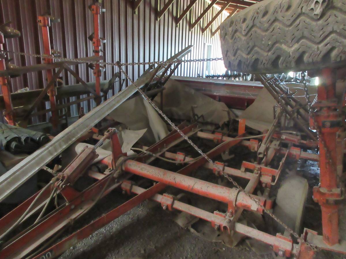

If your 1200 is like this one, I’d guess it’s got 15” rims. The older 15” pickup tire is shown in the photo’s upper right (FC’s left wing). But, it looks like either a 9.5L-15 or 11L-15 is on its left main frame?
Edited by AC7060IL - 23 Apr 2020 at 10:07am
