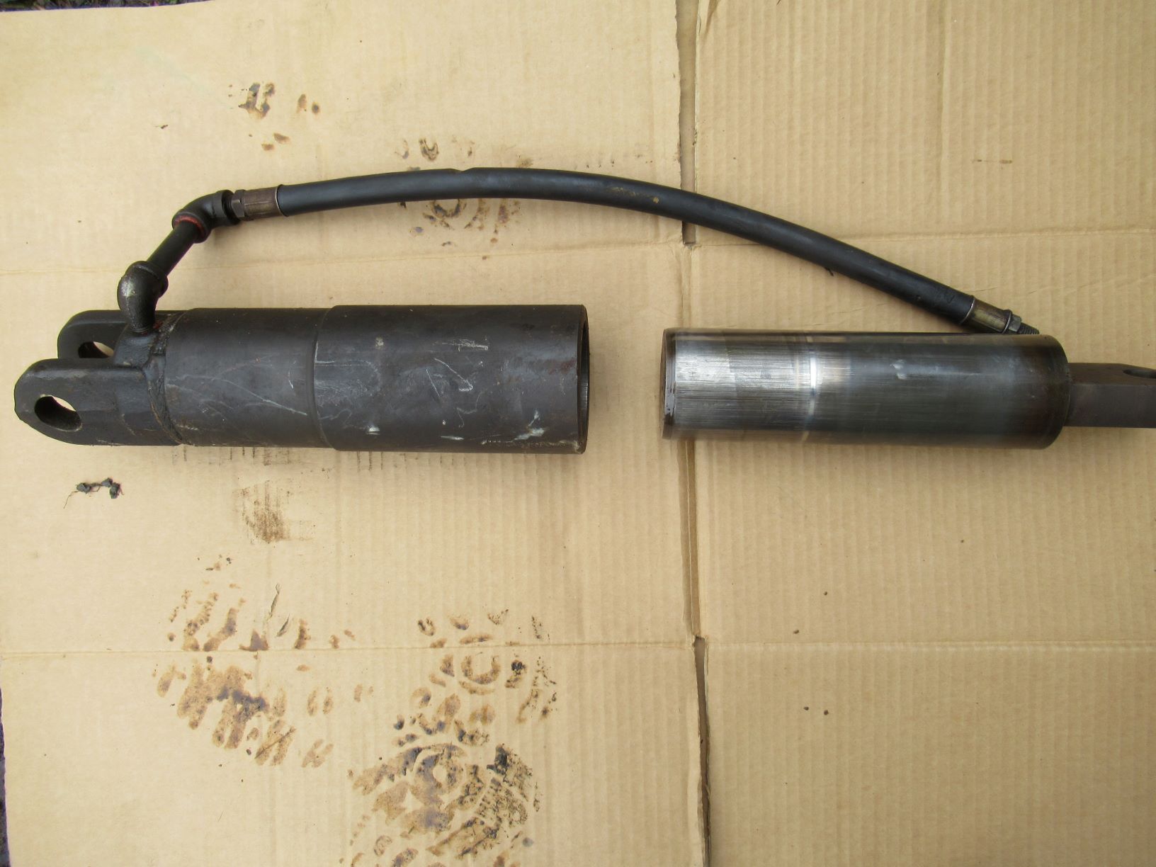

You need to remove lift arm housing first. The piston will pull out of barrel with lift arm housing.       MACK

Mack   That Is The Way I Have Don Them For Years No Need To Pull The Pin  Alvin M

Post Options Post Options   Thanks (0) Thanks(0)   Quote Brian G.  NY Quote  Post ReplyReply Direct Link To This Post Posted: 04 Apr 2020 at 11:51am
Except.......probably the reason you're going through  all of this work is that you are going to repair the cylinder or replace the hose! Then, you might want to remove the pin.
Granted, you probably wouldn't bother to use that 8" 1/2" bolt since you are now right in there where the pin is.
