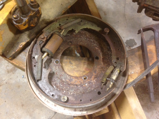

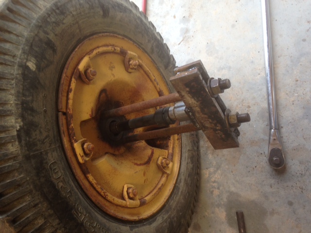

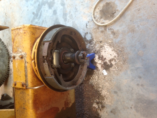

So, I built a puller and got my new brakes on...
Here's the old brakes...
Here's the new brakes...

I had to tighten the puller nuts down to 600 lb/ft and then heat the hub a little with the torch on two of them and they popped loose with a loud boom. The other two weren't that tight.
