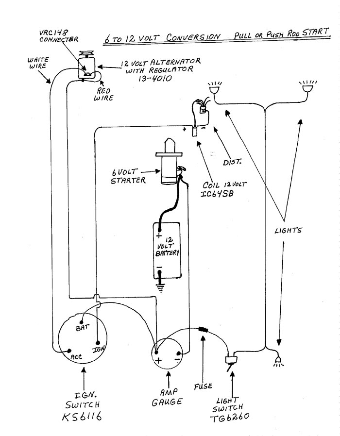

The previous owner of my 1955 WD45 was in the process of converting it over to 12V. I finished it using the schematic below, which I found here:
 http://dueyschutter.freeservers.com/photo3.html
Everything fires normally and the tractor runs. I have the exact switch from NAPA as recommended on that page. Bulbs have been changed out to 1156 LED's and I have the light switch and inline fuse wired exactly as the schematic says, but the lights refuse to work. The previous bulbs which were 1195's and not blown also refused to work. When I clip my test light's ground to the negative battery post, and touch the needle to the output post on the light switch, the test light comes on when I flip the switch on. This tells me there's some sort of grounding issue? But I have no idea how to route a ground back to the switch without blowing something. Would appreciate your knowledge on this. Thanks!!

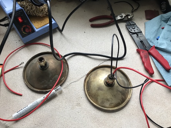

Take the socket out of the lamp housing and solder a wire to the ground side of the socket. Run it back along side the hot wire to the mounting bracket of the light tube, and ground it to the bracket mount which should be grounded to the bell housing and engine.

If the socket is connected to the reflector just take the reflector out and you should be able to clean up the ground connection or solder to the side of the socket for a ground wire.

The ground is rather iffy on those lights. The reflector contacts a little brass tab which is riveted to the headlight shell. Old age, corrosion and rust all take their toll and the ground is no longer continuous.  Best is solder a wire to the bulb socket as has been recommended and attach to a good ground point.  If using the thumb screw as the ground, make sure it's not rusty and makes good contact with clean threads and the light  tube.

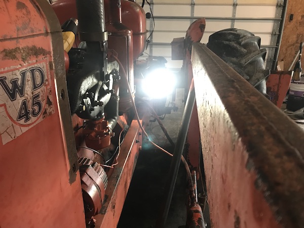

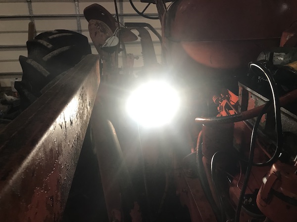

Took your all's advice and rewired these guys completely today. New contacts to the bulbs, new grounds on the sockets. Works perfectly! Thank you all for taking the time to offer your advice here =D

Thumbs Up Thumbs Up Glad it worked out and you could post pictures.

 Nice work on the lights! I have a light fetish. They do come in handy for real work in the field and or loading them after a antique tractor pull too.
Thanks for sharing the pictures too!
