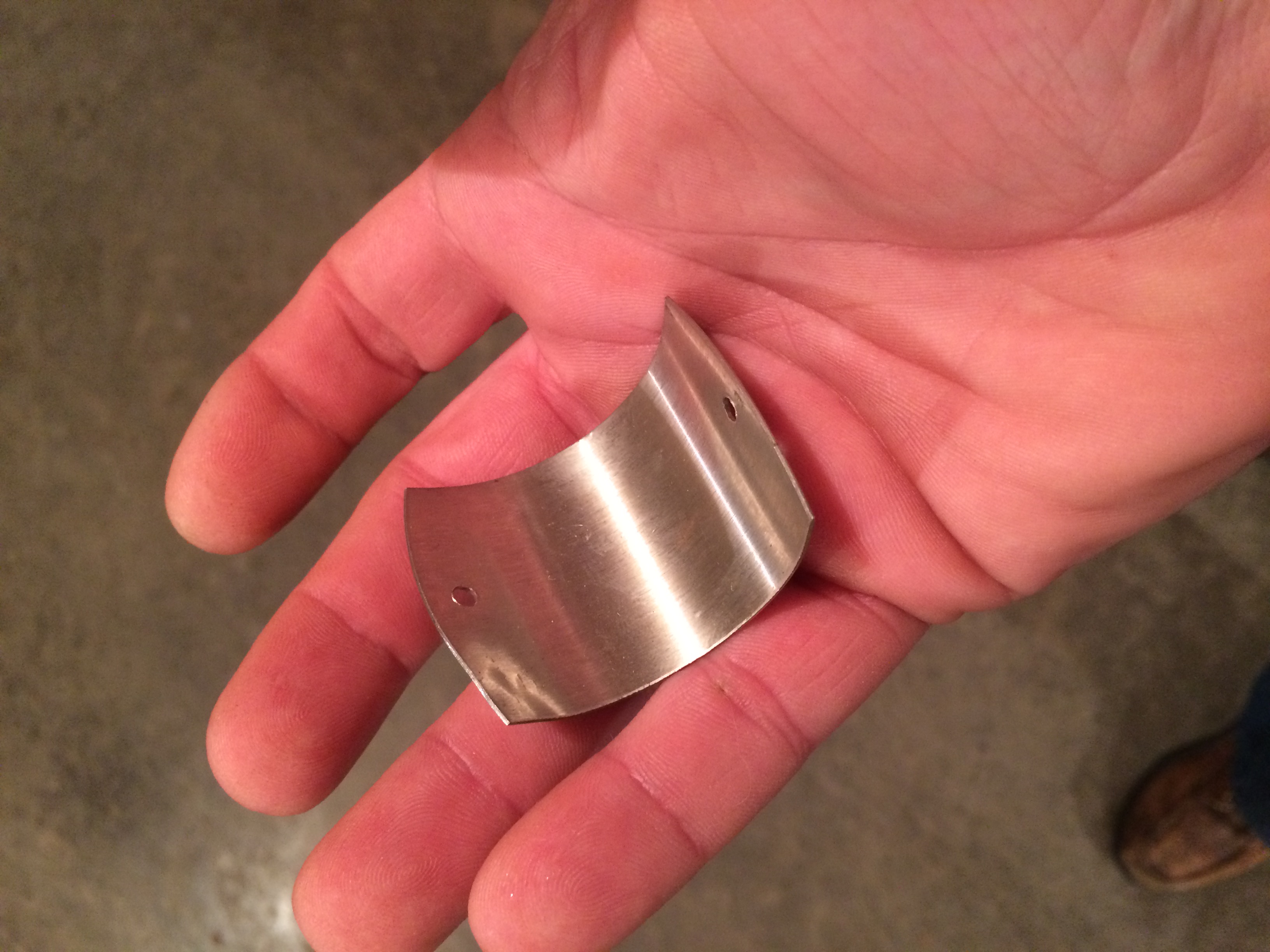

I have done this successfully but it will take some explaining of what I used.
In the fire service, ladders are attached to the sides of some engines & trucks.  When they are attached to the sides, they are held on with spring loaded "hooked" clamps.  over time, these clamps wear heavily on the aluminum rungs.  So stainless steel "arced" protectors are riveted to the rungs to protect the aluminum from the wear.
That being said, I use one of those rung protectors with a brass hammer to gently break through the epoxy that the cap is held in place with & gently pry it out.  You can not simply knock it out from the underside.  It's a tedious ordeal but worth it if you have an Allis center cap you want installed.
