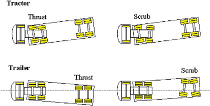

Post Options Post Options   Thanks (0) Thanks(0)   Quote steve(ill) Quote  Post ReplyReply Direct Link To This Post Posted: 06 Mar 2020 at 7:24pm
See the picture in the lower left........
