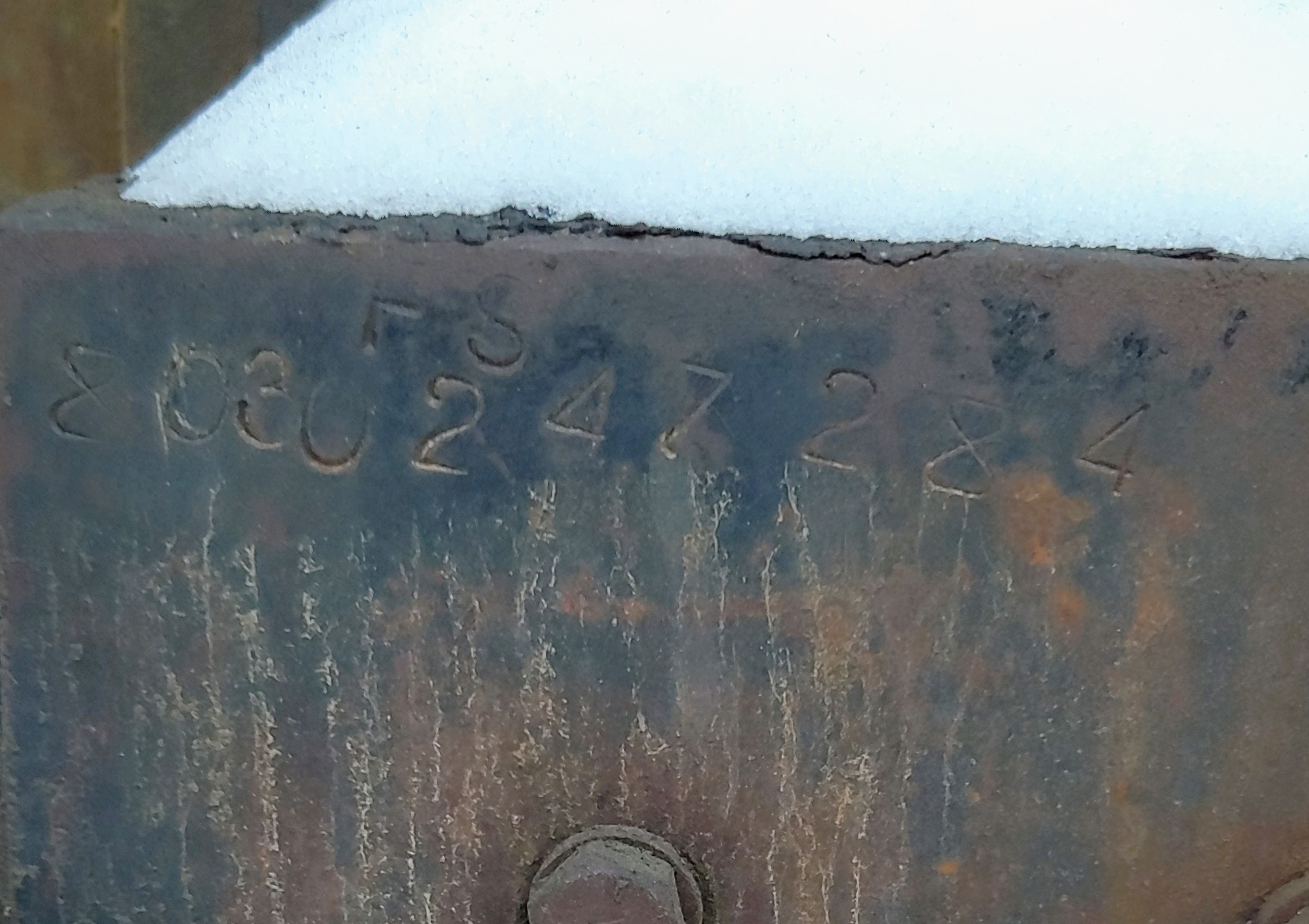

Having a little trouble breaking this one down, I'm not sure what the format is supposed to be and the sticker on the frame rail is worn off. What year of unit do I have? And which numbers are the serial? I thought it should be four numbers. Pic attached...I hope.

2472 last two maybe for 1984. First time i have ever seen that

Tractor Data Info
1981: 1001
1982: 1009
1983: 2093
1984: 2701
1985: 3146
Final: 3328

Looks to me like mid year 1983.

Ok thanks, I was thinking mid 83 too but wondered why it would say 84 then, or 84 at all since it should be four digits.

Serial # Is Stamped in The Rear Housing  Above pto Shield

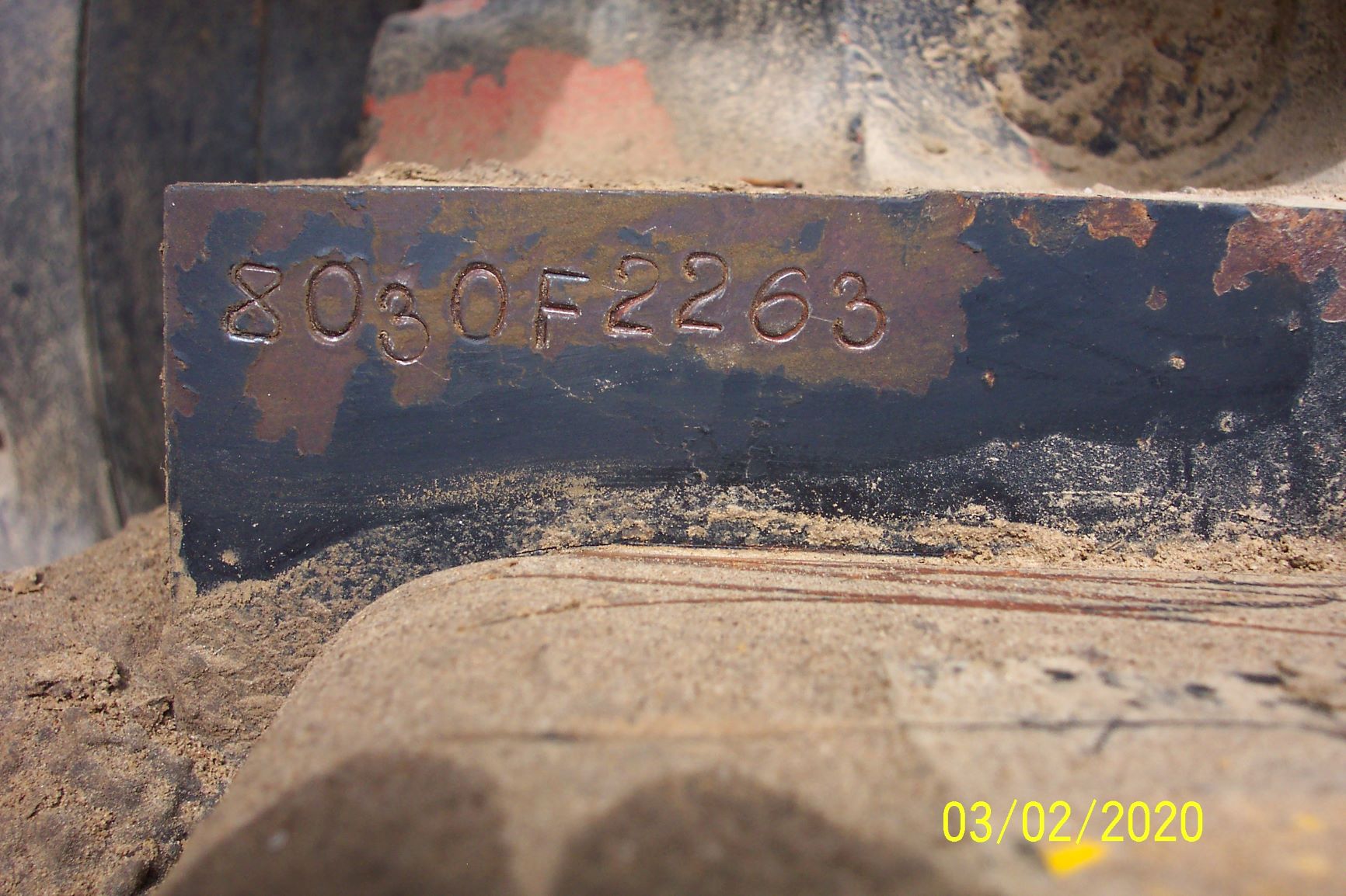

   After seeing your number I had to check mine out. It has a F between 8030 and the serial number but no other numbers. The F probably means power director tractor
8070nc View Drop Down
Joined: 21 Mar 2019
Location: North Carolina
Points: 663
Post Options Post Options   Thanks (0) Thanks(0)   Quote 8070nc Quote  Post ReplyReply Direct Link To This Post Posted: 02 Mar 2020 at 3:18pm
I thought F meant front wheel assist
1984 80780

Appreciate all the replies! Yes she's a Power Shift and Front Assist.
So what I think it probably is now is a mid 83, but an 84 model year..?, Wanted to differentiate that for some reason by adding the '84' at the end.
