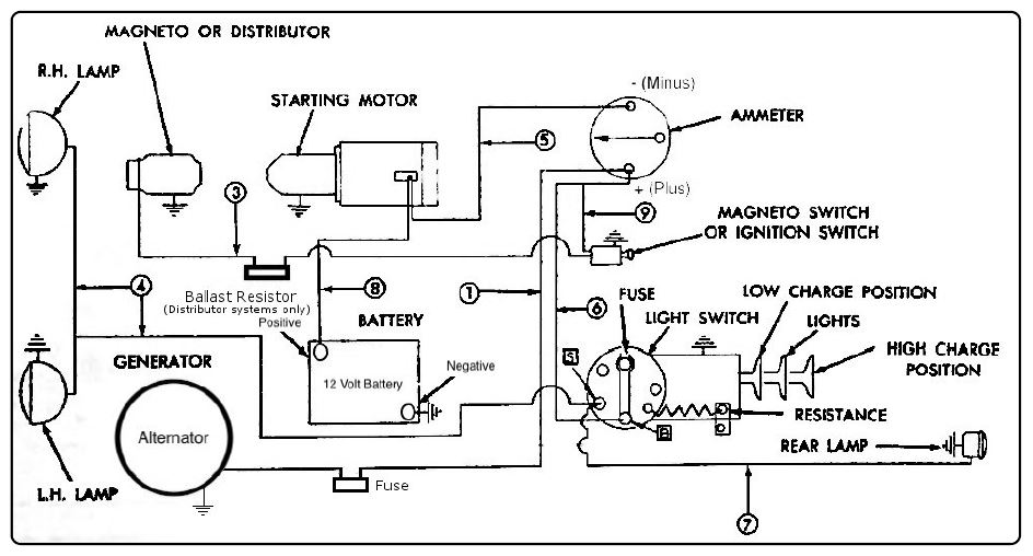

I found this diagram helpful when I converted my C to 12v with a one wire alternator.

Yikes! Using that diagram above is asking for trouble fir' sure with an Alternator doing the charging chores. Using an Ammeter AND the 3 postiion switch is looking for a fire or a BBQ on board! There's a handful of ways to wire your Tractor, but the above diagram is not the safe way. Get one wire to short, or the Ammeter to fail, and you got shish-ka-bob for wiring, and possibly loosing the Tractor and in a matter of seconds!  All I can suggest with this setup is to keep a fire extinguisher close by the drivers area. To each his own....

Gee Steve it's not that bad overall unless I'm missing something....
The fuse at the alternator protects it and 'stuff' after....
The fuse in the light switch will blow if lights or wiring short out.
However there should be a 'main' fuse at #(5), feed from battery to ammeter. That protects everything in case ammeter fails or anything 'downstream'.
If the decades old fibre step washers mounting the ammeter are replaced with nice, new nylon ones, it virtually eliminates 'ammeter meltdown' and  draining the battery with leakage from ammeter post to ground. Just curious as to what you see that my  eyes don't.
No fire, BBQ, or shish-ka-bob since converting... Sounds like you're h-angry Steve . I'm just trying to help the guy out. If you really think that diagram does more harm than good, please be constructive and post your "safe way" diagram.
Thank you for the constructive notes JayB. I'm going to take a look at adding that fuse and checking the washers on the ammeter (a voltmeter is in my future). System's been working well for nearly a year now, but there's always room for improvement, especially when it comes to safety.

Depends... I've read the old ammeters were rated for 30 amps, so that is the limit for the diagram above. If your wiring gauge and length can support 30 amps, (link to table), you should be able to put a 30 amp fuse between the alternator and ammeter. If you have lights, each light circuit fuse should be set based on the draw, light wattage / voltage, x quantity of lights. Again, with sufficient wiring gauge and length to support.
As an example, my system is ~5ft. of 10ga. wire with a 30 amp fuse between the alternator and original ammeter. I have three 27watt LED flood lights on ~5ft. of 16ga. protected by a 7.5 amp fuse ((27watts/12volts) x 3 lamps= 6.75amps).
I'm sure I've over simplified for our electrical experts, but it works.

H-angry? What does that mean?  Thought I explained in my post. You don't need another diagram. Loose the Ammeter, and the three position switch. Install a Voltmeter and a good 15-20 amp Headlight switch, and there's a great start to making it safer. Just trying to help. Wasn't my intent to offend anyone......
Steve@B&B
No worries Steve.
It's a play on the food/cooking metaphors you used in your last post. Meant to be light-hearted.
Thank you for reconstructing the diagram with the voltmeter and headlight switch suggestions on this post.
