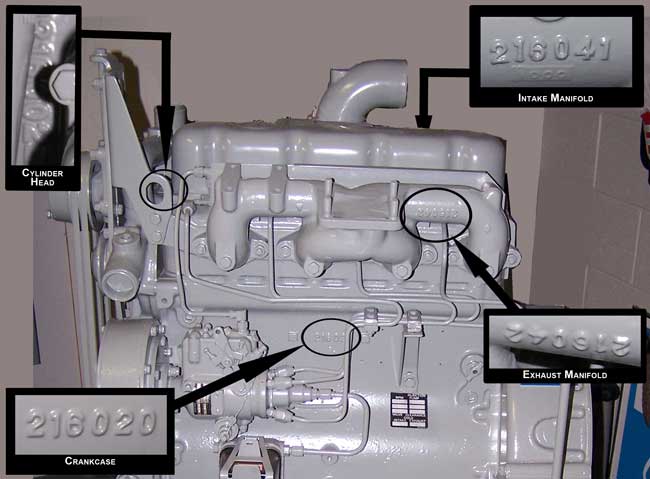

Found this picture on line

its down deep in that forklift icould not readthat tag or was able to get closeenought to the tag to clean it off  but it did have  number on the block  the valve cover , injectors , exauhst manifold look like the picture .   having no luck finding a d436t engine listed any where .    will those other numbers apply ? i can find those out monday

Those numbers are just casting numbers and I can't say they are totally specific to the D436T.
Sometimes they ask for water pump casting numbers if an engine used several different pumps, I don't know on this one.
Find a way to clean the engine tag if its there, a stick and a rag, something. Try reaching down and taking a picture of it, I've had luck doing that in some cases.
