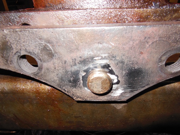

#2 - The hole in the front pivot bracket seems to be worn and elongated.  Is this elongation part of the normal design?  If not and normal steering would be affected, should I try to weld a bearing in the elongated hole to tighten things up?

I used carbon rod to fill the hole so I could fill in the lost metal with a welder.... that was on my WD. Don't know where to get carbon rod and more..... old fencer batteries used to have, I think 7/8" rods in them.

My neighbor used his mig and filled the elongated hole with welding wire.

I have a worn rear pivot in a D17 Series 3 wide front end and was planning on building it up with weld and reboring.  Have never used carbon rod.  Do you insert this in the hole and build up weld around it?

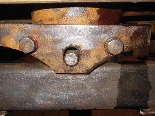

I used a 7/8" 3 point adapter bushing,welded it in, grind to fit length, then put a new bolt. that is what I done on the rear pivot on one of my WD's

No.  My neighbor said he just used mig welding wire build up.
