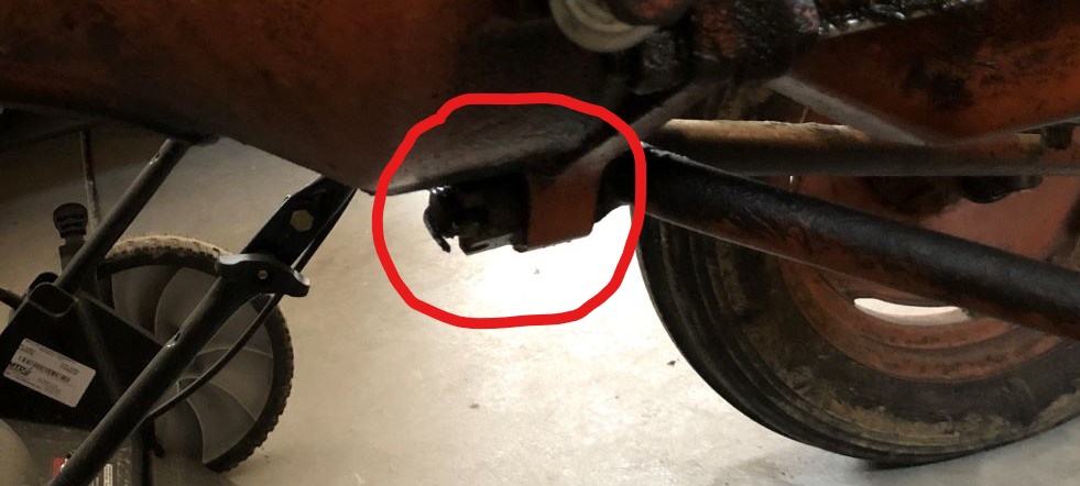

I've got an Allis C with a B wishbone wide front and noticed quite a lot of slop (~3/16") where the wishbone support bolts to the bellhousing (aka the rear axle pivot, I think), see image below.  Looks like whoever converted it to wide front didn't have the bushing...?   I've been unable to find anything that seems right through Steiners, DJ's, eBay, etc.  My measurements suggest I could drill out some 3/4" schedule 40 pipe with a 7/8" drill to make one.  Thoughts?  Any help is appreciated!

That should be a bronze bushing, part #210680. Mike Z had one listed in his NOS parts a few days back.

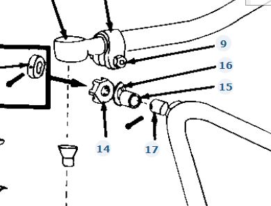

In looking at the Agco parts site, they claim B43220 & up had the bushing (15 in the image below; part# 210680). If I'm reading it right... That would mean it occurred during 1940 production, which aligns with my situation.

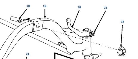

I sent you a PM to this effect also, but there is no bushing in the front pivot (per the Agco parts site again). Thank you for asking though! Hopefully you can find the pivot bolt (18) and collar (22)...
