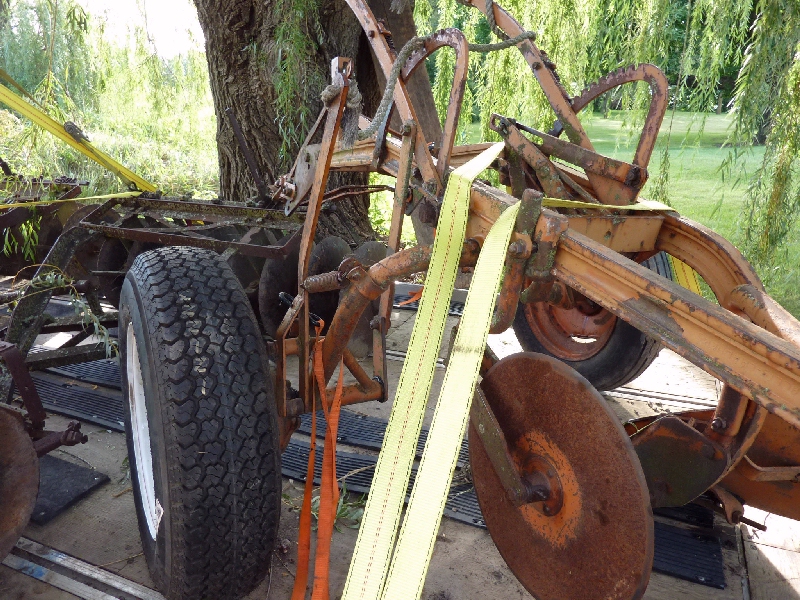

Planning on heading up to our hunting land and do a little plowing this weekend - just bought this plow and am wondering what the levers do?  I am guessing one has to do with how high it raises and one how low?  I figured I'd do the learning process on the field but then thought I should ask since I never owned or used a plow before.

About the new wheel & tire -  I could not find a used replacement tire for the left side so I thought why not drill and tap the hub to allow me to use one of my extra trailer tires ... just couldn't get the bolts to work in a 4 3/4" hub and a 4 1/4" rim darn! But it worked great so I decided to go ahead and do the other side too before I hauled it up to the hunting land, that way I have more options if it does go bad.  Equipment will be sitting outside and I know that is hard on tires.

both the levers control the depth, one for the right side and one for the left side of the plow. Once you get these "set" you normally dont adjust them while plowing. And the lever with the rope attached is for lifting and lowering at the ends of the field. you will also have to adjust the hitch for your left to right distance so it follows correctly

I have got a plow just like that I pull with my WF, start point for levers can be about half way up the notches and adjust from there, that is where I start in wheat stubble but also depends a lot on your plow shares.

The one on the left facing front is the depth lever.  The one on the right is the leveling lever so that the plow runs level.
The lift is the rope.  Keep moving so that it lifts the plow clear of the ground.
I believe you move the drawbar so that the hitch is in line with the center of the left facing front plow.

I'm new to this plowing thing myself. Our ground was in pretty good shape, so all we did was disc it up and go. I just bought a 2-14 plow from Glenn. If I ever get it down here, i'm gonna try to get some ground into shape over at my son's place. I know that you have to get the plow set laterally so that it "tracks" properly behind the tractor. I know you have to level mounted plows so that they run level when the tractor is in the furrow.(one wheel in furrow, one on land side). Not sure if this is the case with trailer plows, because they are not "mounted" to the tractor, but I think that is where the depth levers come in. Left plow bottom would be lower than right bottom when sitting on flat ground, but level when plow right tire was in the furrow after the first pass. Technically, I guess you would set both bottoms the same height for the first pass, and then set the left plow to level with the plow in place, tractor right wheels in furrow. Then it should be a case of setting the depth that the plow and tractor would both be happy with. That's as far as my guesswork gets me. There may be more adjustments to make to get the plow to "suck" in like it's supposed to. I know the coulters should be set in line with the left leading edge of the shares, so that they cut the crust for the share so it rolls the top of dirt over. I am learning on this as I go too, so someone come in and tell us newbies how it's done.

For tracking, you want the left side of the front bottom exactly the rated bottom width from the inside of the right rear tractor wheel. You find the rated bottom width measuring at exactly right angles to the plow beams, center to center on the beams. That way both bottoms cut the same and the rated width.

Maybe an example will work. You want the landside of the front (or right) bottom to trail one bottom width left of the inside of the tractor's rear wheel that you run in the furrow. So if its a 16" bottom you want that distance to be 16", 14" for a 14" bottom and 12" for a 12" bottom. If you don't know the bottom width, you measure between the centers of the plow beams to find the bottom width.
Sometimes you adjust the drawbar and the hitch, sometimes you adjust the tractor wheel spacing. Its nice if the trailing plow hitch is at the center of the tractor, then it would pull straight, but thats overly nice because the wheel in the furrow grabs better than the wheel on the stalks most of the time. Fortunately the front wheel on a wide front tractor is also in the furrow to straighten out the tractor.

OK, got it now. What you're saying is you want the plow set to plow the correct width when the tractor wheel is in the furrow. Setting it that way assures that it plows the top over the wheel tracks in the furrow, doesn't leave any unturned land to the right, and plows the full width. I think it's gonna take me a long time to get mine set up right.LOL!

It pulls easier if the front bottom doesn't do a full width cut, but it might not fill that furrow full. It pulls harder and probably will still roll over if you cut up to 2 or 3 inches wider but that will more than fill the furrow.
You just set that distance by the inside of the tractor wheel and the drawbar, and go. There are other adjustments that take more time, the tilt sidways and front to back to get both bottoms the same depth and the plow going in instead of refusing to plow.
