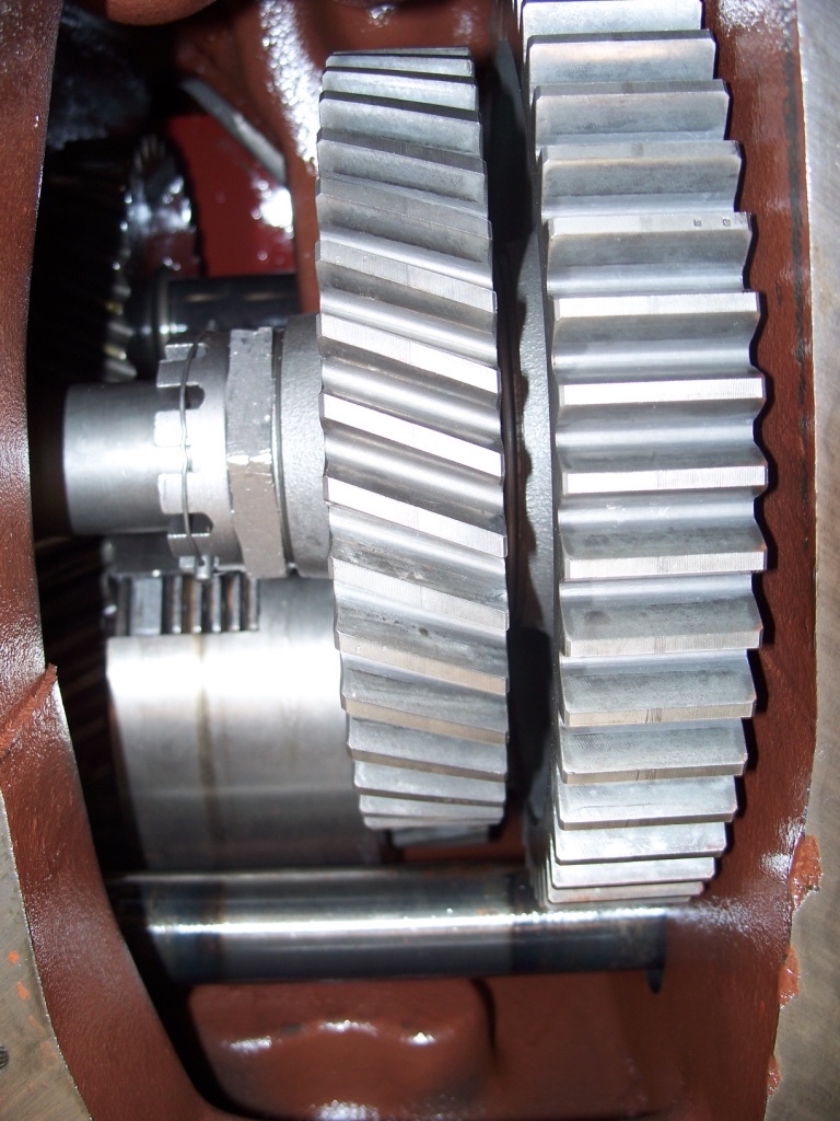

Here is a picture from previous post I did on a dual pto install.  Manual says to tighten that nut 20 inch pounds more than turning torque.  Mine checked out at 185 inch pounds turning, so I tightened it down until it went to 205 to 210 inch pounds.  Make sure you install the lock pin with new wire also.  I would not over tighten it.

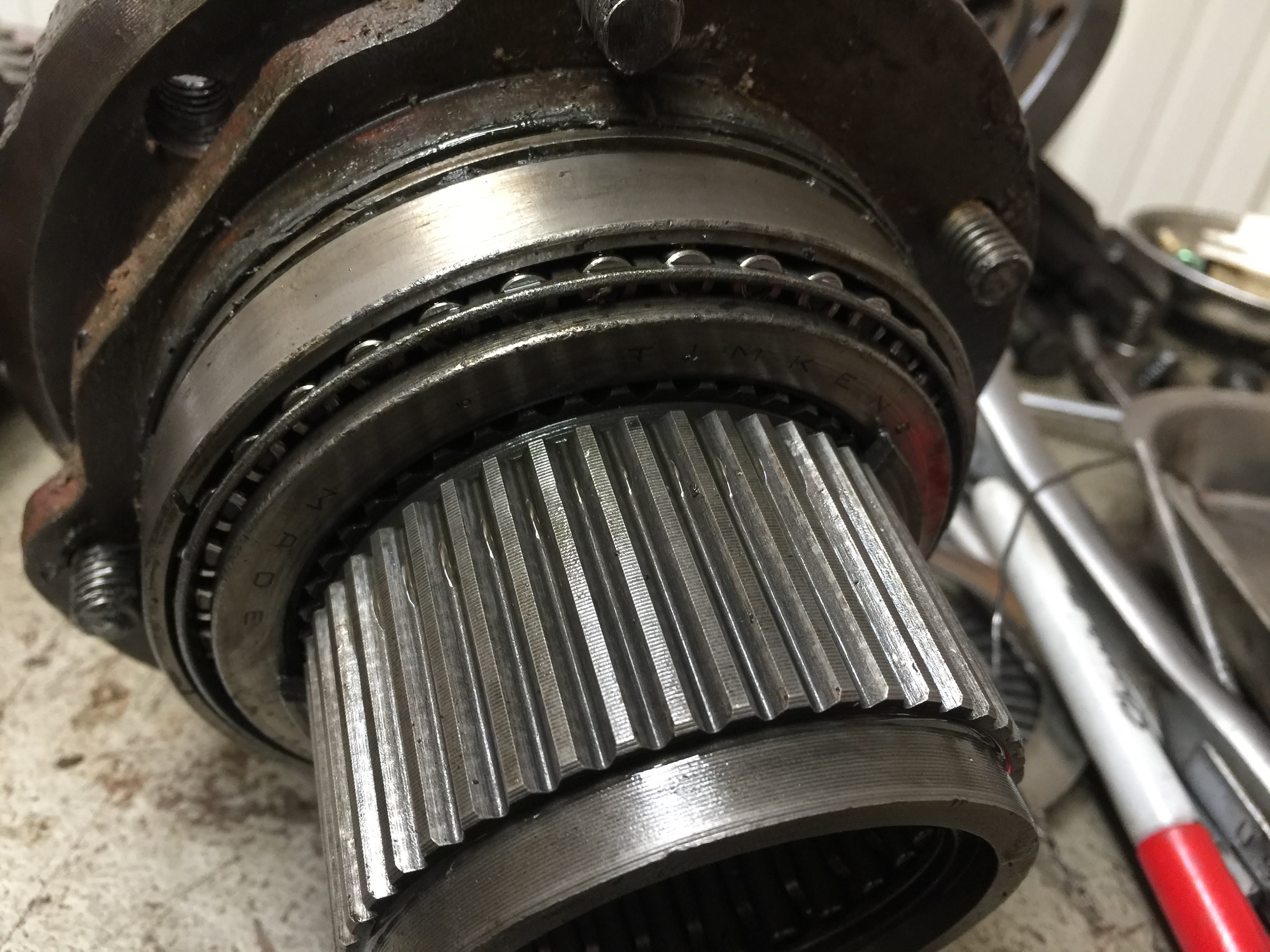

Here is a look at the hub Mack, Everything looks normal to me.

It would have to be on solid shaft, not hallow shaft.        MACK

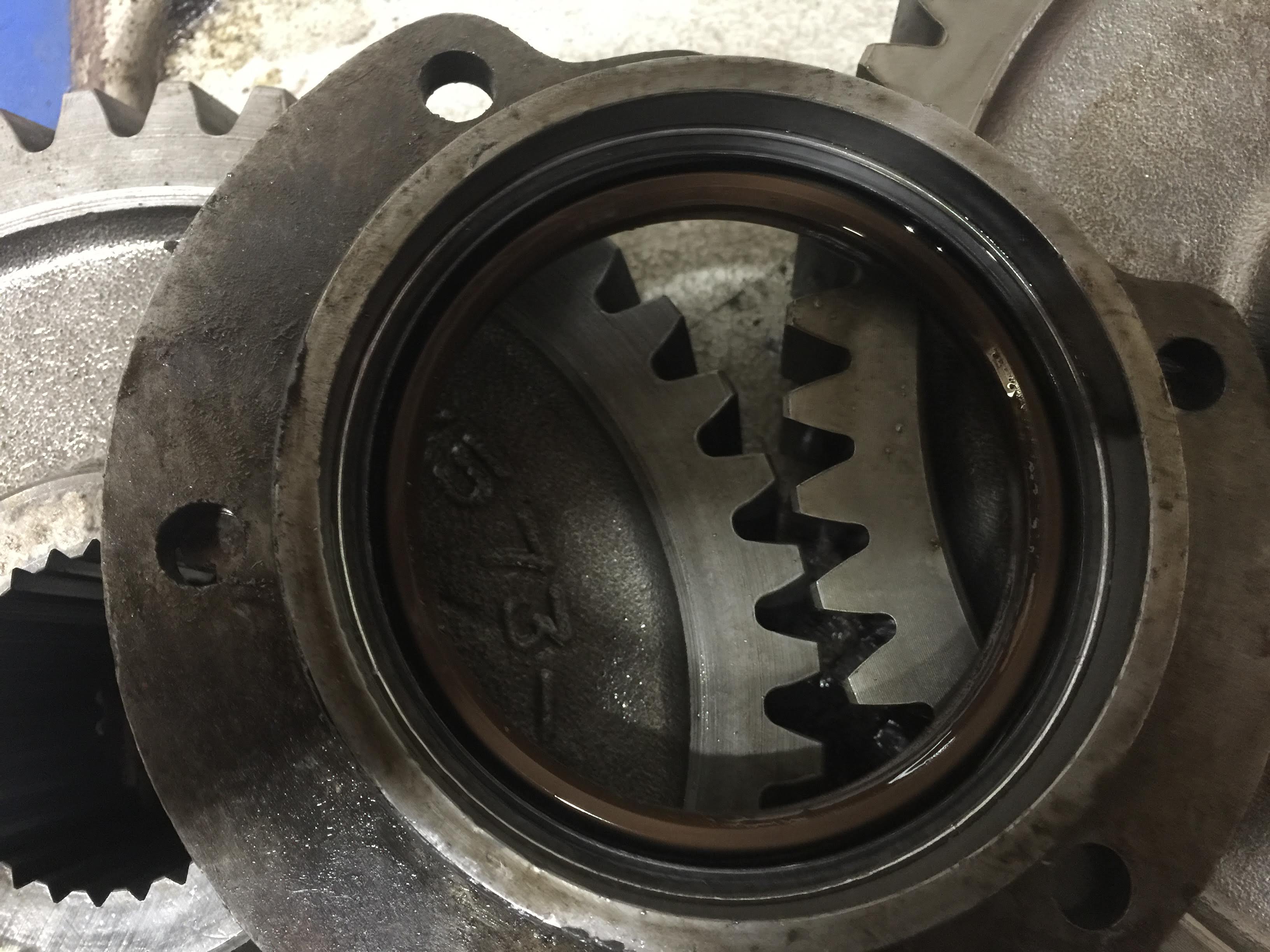

Was wondering if it would be wise to re use the old big seal that I just installed this spring? Or should I just bite the bullet and replace it again? looks fine, but it is $50 through Agco.
