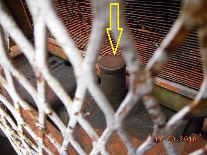

This photo is of a D14 with power steering but yours should look the same.

Post Options Post Options   Thanks (0) Thanks(0)   Quote acwd45ca Quote  Post ReplyReply Direct Link To This Post Posted: 15 Dec 2019 at 11:17am
Thank you for the picture. This clears up a lot. I am looking in the wrong place. The tractor was being used to bushhog  a pasture when a small tree punched a hole in the bottom line hence the leak. Need to get fluid in it to get it to my fix it man to patch the line.
