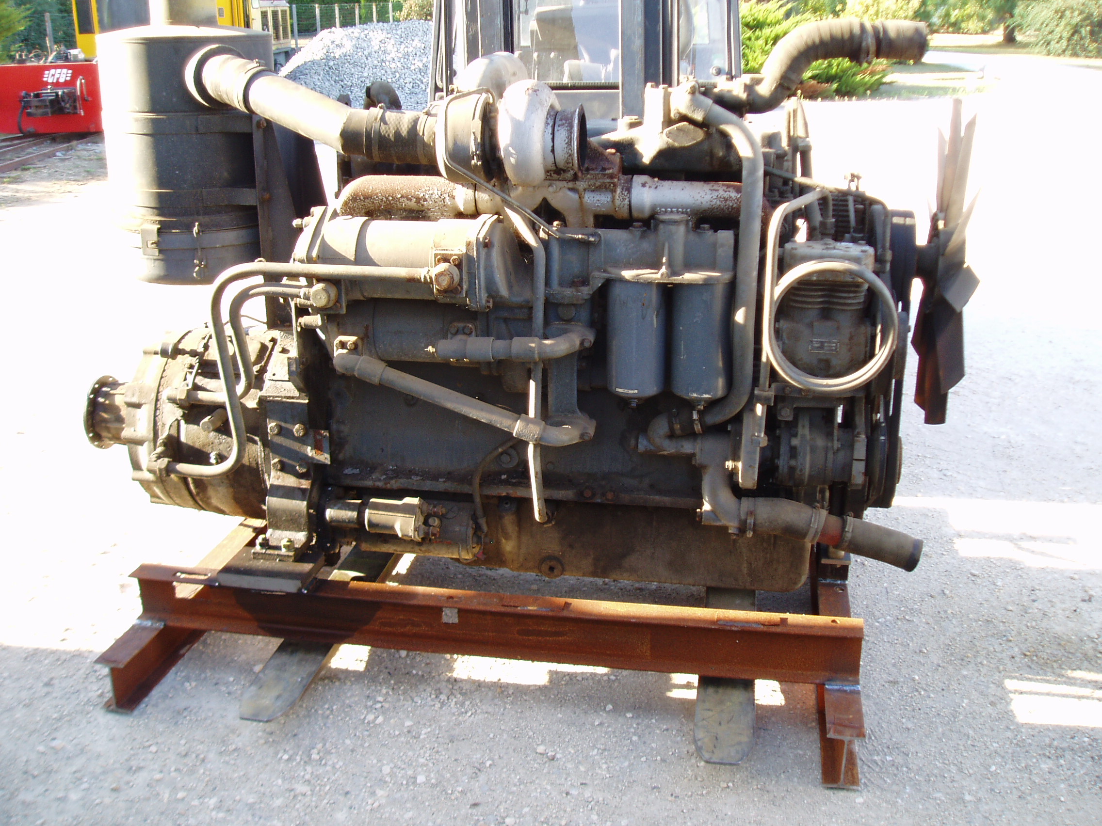

Post Options Post Options   Thanks (0) Thanks(0)   Quote DIEMA185 Quote  Post ReplyReply Direct Link To This Post Posted: 05 Dec 2019 at 11:38am
The engine before general overhaul:

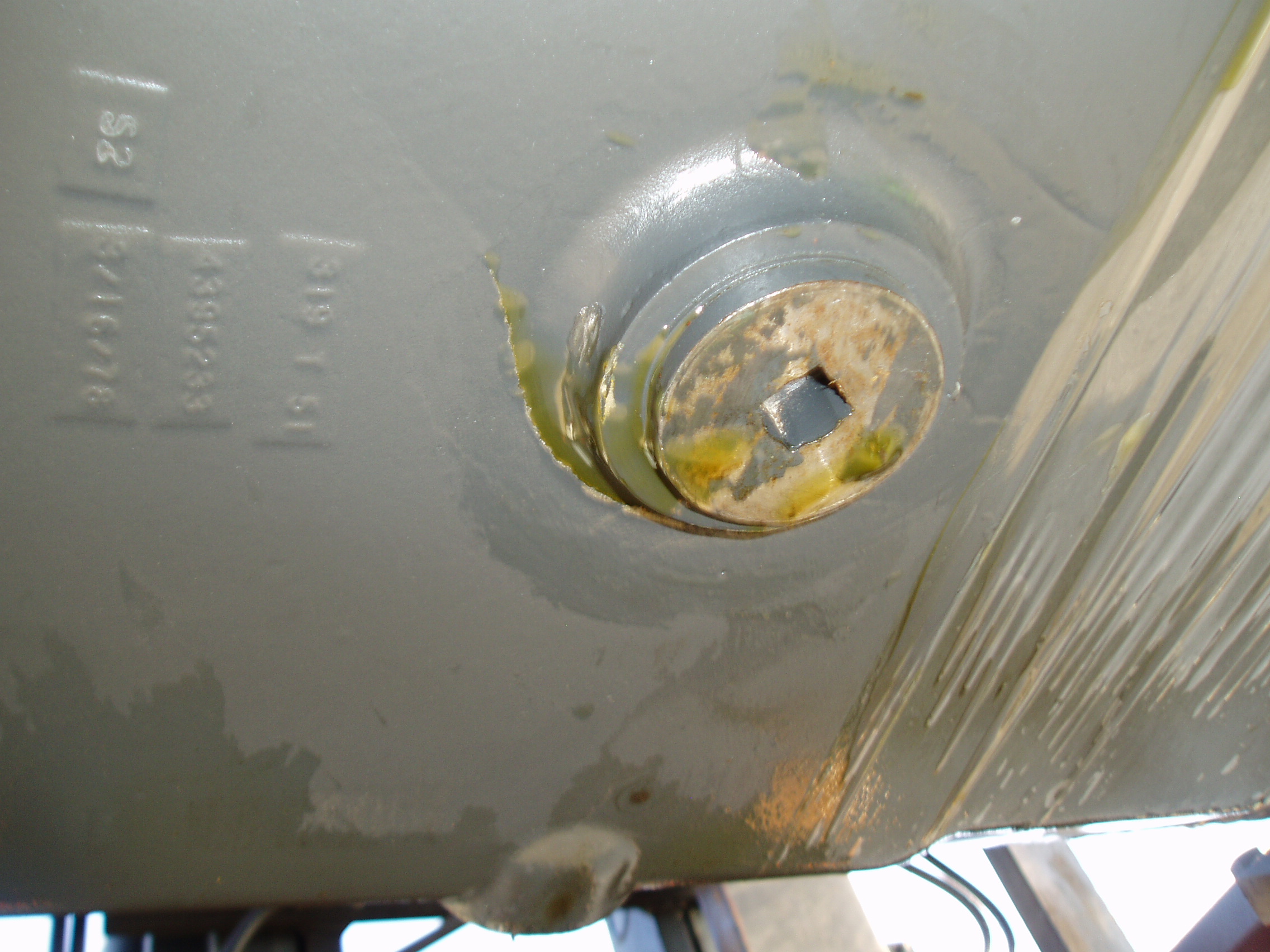

Post Options Post Options   Thanks (0) Thanks(0)   Quote DIEMA185 Quote  Post ReplyReply Direct Link To This Post Posted: 05 Dec 2019 at 12:40pm
Casting numbers seems to be different:

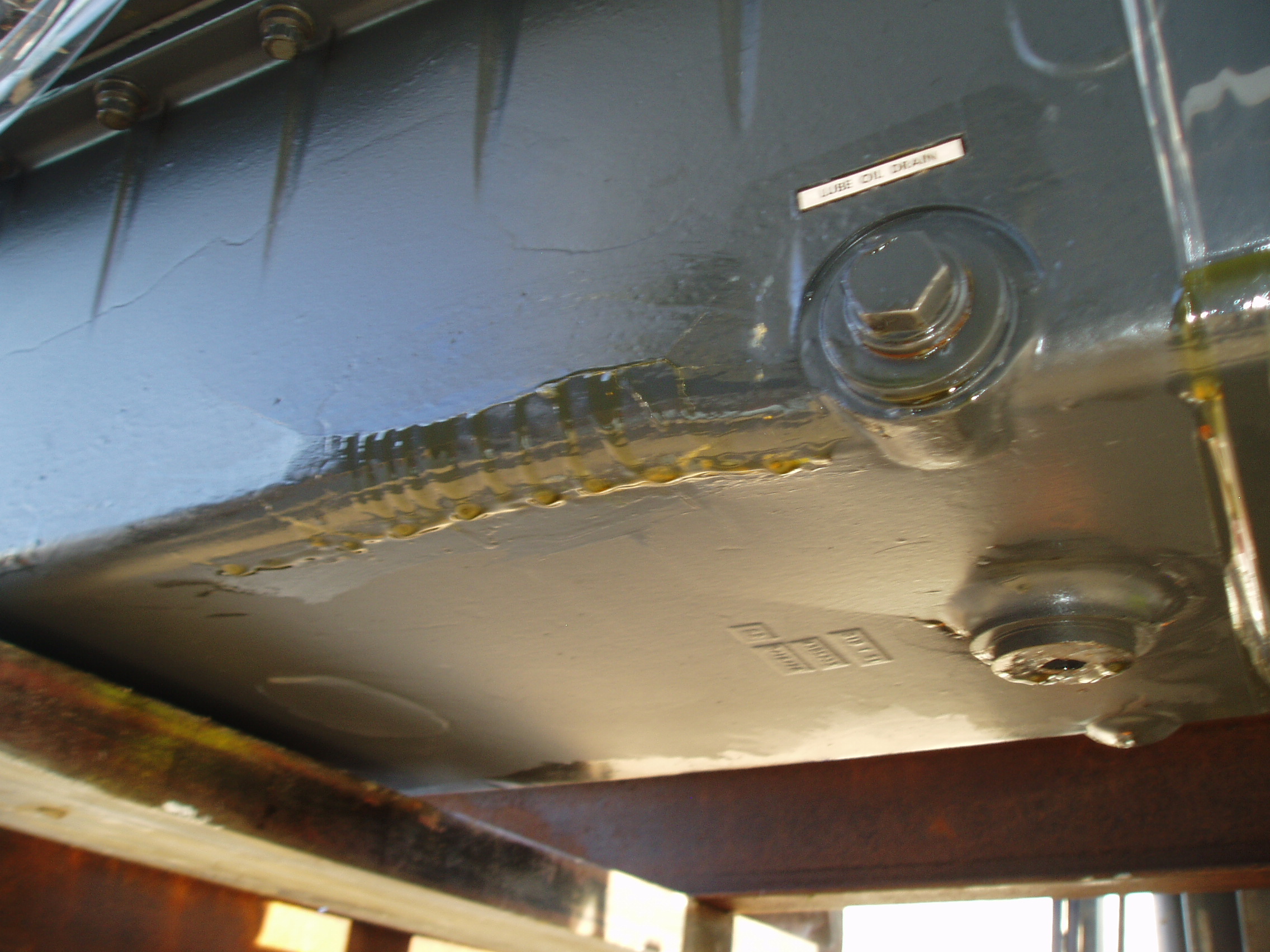

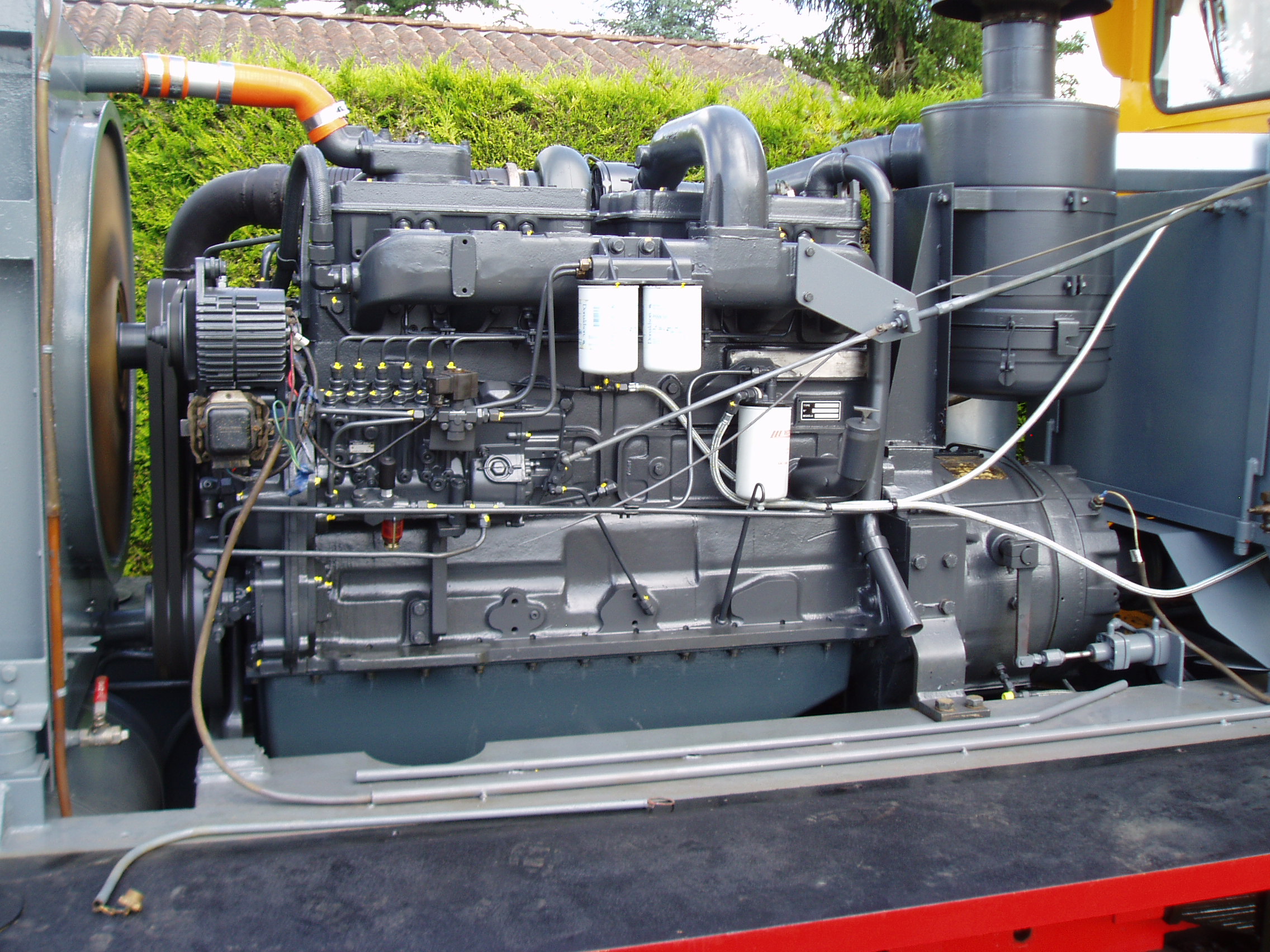

Post Options Post Options   Thanks (0) Thanks(0)   Quote DIEMA185 Quote  Post ReplyReply Direct Link To This Post Posted: 07 Jul 2020 at 11:13am
The engine is ready after a complete rebuilding.
I finally didn't find any oil pan, so we do a new one (casted)....
By the way, the engine make some smoke until the engine working temperature of 80-90°C is not attempt.
What do you think about?

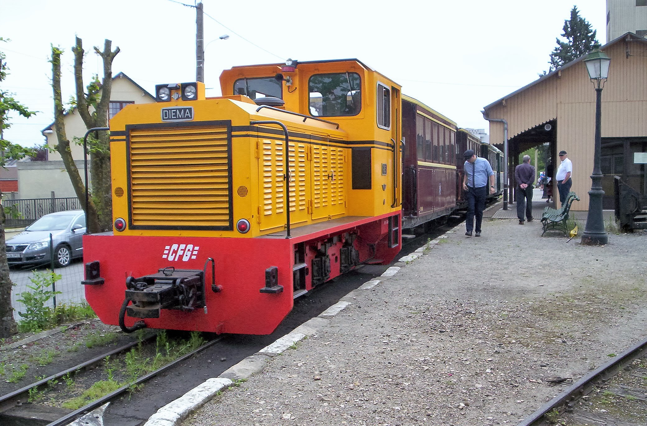

Post Options Post Options   Thanks (0) Thanks(0)   Quote DIEMA185 Quote  Post ReplyReply Direct Link To This Post Posted: 08 Jul 2020 at 10:57am
Thanks for the info ACJACK....
For John, the locomotive is used on a tourist site/railway:
HD6GTOM View Drop Down
Joined: 30 Nov 2009
Location: MADISON CO IA
Points: 6627
Post Options Post Options   Thanks (0) Thanks(0)   Quote HD6GTOM Quote  Post ReplyReply Direct Link To This Post Posted: 08 Jul 2020 at 6:32pm
I can't help with the pan, but want to thank you for posting a picture of the locomotive. We enjoy all pictures from around the world.
