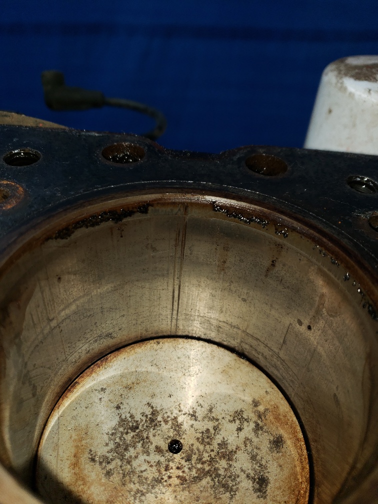

SO I finally pulled the oil pan and am planning to pressurize the cooling system to find my leak when I decided to just take a look up at the bottom of the sleeves. there on no.1 and 3 were very obvious drips of coolant. So then I pulled the head to look/inspect the cylinders and pistons and I find a fairly deep score on number 4 and some dents on top of piston # 2 guessing the Allis had been worked on before the question I have is would it make more sense to get a in frame overhaul kit considering I could only get 90lbs of compression out of this engine plus or minus 5lbs on each cylinder. or just replace the O-rings for the liners. I know that sure if money is no object I would overhaul everything but as with many things in life I need to weight the pros and cons. Just looking for your 2 cents I am also wondering what the SP stamp on the top of the piston means.

Did you check the frost plugs in the head for pinhole leak/s? Just wondering.
WF owner View Drop Down
Joined: 12 May 2013
Location: Bombay NY
Points: 5179
Post Options Post Options   Thanks (0) Thanks(0)   Quote WF owner Quote  Post ReplyReply Direct Link To This Post Posted: 03 Dec 2019 at 5:47am
I agree that you should check the core plugs in the head. It has been my experience that these are usually the culprit when there is antifreeze in the oil in these engines.
With that said, I would definitely replace (at least) that sleeve with the gouge in it. If money is a big factor, I have installed a used sleeve in a tractor that I didn't want to spend much money on. I have reused the head gasket, too (if it was in good shape). I know everyone is going to say do a complete overhaul, but I live in the real world where not everyone can afford to sink the money in an old tractor that they won't use very much.
Make sure to do a good job honing the sleeves. I would install new rings, new O rings on the sleeves and have the valves done.  You may have to buy (or make) new shims. New cam bearings will only cost about $30. Use plastigauge on the main and rod bearings.
Good luck !

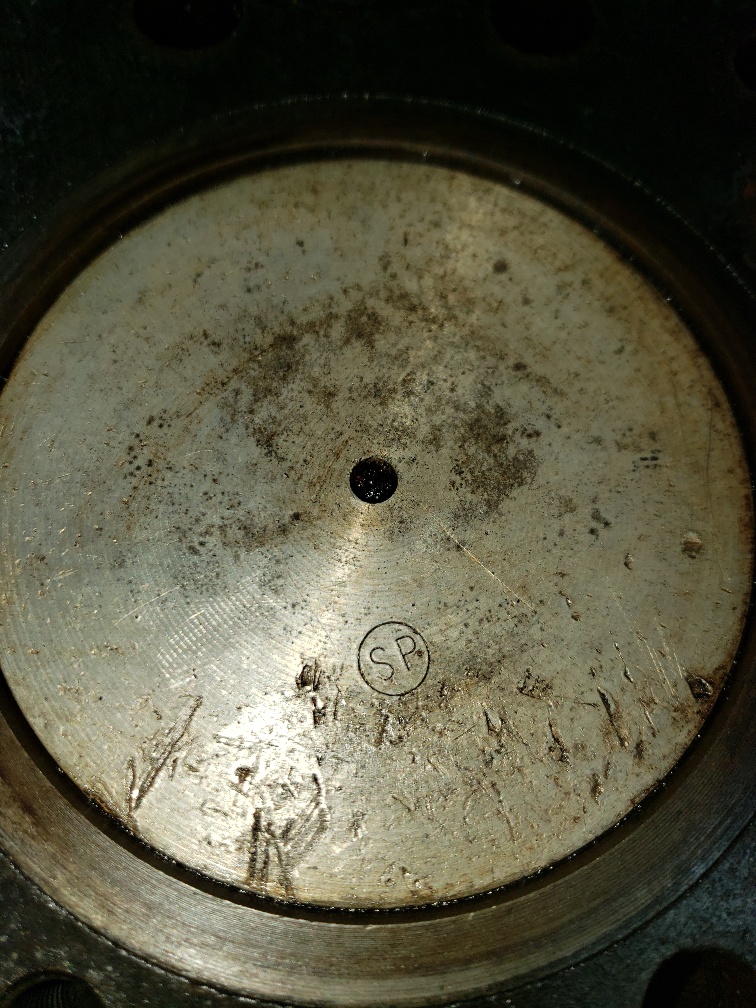

Might want to go with used sleeve/piston,--because a new one could add more strain on the crank. ---Its always best to try to balance the crank as much as possible. ----NOTHING wrong with used!! -- Been there, done that!-- even re-used gaskets, and made some of my own. -- It can be done and will work. --Main thing is to clean all of the surfaces real good and make sure all traces of o-rings, gaskets, sealer, etc. is removed. Just my 0002.
Not sure what the sp stamp means, have seen them before but never checked out what they mean!
Edited by ac fleet - 03 Dec 2019 at 3:12pm
Points: 55189
Post Options Post Options   Thanks (1) Thanks(1)   Quote DiyDave Quote  Post ReplyReply Direct Link To This Post Posted: 03 Dec 2019 at 5:45pm
SP would be sealed power pistons, a trade mark of Federal-Mogul, would be my guess.
With 90 PSI compression, I would go for pulling the liners, re sealing, re ring the pistons, since you'll have them out, anyway.  When you are re-assembling, Use some plastigage to see the clearances on your crank bearings.Wink

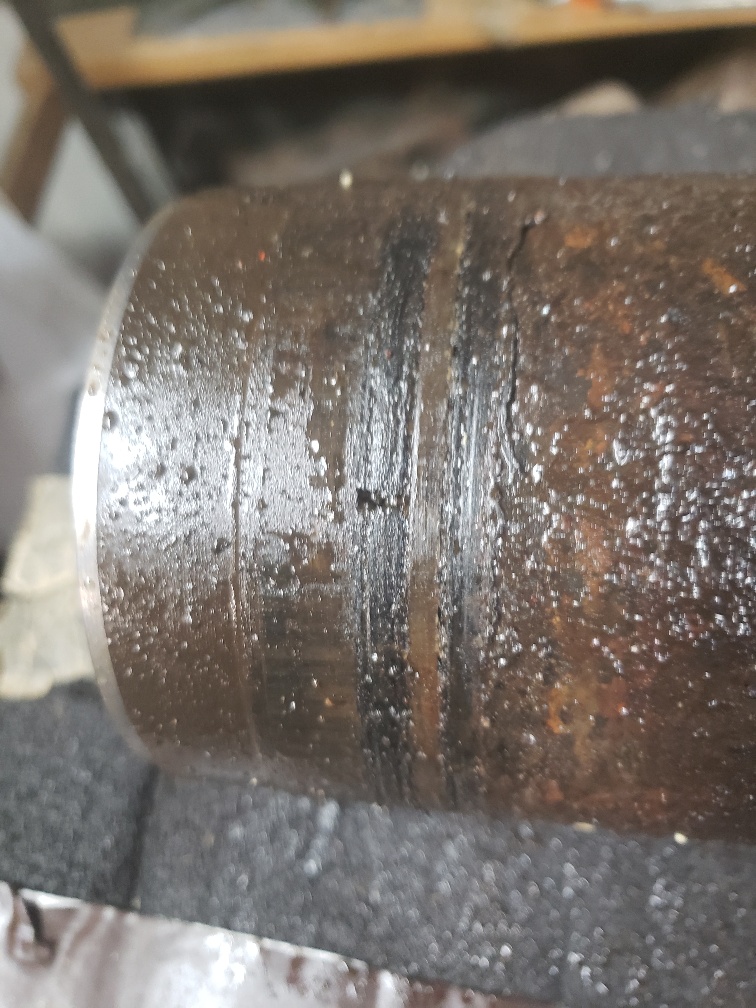

groove in a liner is not good.......... BUT........ that being said, I have opened several of these motors, pulled the liners out.
--new O-rings on liners
--hone the original cylinders and reinstall
--new piston rings
--new gasket set
--lap the valves for a better seat
--replace the freeze plugs on top if the head.
when the liners are out, look at all the CRUD in the water passage... clean and wash that out.... verify that the crank and cam are " not too bad"... you can be a little out of spec and still get by... its RUNNING NOW, RIGHT ? ... anything you do will improve quality... it don't have to be NEW or EXPENSIVE.

Since it appears the pistons might not be STOCK, pull one out and mike the diameter to see if it is 3-3/8 or 3-7/16 diameter... also measure the ring height or thickness.... I bought a set of "RINGS" once and the motor had M&W pistons in it... they would not fit.. Some rings are 1/8 inch, and some a 3/32 inch thick.

You can't get a drip from the bottom of a sleeve from a frost plug in the head!
Your going to need to pull the sleeves and install new O rings to stop the drips.
After pulling out the pistons and making sure a current ring did not cause the score I wouldn't worry about it. Most likely looking at the color of the score it was done with a different piston. No way to know without taking it out and looking, Honing enough for a cross hatch should get you back running without breaking the bank. I doubt that score will cause it to burn a bunch of oil. If you decide to go this way be sure to check ring gap on the rings square down in the sleeve. I square a ring in the hole using a piston to push the ring some.
I assume your not wanting to dump a bunch of money into a new kit if you can get by without or you wouldn't ask the way you did.

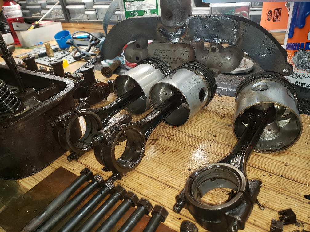

I agree with your assessment I pulled the piston out tonight and saw no ring damage to indicate scoring of the cylinder wall but I did see the rod bearing is in bad shape which tells me someone in the past may have pulled this motor apart and just replaced the piston and rings and left the bearing as is. I am also in agreement that you can't get drip in the bottom from a frost plug. The service manual says end gap of .007-.017 not sure what land clearance is if you or someone could advise me on that it would be helpful.

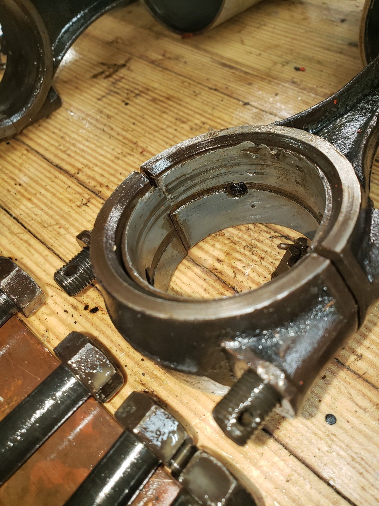

That bearing is ugly but it's just the soft metal buggered up. What's the crank like? Slight scoring can be polished out but too much out of round will require grinding . Crank grinding is not that expensive and you would be buying new brgs anyway so just as well do it right? Maybe you could buy a good runner for less than fiddling with this engine.

That picture of the bearing is a good indication of what happens when you run engines with antifreeze in the oil. Now I would suggest to pull the crankshaft out because there is a good chance all the other bearings look similar to that. You seem to know what your doing so you may have decided on that already

That rod bearing looks like the rod was not orientated correctly when installed.
No way to have only one side of the bearing to be almost gone and the other side not showing much wear at all with the rod being installed correct.
look thru my pictures ay the link. The rods are offset. you can compare how yours were with my pictures. That my not have put your crankshaft out of round. Check the journals at 90ยบ places starting straight down.
You need that rod for being bent.

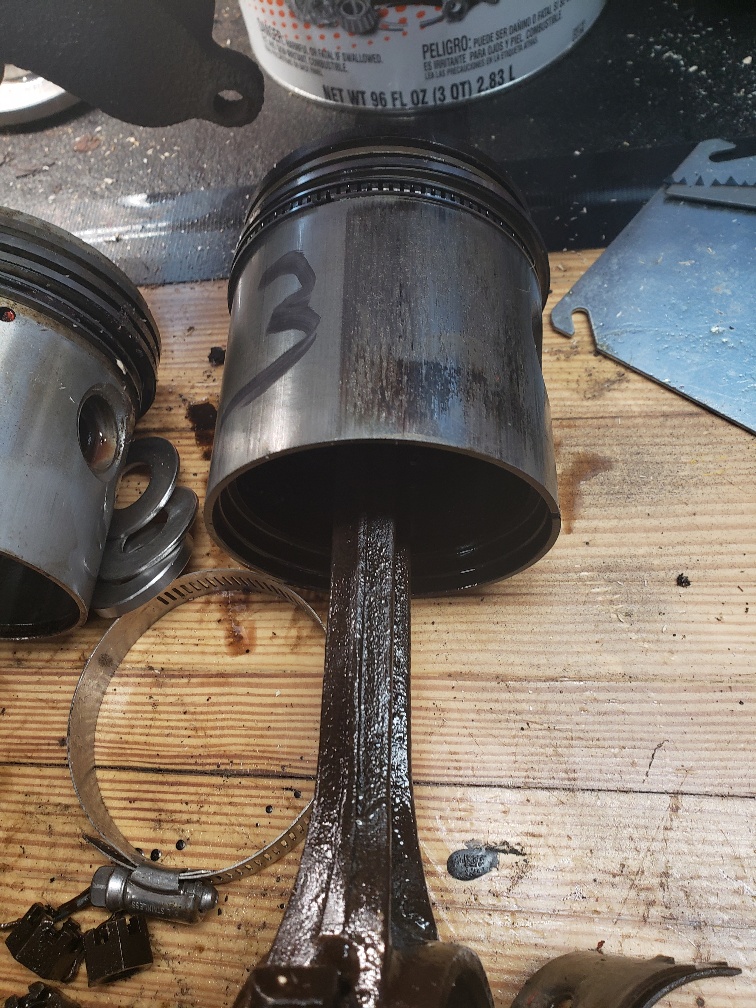

Last night I pulled out # 3 and it looks like a different piston even the oil ring is different from the others. rod bearing and crank looks good or at least go enough till I mic it. After work today I pull #1 sleeve which went really well with the puller we made. I did see the bottom oring had a gap in it. guess that had something to do with the leak. my biggest concern was if there was a crack in the block which I could not detect. I will have time tomorrow after work to pull the rest of the liners and then check the crank before I decide haw far I will have to go with buying parts.

The shop manual might have some details to help figure out the conditions and repair details:

That picture album was of rebuilding an engine with all in spec used parts. New rings and bearings. I did this to show that it is not always necessary to throw the bank on a rebuild. I did this ten years, nine months ago and have used the tractor with a Woods 59 under it every since to mow 3 acres of yard and mulch manure in my hay fields. It will fire up today as easy as it did then and does not smoke. The point is in spec parts will give you very good service for a long time. It is in the (DETAILS)

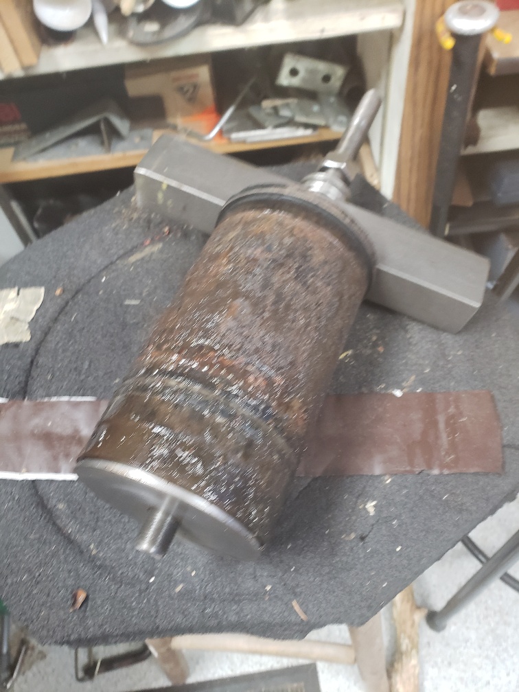

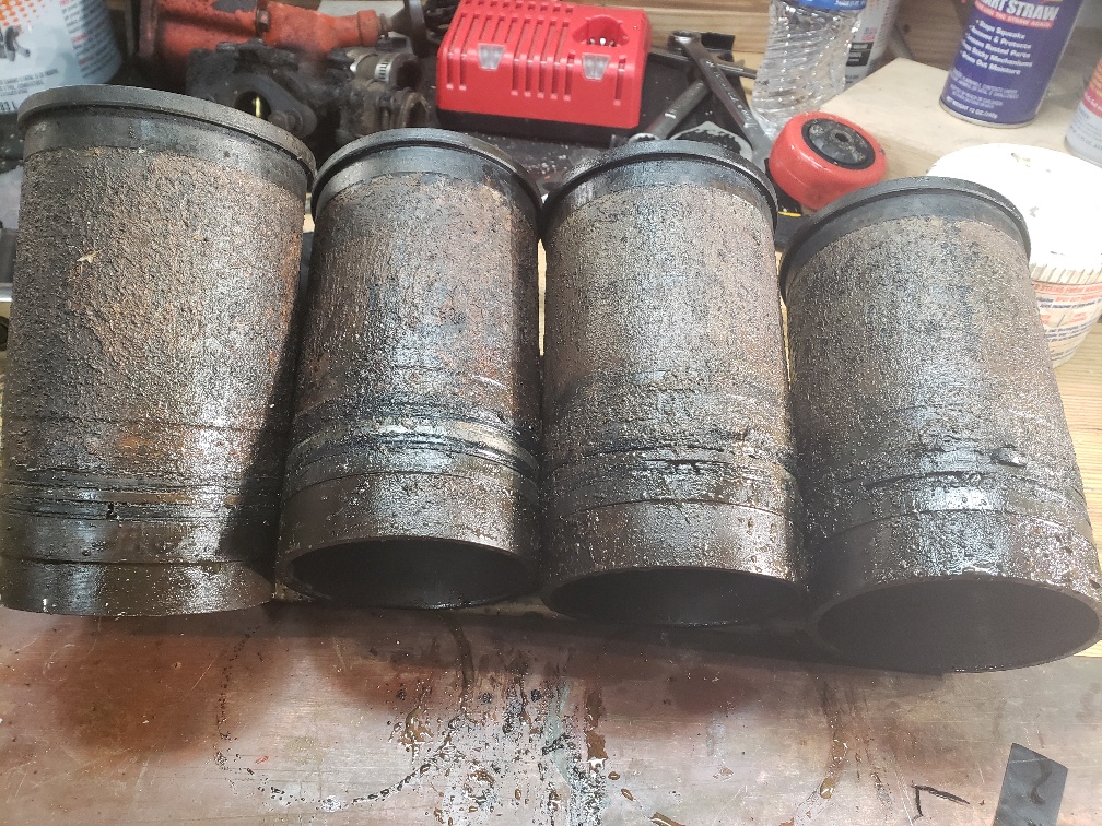

 Nice work pulling the sleeves! Yes that one o-ring is compromised. Hoping you dont have block issue. I think if you clean up the webs in the block you would be able to visually see cracks. They were obvious on the cracked block I had.
Your on your way.
I guess my thought on the rebuilds is that I will probably never have to overhaul the engine again so the cost of getting new parts is spread over a long time.
The things like mismatched pistons and new bearings lead me to think you will need a full kit with sleeves , pistons, rings, bearings, etc....

Today after work I was able to pull the remainder of the sleeves the fact that my plug for pulling the sleeves fit snuggly into the bottom of each sleeve gave me a clue all the bores were 3-3/8 and I did verify that with a gauge. After looking at all the sleeves two of the four had obvious gaps in the O-rings and all four look like they were 80 years old which i'm sure they are. After the sleeves where pulled and I covered up the crank journals and cleaned all the gak between the webs to inspect for cracks and to my surprise I did not see anything. I recently notice that the thermostat block and the lower radiator elbow with the peacock had been brazed. I am guessing because it froze at some point and cracked so I naturally was concerned about the block. The next step for me is to pull the crank and cam and check my tolerances.
