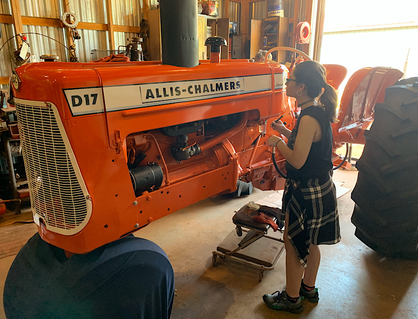

Chris...I think I’ve said before masking like you did is how I’ve done most of ours ,also which is how I did graphics on my race cars.However on the D17 we finished a few months ago I used soap/water in a spray bottle along with my daughter Harley because of the size and just the flippity floppity nature of the longer decals.The trick I found is not too much spray ,just enough to dampen whatever your applying the vinyl too...the more water ,the more ya got to squeegee out. Essentially the same technique when doing window tint.And a good rubber squeegee,nothing that will mark or deface the decal.
@BLee since you have a 185 with long but narrow decals you could probably do it with masking,especially if you have extra hands to help you if you’re not cool with soap & water. Just be for sure you put them on the correct side...I’ve seen some of the 100 series tractors that folks put decals on the wrong sides.And by no means I’m an expert either,this is just what I’ve found that works for me.
