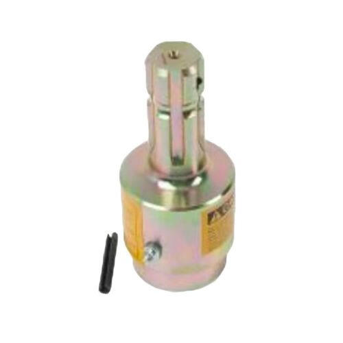

I'm trying to take a part off my D15" I think it's a extension or some kind of clutch it came with the tractor. I can't get it off. Any one know how to take it off.?

Is it mounted on the rear PTO Shaft ?

Is this it?  PTO override clutch.  If so, remove the fittings (or caps) and knock the roll pin out.

That's it Larry in NC Thanks for the information guys
