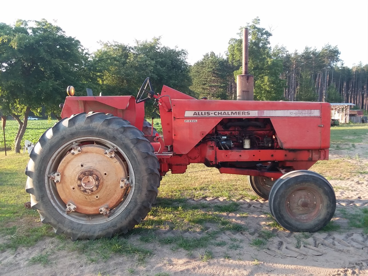

Picture is def a 180- looks like I mis-posted in 2009 - the tobacco special 185 was a late model - most had 18.4's but some had the 38" and even spacers for the rears. The side front axle option was what was special. The 6000 series also had the 96" front axle and spacers for the rears - used for vegetable and tobacco mostly.

I saw the ad for the tractor that 59f100292 is talking about. It actually has a very factory looking decal on the front of the side panels that says "Tobacco Special". It's factory black stripe with white letters and outline, like the Land Handler and Crop Handler decals. I couldn't really see anything special about it, but all the pictures were pretty up close. Has a loader on it.
