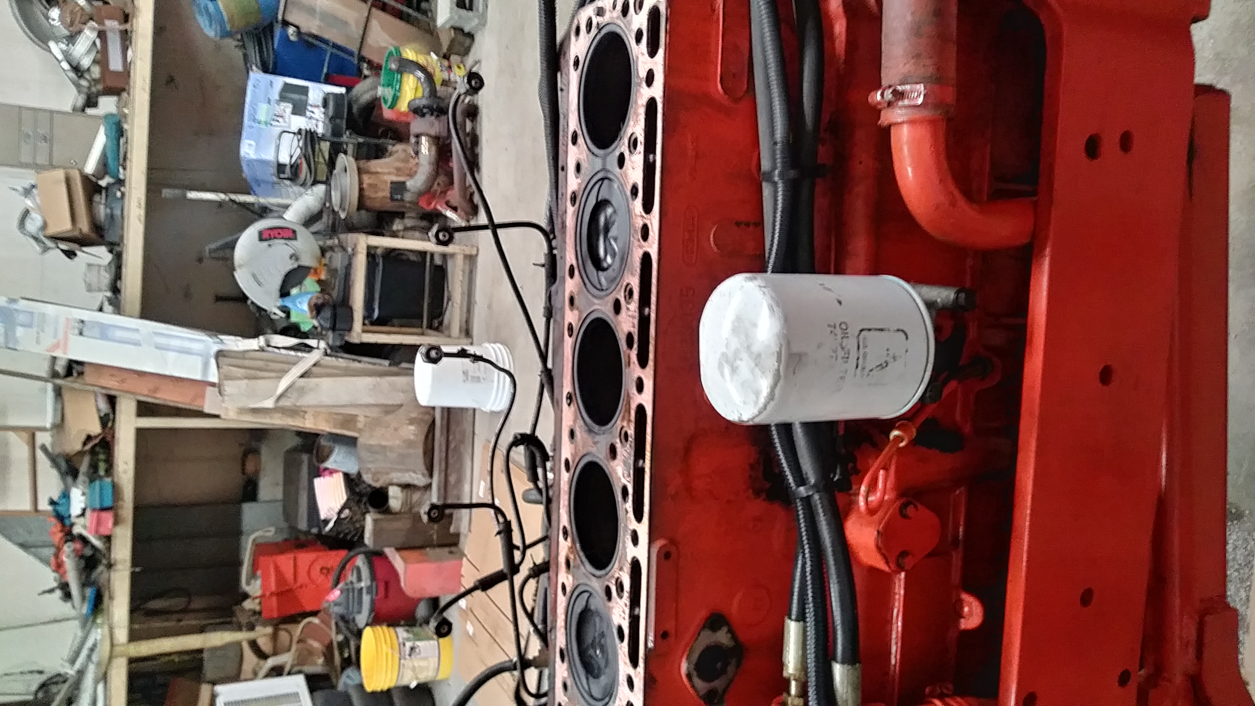

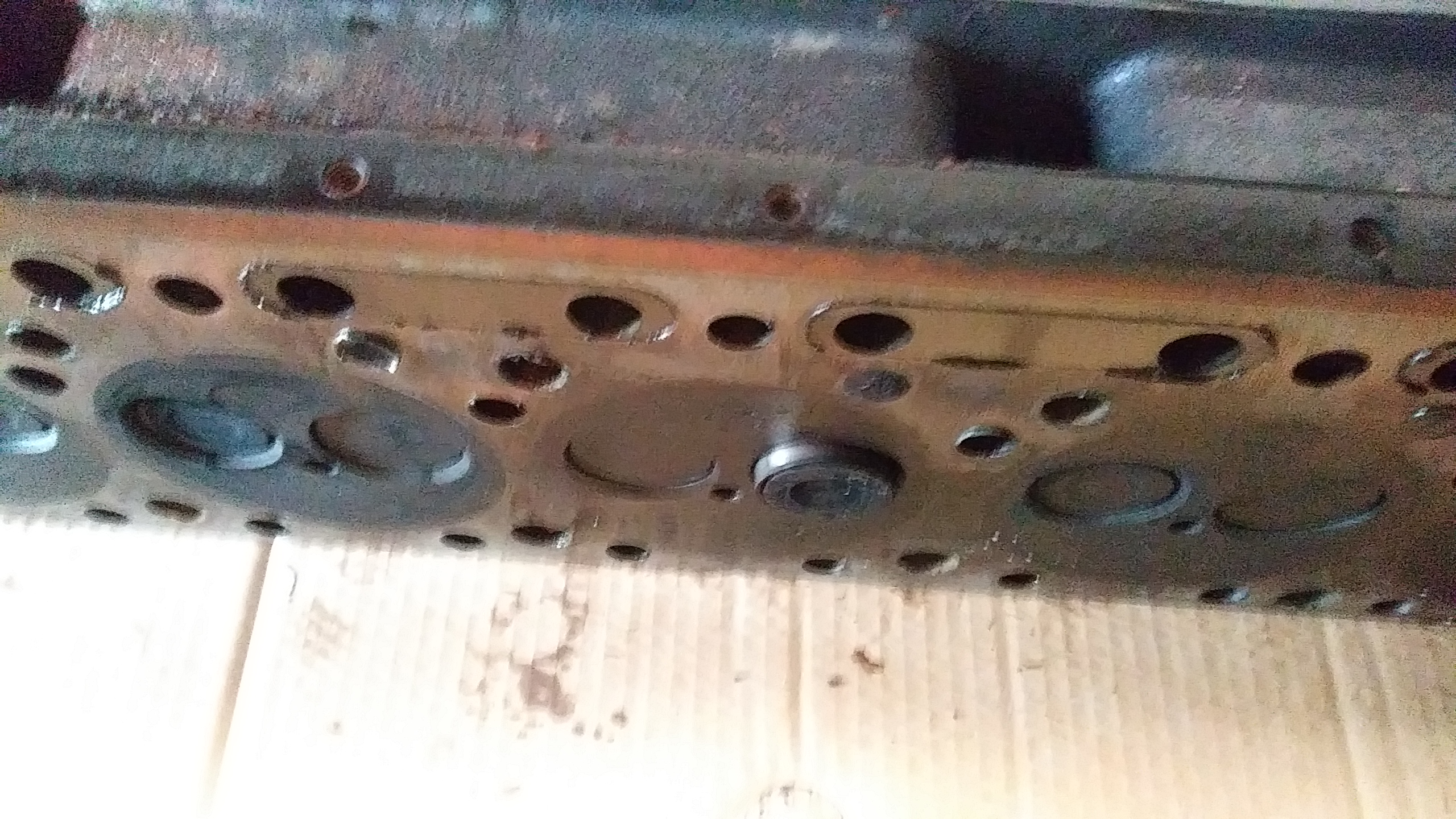

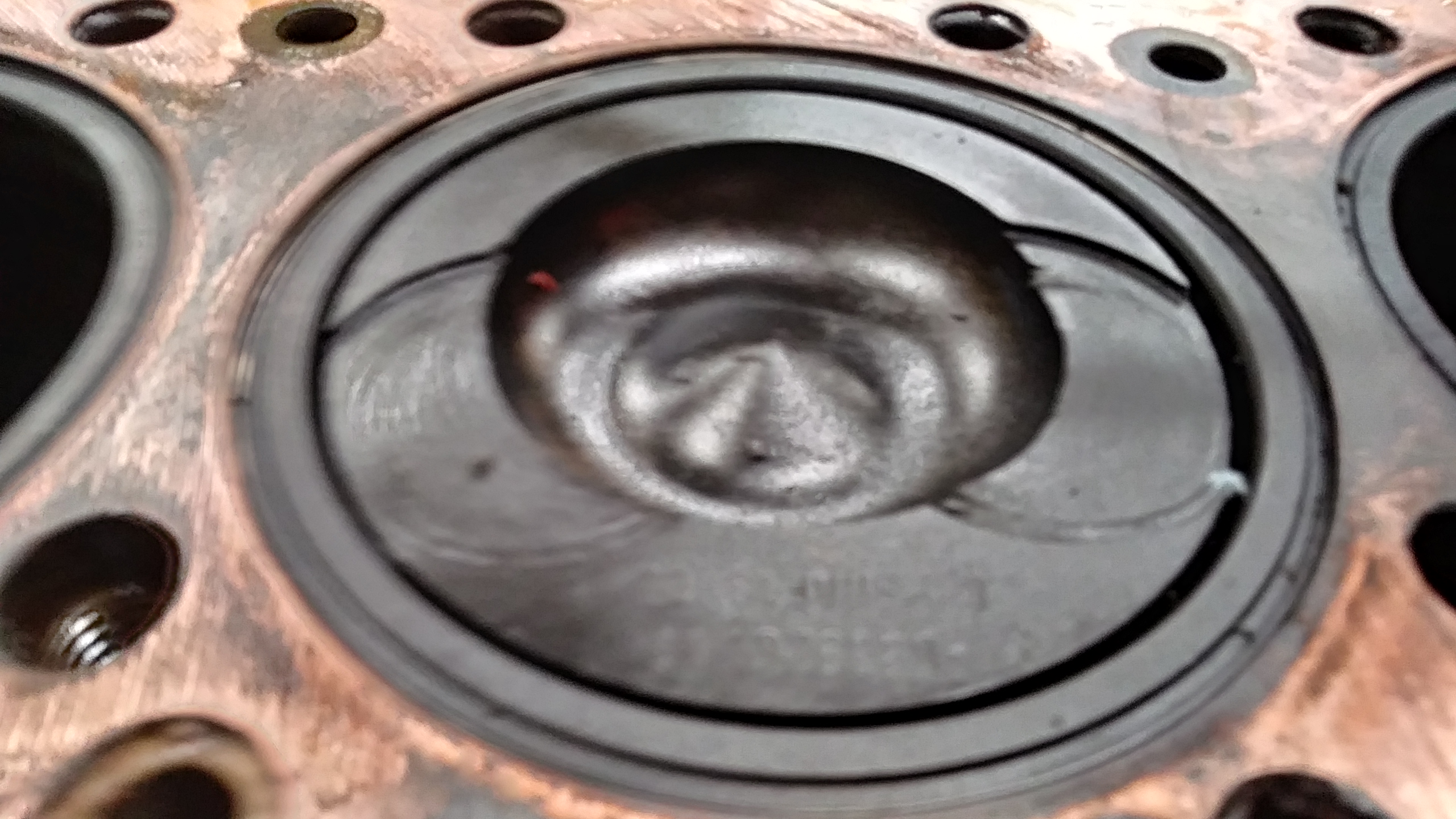

Pulled the head off the 190 XT puller this morning, its been blowing water out of the radiator after 30 seconds of running,found its got a copper head gasket already, I've been away from this for a bit= and guessing its a cracked head causing the pressure in the radiator,, also found a valve insert cocked in causing a stuck valve,, looking for options, buy another head and put my stuff in it, or send it to a machine shop , have it tested and welded? This tractor has a 450 pump head on it, valve cuts on the piston,,, its built for power

I would find a different head , take out the stock valves and seats , cut it for 426 valves, the pistons are already cut .
