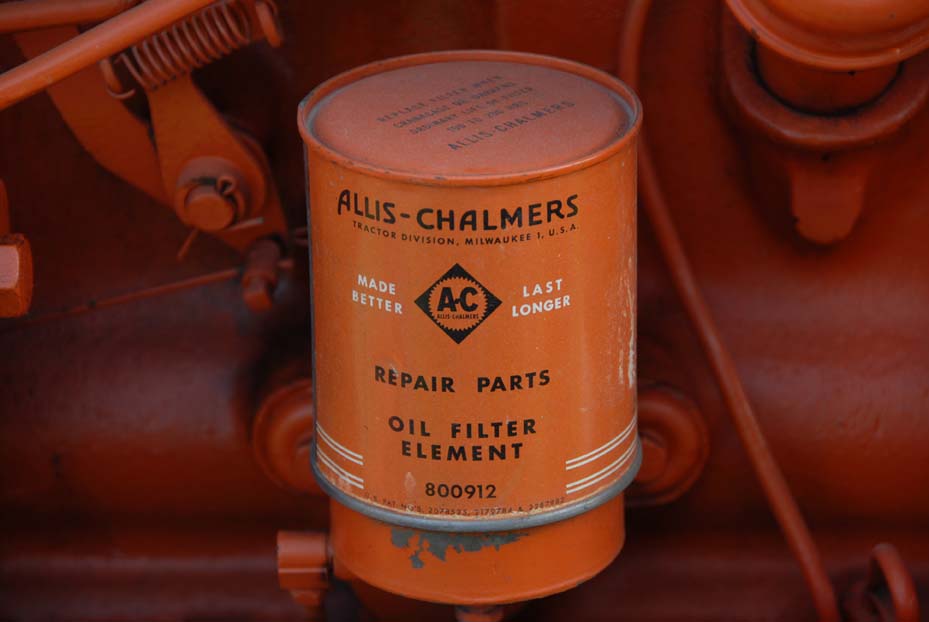

Can someone clarify the types of oil filters used on the Buda diesel WD-45, as shown in the picture? I see some with regular modern looking spin-ons and some with these, which also appear to be spin-ons... but a vintage type. Is this the type of filters used all through the WD-45 diesel era or are there variations.  This is on a 1955 WD-45D and a spin on filter seems quite advanced for that era.

The Diesel Used Two New # 70240912

Not like modern spin on but yes it does screw on. Most things back then used a canister which held the element.

Mainly wondering if this was the setup on the diesel WD-45 from day one to the end of production or if it appeared later?
Also, if it was a "first" or near to a first for a "spin-on" oil filter? From pictures I can access, it looks like it was a feature from day one but I have a couple of conflicting sources (not primary ones) that claim "spin-on" oil filters did not appear until 1957 tractors. Judging from pictures alone, that statement may be based on A-C tractors other than the WD-45D. My in house sources don't clarify this.
A spin-on filter seems a big deal to me in this era and forward thinking.

Maybe should think about design of the filters... and what classifies them as such. There are filter cartridges and spin-ons and spin-ons with rolled threads... Yea, you got a filter with very coarse threads on it, but a typical spin-on will have threads like pipe thread and the filtration is usually full flow where-as, the filter the WC-WD - WD-45 Diesel etc. had were by-pass filtration. The early D17 Diesel had a CLM filter. CLM stood for Cartridge Lube Metal canister style filter... and that was full flow.  The A, B, C, CA, G, RC, WC, WD, WD-45, D-10, D12, D14, D15, D17 (early) used a filter listed as a SMRTH filter. Spin-on Male Rolled Threads and were used in bypass systems.

My 34 UC uses the same filter. They've been around a while....
