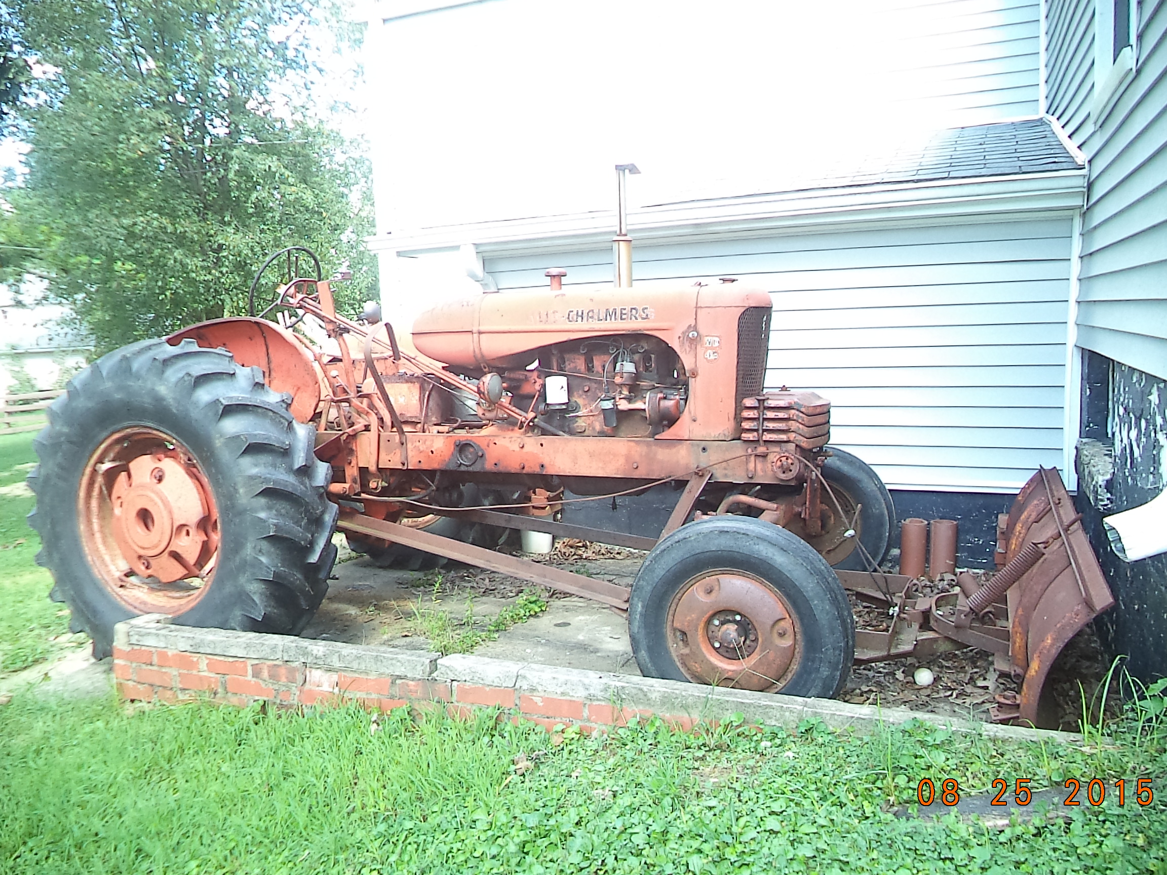

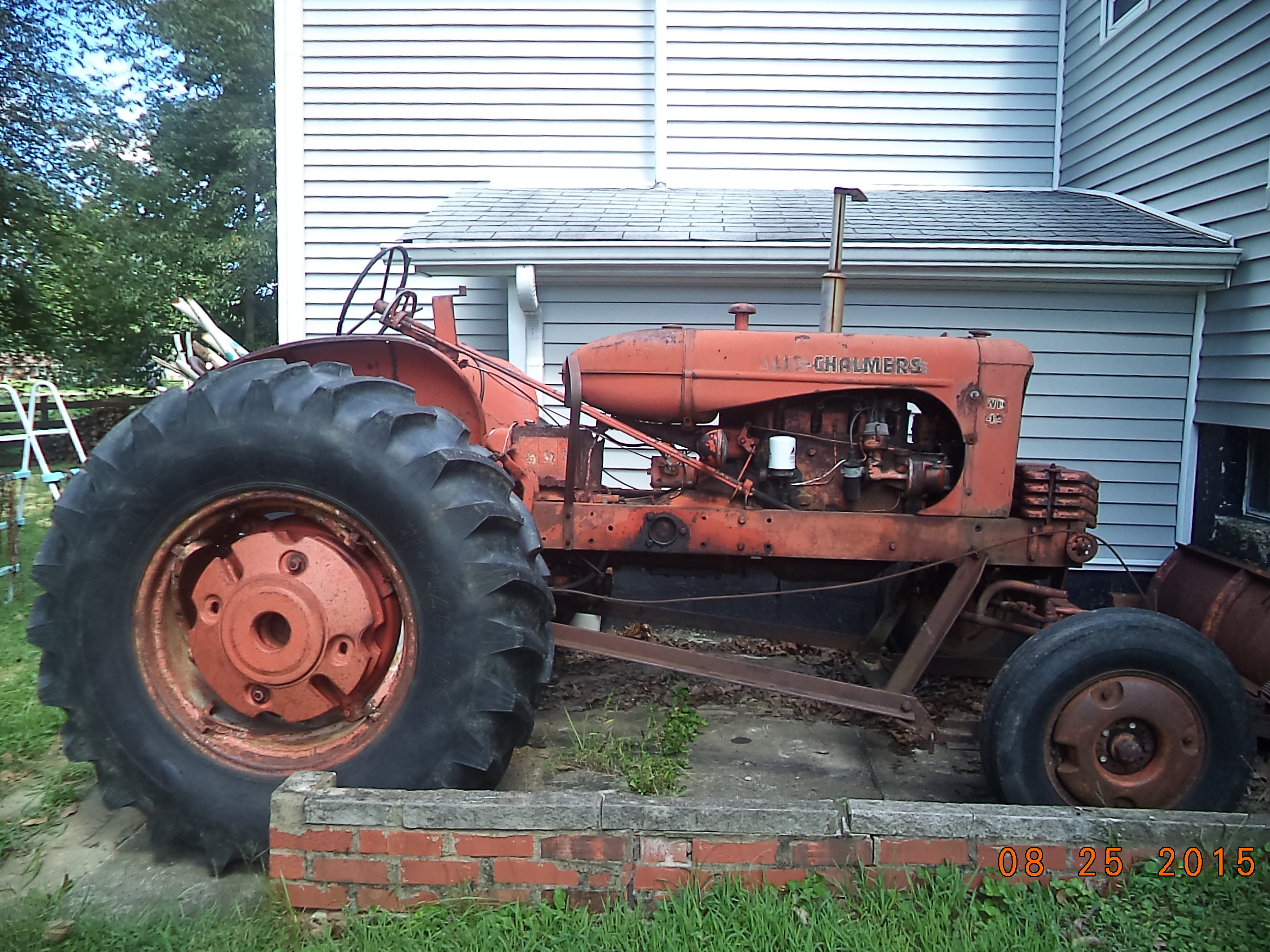

These pictures are from 2015. This tire is an Armstrong by Titan that Dad had bought at least 10 years prior to this. This tractor has not had the benefit of inside storage since this tire was put on and it has held up really well. It is just now in 2019 starting to show some small cracks in the rubber. He always asked for blems because of the price difference and we never had a bad experience with any of them on any of our tractors. Tire dealer will only sell/install/warranty blems that are cosmetic in nature. Structural blems are usually returned and not for sale to their customers.

Great pics Lionel and thanks everyone for the comments.  I've decided to give them a try.  Costs is over 50% savings to new ones and even more when you look at pricing of other dealers.  It'll be a bit before I get everything mounted to rims and then mounted to tractor but I'll try to remember to post some before/after pics.
