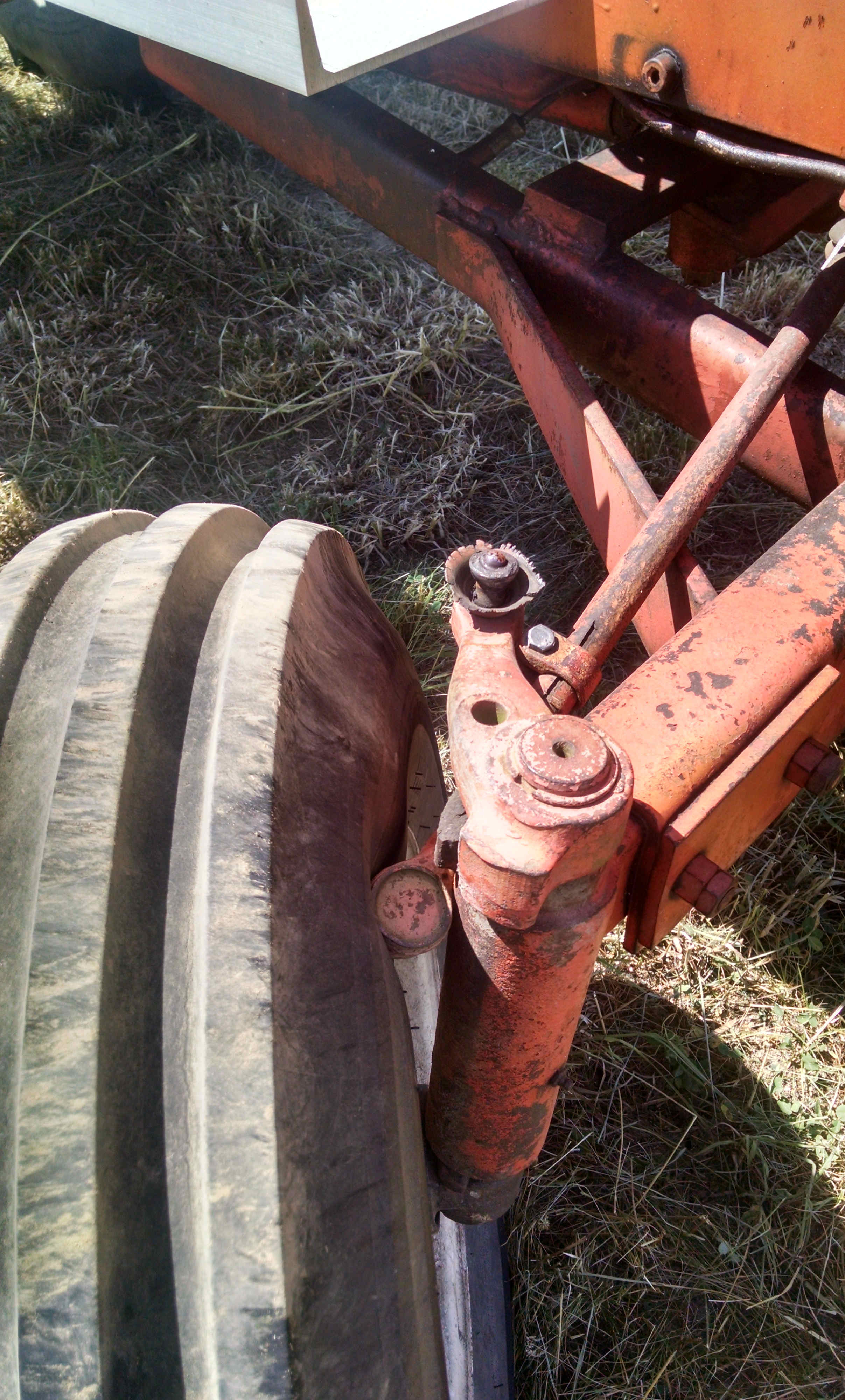

Tie tie rod broke over weekend and I am having trouble removing the stud from the the cast iron piece.  I have hit it with a small sledge but it isn't moving.  Soaked it with wd45 over night too.  Seems like the rubber protector is embedded into the hole but not sure?  I don't want to break the cast iron piece hammering on it.
I am also having trouble removing the male part from the female part.  It won't budge either.  I am kind of wondering if I shouldn't just replace the female part though while I am replacing the male.  It is probably worn out too.
Just asking if there are any tricks anyone knows about to make this happen?  My thought was to heat it up and that might burn the rubber boot that surrounds the stud?

Heat will help, don't think a fork will get under the remains to wedge it out of the hole, but might try it. ---Might try a puller and press from the bottom side to force it to loosen in the taper hole. If all else fails, I always went for the heat as last resort.

See if a fork can get under it or someway to put upward pressure on it..... a bottle jack?..... and then give the end of the cast iron a good rap with a heavy hammer. Should pop right out.

I always just take the nut off the tie rod and jack the tractor up...it'll pop loose sooner or later with that much weight on it. Never have broken a steering arm yet either. Those things are some hard stuff!   Rick

I hit it on the side of the arm towards the spindle. Hit it hard and it will come loose, did a 6060 and a 8010.

Remove nut,turn spindle so you can hit the tie rod end straight on with a BFH. Few good whacks will release taper. Otherwise you remove wheel and use BIG hammer on one side and whack it on the other with another big hammer.

I used a tie rod removal fork on mine. There is also a tie rod removal tool similar pitman arm remover.

Well, I used the jack method and used a hylift Jack on the bottom of the bolt. Got the wheel off of the ground. It did not release though. I let the jack down after about 3 minutes. Removed the jack and hit it twice from the bottom with a small sledge hammer. It came right out. The stud was bent to one side so might have made it stick. I see no easy way to get the male side separated from the female side. I have decided to buy female side since I can feel some slop. I paid $80 from agco for male side. Noticed that all states ag is selling both sides for $42. Going to pay $19 for female side plus shipping. Is the agco version worth another $45 for female side? It is still an inexpensive fix compared to most. If the extra $40 is worth it then maybe I should go that way. As always, appreciated everyone offering up the advice. I was attracted to the jack because hitting things with a hammer has screwed me a free times.

I've taken a few of these off and never broke anything using a hammer. Generally the tie rod has been together still and I have used a pry bar under the tie rod and a big hammer and usually one or two whacks does it. Pressure along with a couple of good whacks will do it. Pressure alone probably not.

The easiest and safest method is this: Loosen the nut on the stud several turns. Jack some force against it,just steady pressure, Then hold a 3 lb hammer against the steering arm solid on one side, hit the other with a hammer. It will come right out. The nut keeps it from hitting you in the head. Never had this to fail, the hammer lick temporarily eggs the hole to break it loose. HTH Tracy
