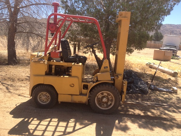

Hi, I bought a uleaded gas 4750 lbs lift tht  I beleive from online research is a 1971. It has one plate on the outside chasis /that says
TYPE G
173A
AU-1402
It sounds good when running but is blowing blue smoke
 it can be many things like head gasket on
i need to know engine and searchable part refernces like engne type etc
it also needs brakes
the front has no serail number plate
I am uploading the reference plate I have
the engine is stamped 4512  F
I would lso like to try and get a manual
I internet searched the au-1402 and two things came up
one this was taken over from lstansteel corp in 1971 (Collection 1402) to allis collection 54
and that some of these models have sold at auction refeenced au-1402 about 3
Thats all I know, can anyone help me shed some light on this model including engine type or what to look for / similiar models for part etc?
Any help is apreciated,
Jeff

Several photos of the machine and engine might help. If your photos are large (high pixels), resize to about 680 x 500 with paint or other program for best viewing here.

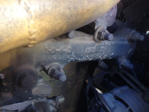

 I took a few pictures and can see an engine stamp of 1-3-4-2 then 2-5-4

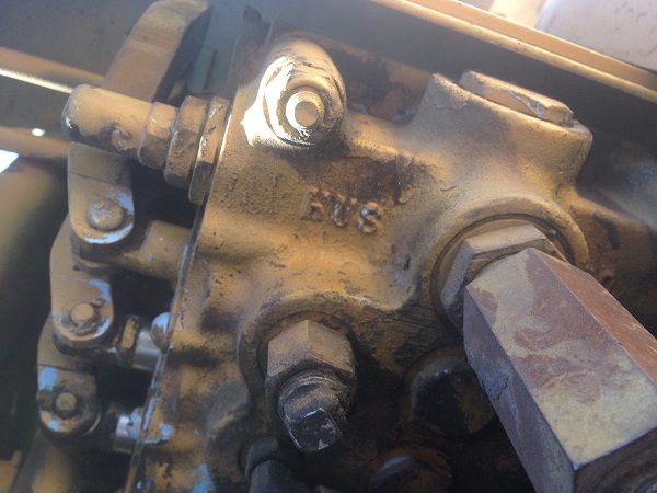

also another part of the engine is stamped HUS
I am attachg the pictures resized as suggested.
I am gettng a lot of blue smoke like I mentioned and was told by seller he thought a thicker oil is needed, Im not sure but can use help on identification of this engine and hopefully a way to order a manual
I can hardly stop s brakes will be my first order of operations hopefully.
I hope some of these pictures means something to some one it seems the 1-3-4-2 relates to engine firing

I believe HUS is Hussco, a valve supplier.  THere should be a data tag, somewhere on the lift, similar to the last picture, with model, s#, and load capacity, etc...Wink

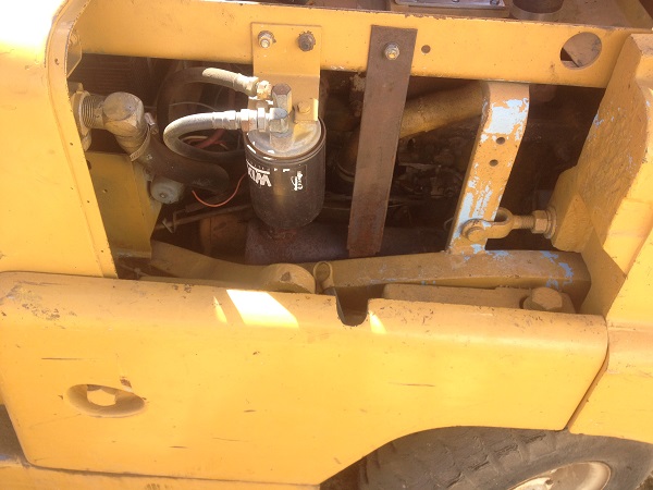

Looking at a few clues and the size of the forklift leads me to think you have a 153 Buda engine. Pictures of the engine don't tell me much. Not sure about the angled oil filter.

1-3-4-2 is the engine firing order. That maybe an Allis G153 (Buda 4B-53) engine.
As DiyDave posted HUS would be for Hussco, a company that manufactured that valve. The valve is part of the hydraulic system not the engine.

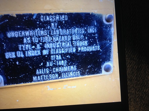

The tag you posted is an Underwriters tag as to the machine's fire rating. I don't see that that will be much help in ID'ing the forklift.

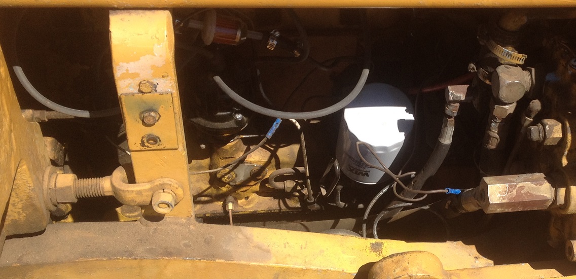

Would you be able to get some more photos of the engine? Get a lower angle and a bit further back to show better side views. Better lighting will help as well. Also a couple good shots of the valve cover and water pump may help.
