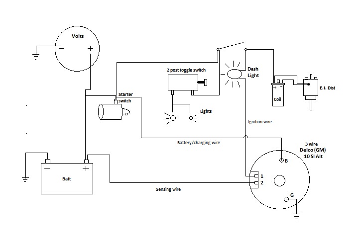

Here is the diagram from my WD conversion if it helps. I prefer the 3 wire alt on a tractor, charges at a much lower RPM. Sioux Falls is nice but growing fast and crime/drugs are starting to creep up a bit, Harrisburg or Brandon would be best areas to live.

Ok, Here is my crude sketch of the system I propose to use next. May not be big enough to read?
The parts and dash reconfigured:
Don is a great resource on these gems. I think you were calling him when he and I were talking tractors!

Thanks to all, the wiring is done BUT I haven't started the tractor yet. A few ignition checks yet to make, and besides the old battery isn't holding a charge. But at least when I hooked up the battery yesterday and turned the key to ACC, the LIGHTS WORK!!! First time! And the voltmeter, too. Not enough juice to crank it over, though. I didn't want to take a battery out of another tractor either. Just as well, I wasn't ready. And the last thing I have on the list before she's (hopefully) ready to work again is adjust and repack the front wheel bearings.
