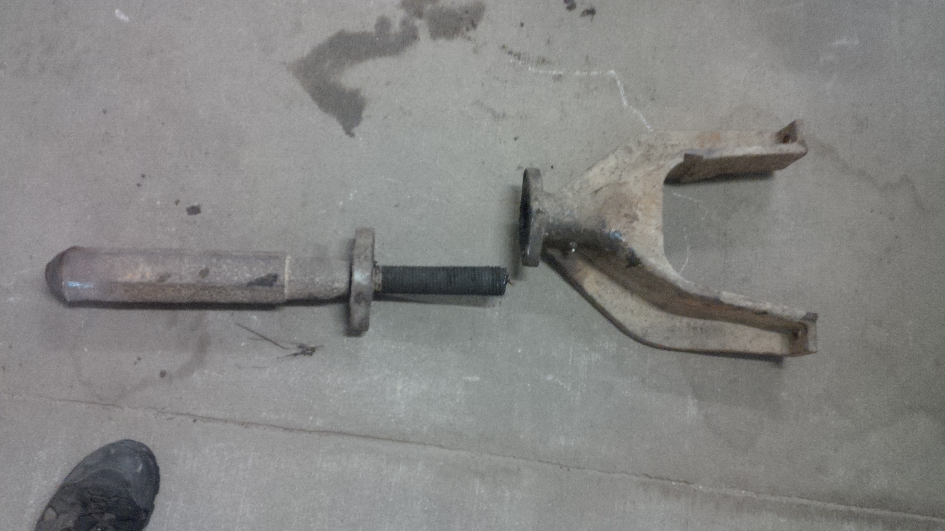

Good afternoon- The yoke on the Track release adjuster is stripped. Can anyone give me some advice on how I can repair the yoke or does anyone know where I can get another Yoke.  Any help would be greatly appreciated

that yoke would be pretty easy to come by from a salvage machine.  general gear in Idaho www.tractorparts.com has a good selection but there is likely something closer to you.  hopefully someone else will chime in.
you could have it fixed at a machine shop but may cost more than a salvage one, but with freight who knows?

Thanks, So far I haven't found anything around me. I called General Gear in Idaho, they said they'll need to do some looking.  Thanks again for the tip.

You could just use on more nut on the adjusting screw and adjusted the trak with the first nut and lock the second one on the first nut ,some guys do that

Thanks Gemdozer- I found a couple of yokes $250 and $275 plus shipping.  I'll probably buy one but I'm going to look for a couple of 1.5 inch nuts and try your suggestion to get me going again asap.

Another approach would be to thread the yoke, to the next size up, and weld a piece of that sized all-thread, to the back half...Wink

As long as that lock plate is there and is threaded yet - a single nut is all that is needed and use the plate as the locknut - just use longer bolt to attach to the yoke .
 On a HD5B I had I turned a new threaded shaft for the yoke and then used a piece of square tube to make up the section to use adjusting wrench on - welded threaded to square tube and done
