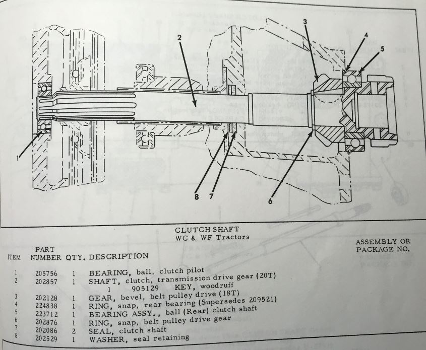

Getting oil in my bellhousing and clutch. Can I change seal by pulling engine or does transmission need to come out?
Also, anyone have an AGCO p# or even a national p# for it and a parts breakdown pic?
Thanks, Larry

check your oil level, it's nothing but a felt washer behind a retainer

Post Options Post Options   Thanks (0) Thanks(0)   Quote chaskaduo Quote  Post ReplyReply Direct Link To This Post Posted: 03 Jun 2019 at 4:19pm

Post Options Post Options   Thanks (0) Thanks(0)   Quote Larry(OH) Quote  Post ReplyReply Direct Link To This Post Posted: 04 Jun 2019 at 5:27am
Thanks.  That is what i needed to see
