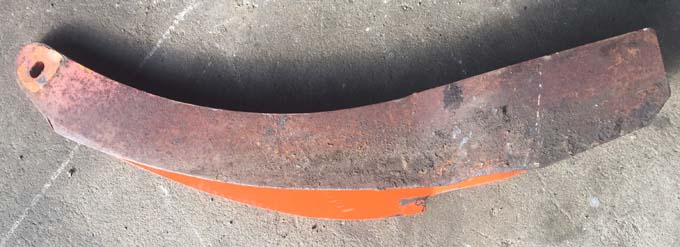

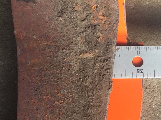

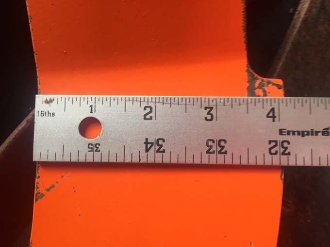

I got the new runners today and compared them to the old ones.
I sat the old runner on top of the new one.
About an inch wear.
New ones are about 4" wide.
Thanks & God Bless
Dennis

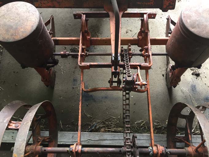

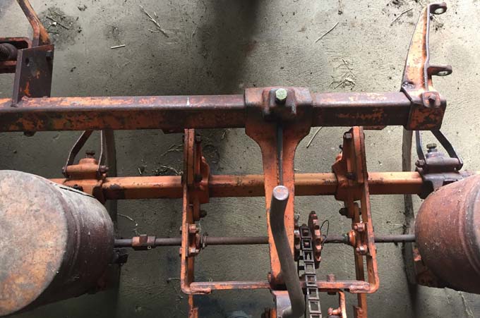

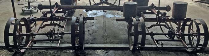

Post Options Post Options   Thanks (0) Thanks(0)   Quote rog 190xt x 3=? Quote  Post ReplyReply Direct Link To This Post Posted: 06 Jun 2019 at 12:34pm

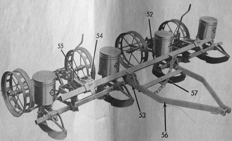

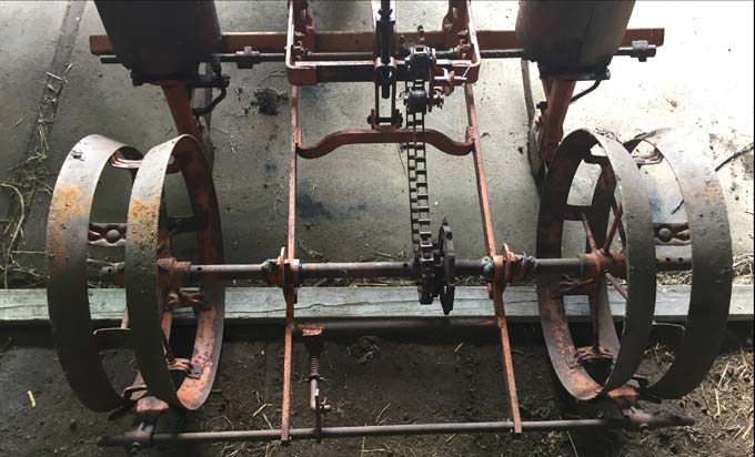

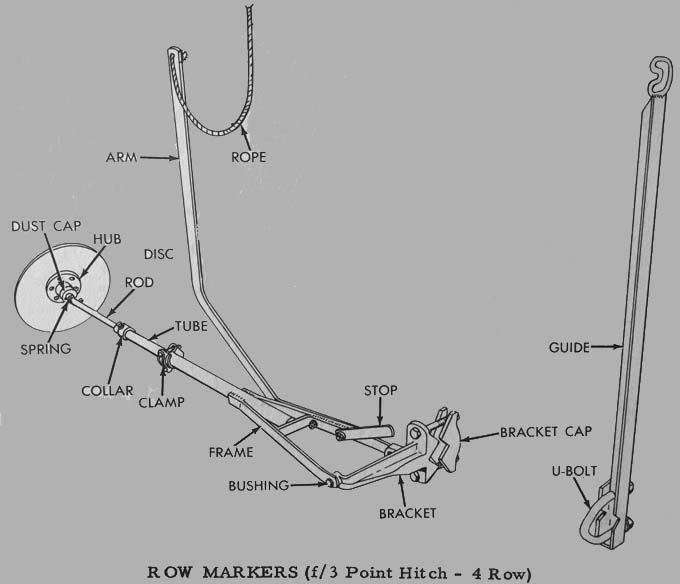

Yep its the same thing as the one in the picture . If you could take a couple more pictures of it and post that would be awesome . if you could stand behind it and take a picture of the whole planter and one of where the row units mount to the frame of the planter and one of where the wheel slide on the shaft . That would be great if you could do that . Thanks Much Roger
DennisA (IL) View Drop Down
Location: Ridott IL.
Points: 2077
Post Options Post Options   Thanks (0) Thanks(0)   Quote DennisA (IL) Quote  Post ReplyReply Direct Link To This Post Posted: 06 Jun 2019 at 6:06pm
Hope this is what you are looking for.
Thanks & God Bless
Dennis

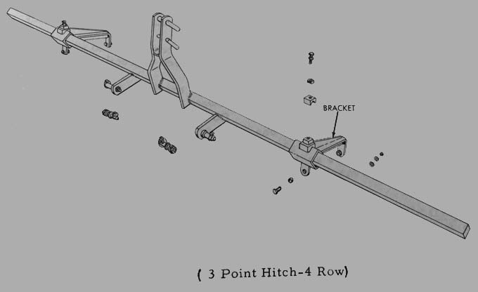

Points: 2077

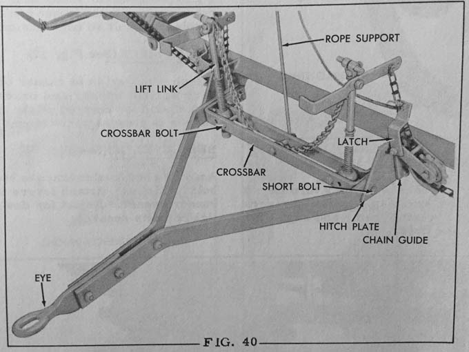

Post Options Post Options   Thanks (0) Thanks(0)   Quote DennisA (IL) Quote  Post ReplyReply Direct Link To This Post Posted: 06 Jun 2019 at 7:54pm

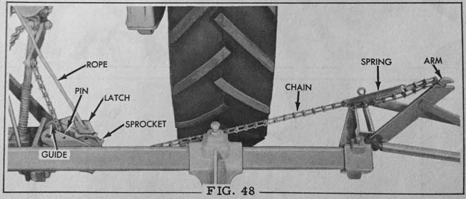

You may want to look at this as well.
Thanks & God Bless
Dennis

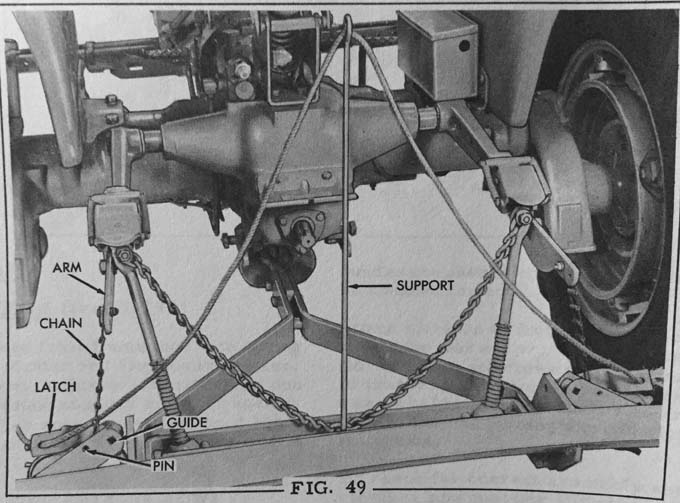

Post Options Post Options   Thanks (0) Thanks(0)   Quote rog 190xt x 3=? Quote  Post ReplyReply Direct Link To This Post Posted: 06 Jun 2019 at 10:35pm
Thank you very much for the pictures and the 3pt lay out. It doesn't by chance show how they set up the pick up chains for the makers with a 3 pt hitch . I didn't know.How much it could be adjusted in . It would make a very nice 3pt bean planter even if it was a 6 row . But thank you very much . I got a 4 row that was Dads and a 2row that he got on auction . But I hate to cut it up . But thanks much Roger
Points: 2077
Post Options Post Options   Thanks (0) Thanks(0)   Quote DennisA (IL) Quote  Post ReplyReply Direct Link To This Post Posted: 07 Jun 2019 at 9:51am
With this picture I've posted all the info about the 3 point that's in the manual I have. It does not show any chains for the marker lift.
Thanks & God Bless
Dennis
rog 190xt x 3=? View Drop Down
Joined: 22 Jul 2012
Location: Grantsburg Wi.
Points: 27
Post Options Post Options   Thanks (0) Thanks(0)   Quote rog 190xt x 3=? Quote  Post ReplyReply Direct Link To This Post Posted: 07 Jun 2019 at 11:22am

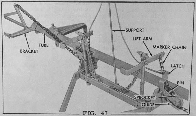

Thanks Dennis .on the snap coupler style there was a chain that hooked to arm to lift the marker . But the photos you sent me are great thank you very much . That gives me all kinds of ideas
Thanks Roger
Points: 2077
Post Options Post Options   Thanks (0) Thanks(0)   Quote DennisA (IL) Quote  Post ReplyReply Direct Link To This Post Posted: 07 Jun 2019 at 5:08pm

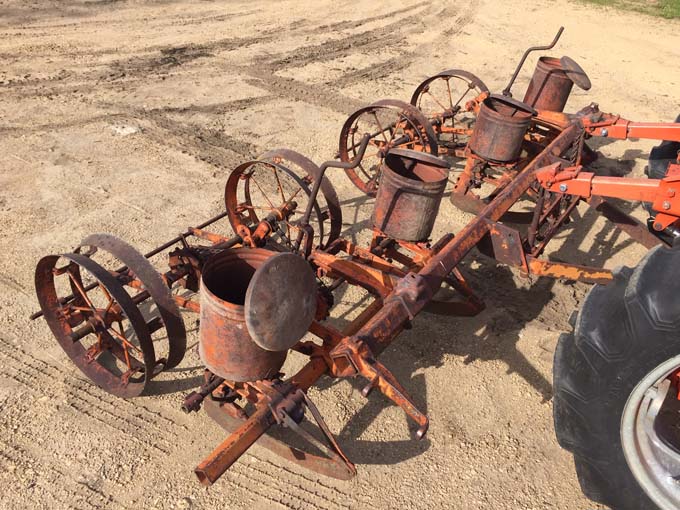

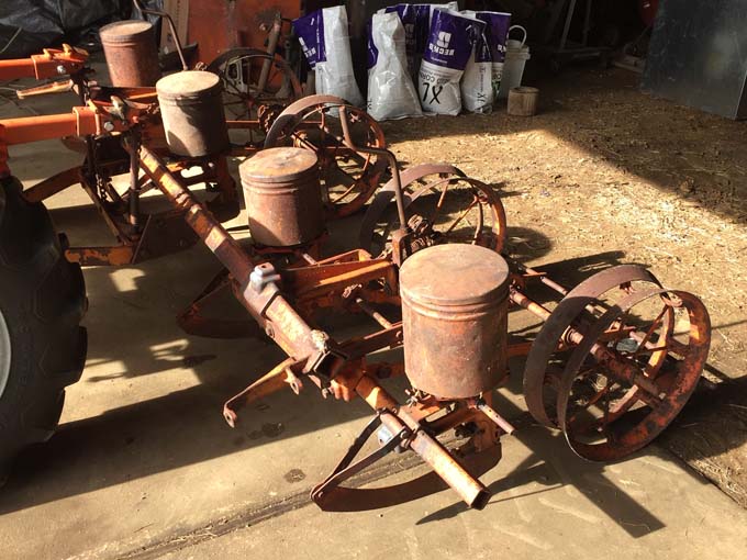

Sorry Roger, I was thinking you want pictures of the 3 point marker lift system. Here are a few good pictures of the snap-coupler marker lift system. I had to get some #32 flat chain for the marker lift and boy was that pricey. I guess flat chain is not very popular today. No one has it in stock.
Thanks & God Bless
Dennis
Joined: 22 Jul 2012
Points: 27
Post Options Post Options   Thanks (0) Thanks(0)   Quote rog 190xt x 3=? Quote  Post ReplyReply Direct Link To This Post Posted: 08 Jun 2019 at 1:26pm
Thanks Dennis All the pictures were great . The shots of the markers were great I was trying to figure out how they did it on the 3pt now I see it. I know that lift chain is hard to find . I used this planter years ago . And I want put some thing together to use on my 190 . I know with enough parts I can make something work . I got to find that book . I'm sure my dad had a book for it . I need to see what the back of the shoe looks like where the tubes from the fertilizer boxes hooked up . It must be a side dress planter . I know you can change the rate by changing the chain on the gears . If its a side dress it would use a lot less fertilizer then the other style planters that puts it away from the row . Anyway this is a project too work on. I got a 6 row 400 cyclo planter . But I got to get out and hit it . Thank you for all your time posting the photos . Roger in Grantsburg Wisconsin
